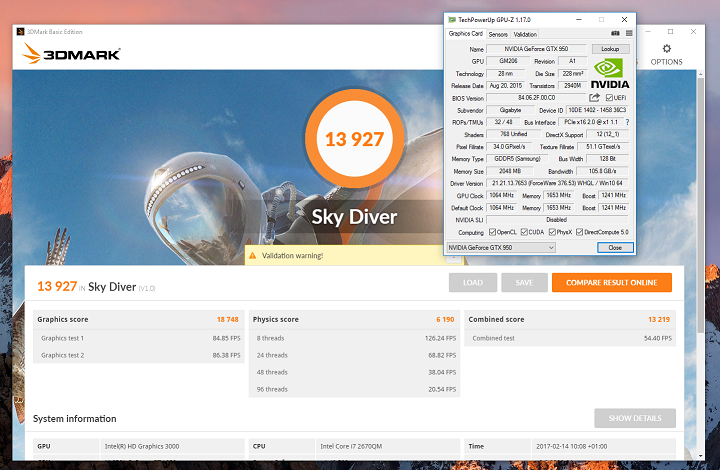

from setup 1.3 i can see my TOLUD size is 2.7. but because of my curiosity, i tried to overide my DSDT to see large memory input in device manager. Therefore, i can do 56gb compaction
setup 1.3: PCI compaction at 56gb. (as in setup 1.3 help, it's number #1) pcie port: gen 2 speed.

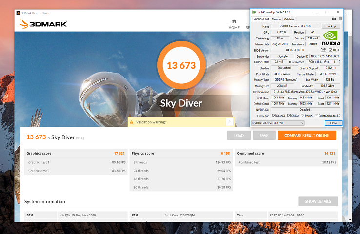

i dont know if i can increase the performance more, in 3dmark bench mark i got around 11000 in skydiver and around 4400 in firestrike.

- i Found the EXP GDC is not stable if we using another usb especially  USB wifi dongle. I read a thread here that suggest to use powered USB Hub. now i never found hang/BSOD anymore guys.
- i see significant increase of performance when i use external monitor. in skydiver 3dmark it increase to 14.500 from 12.400

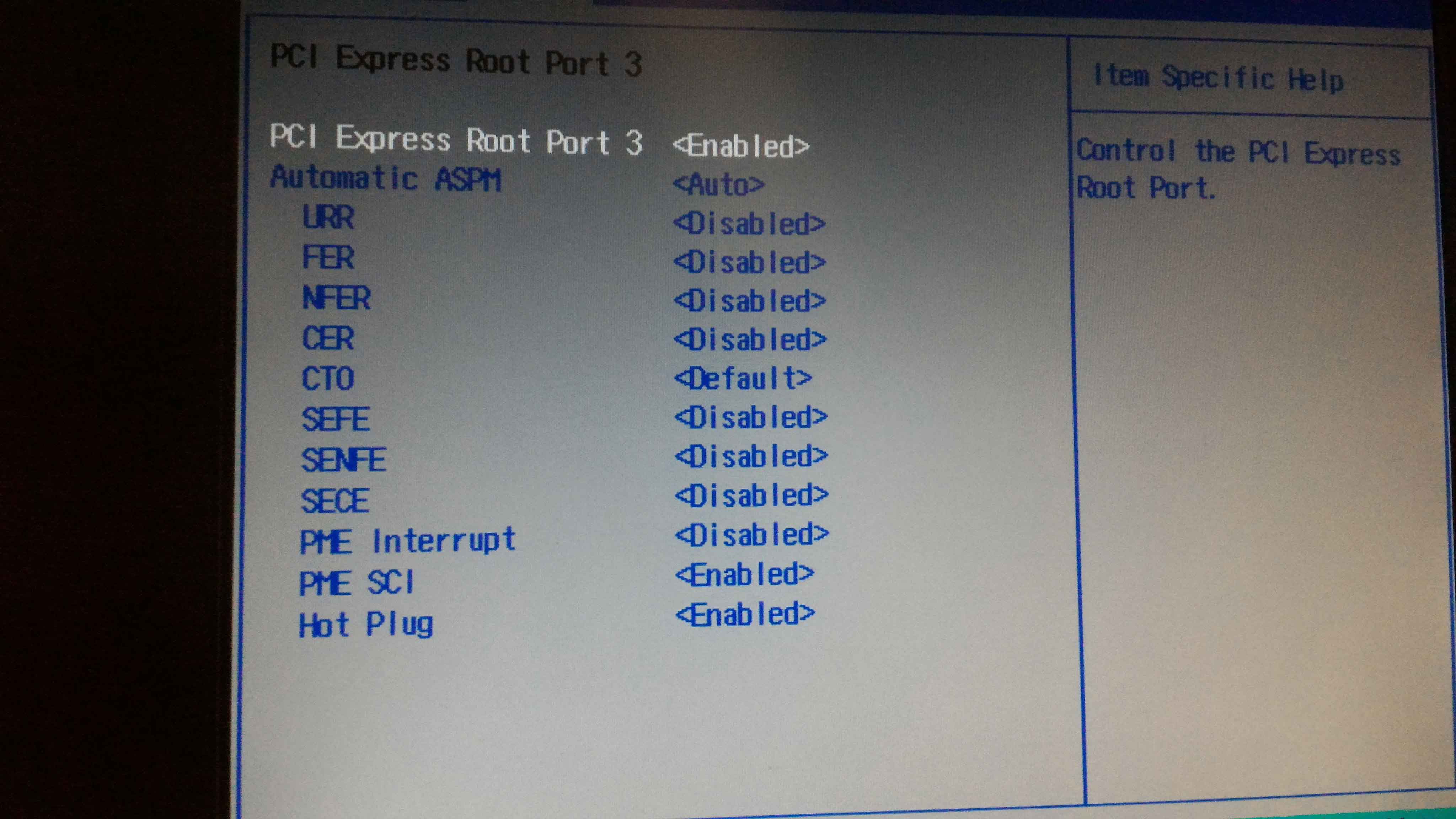

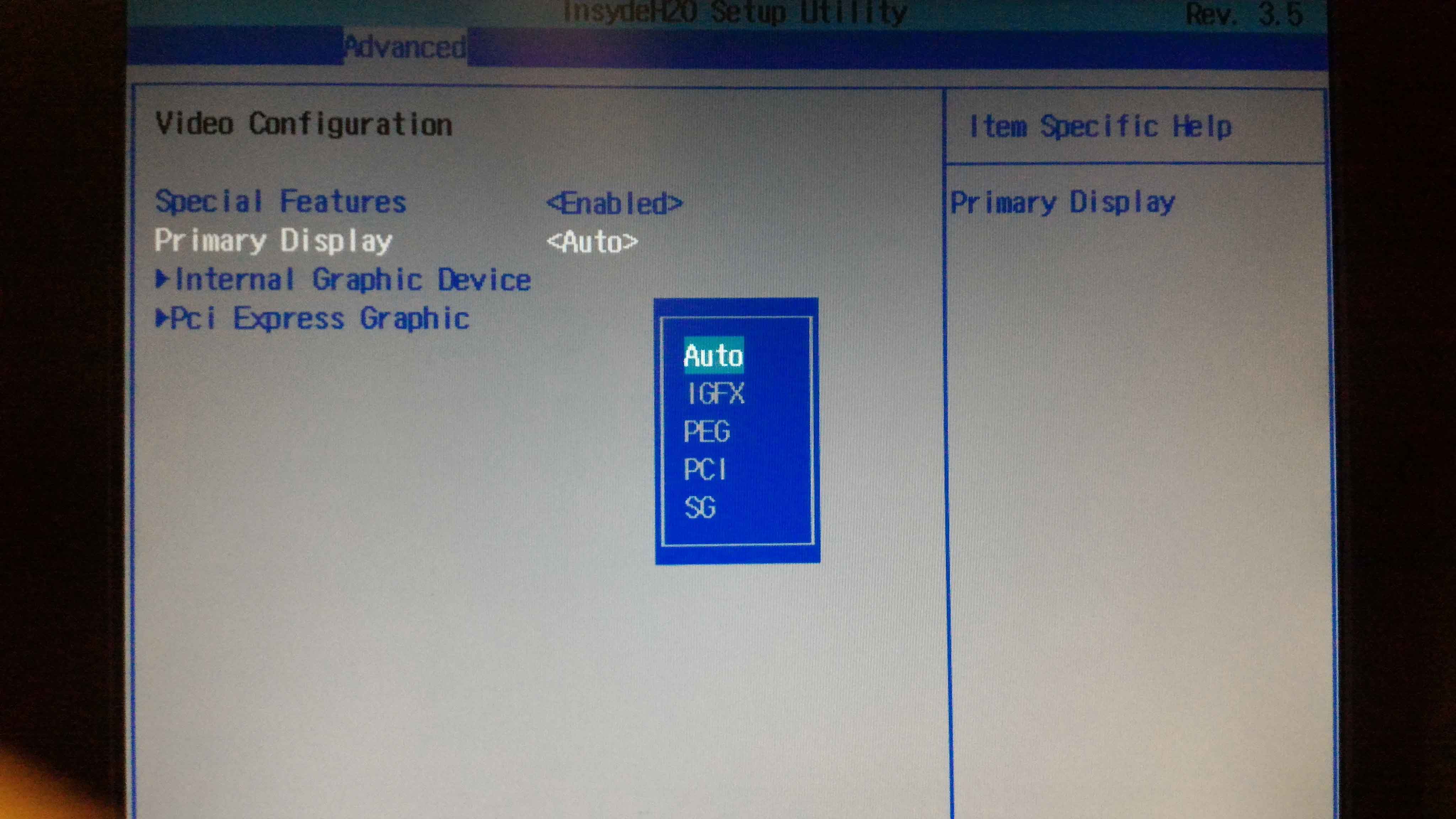

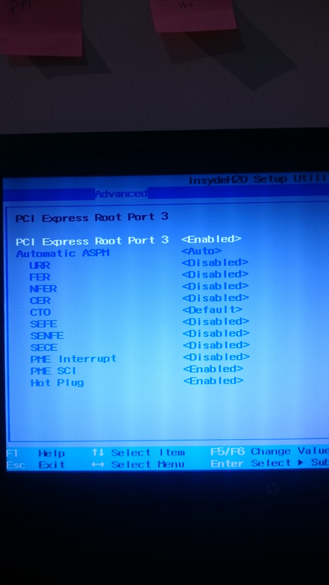

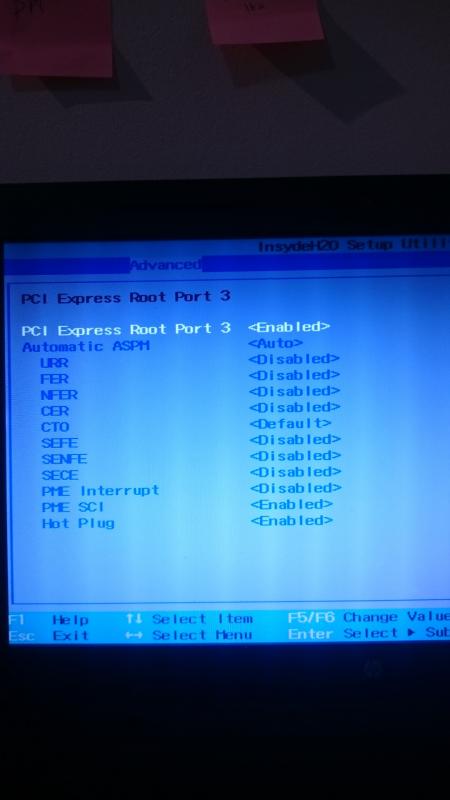

in bios, i just changed the pcie setting to enable hotplug. no other settings are changed.

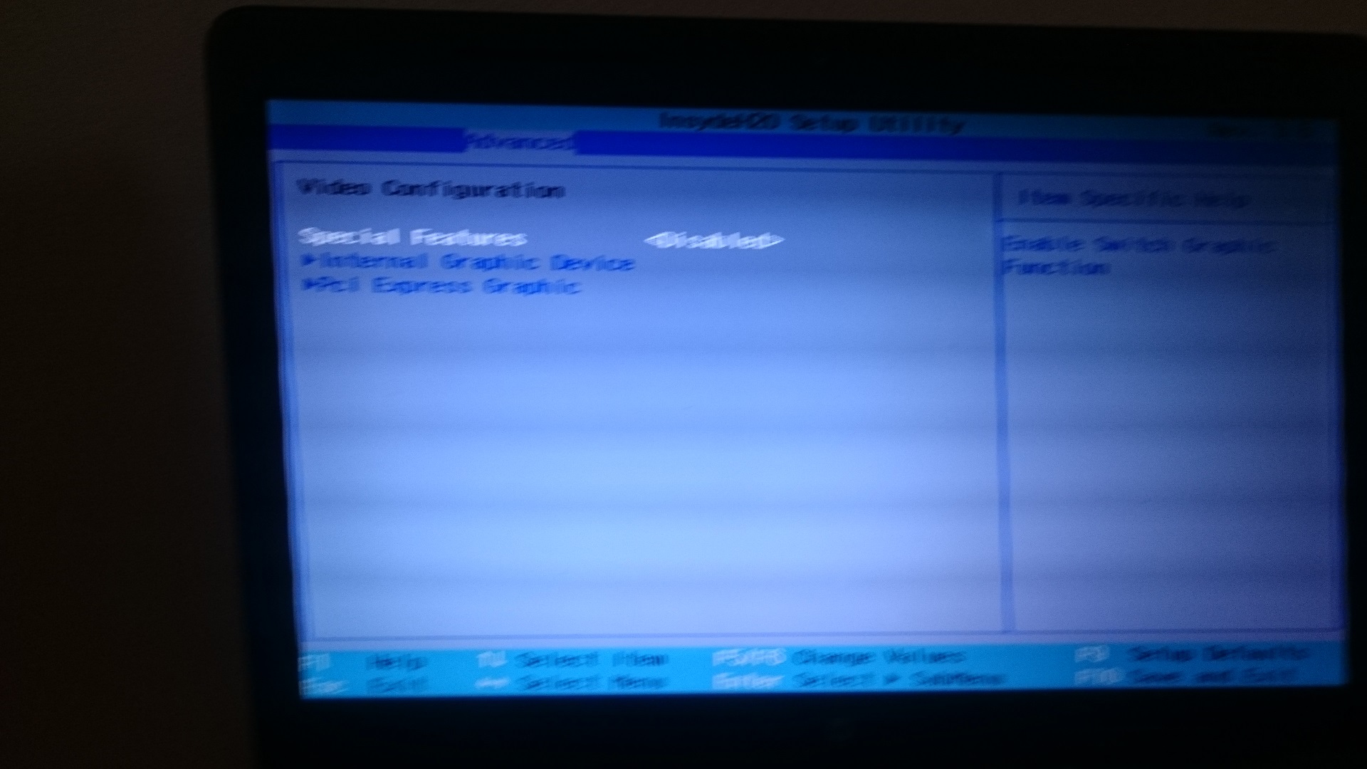

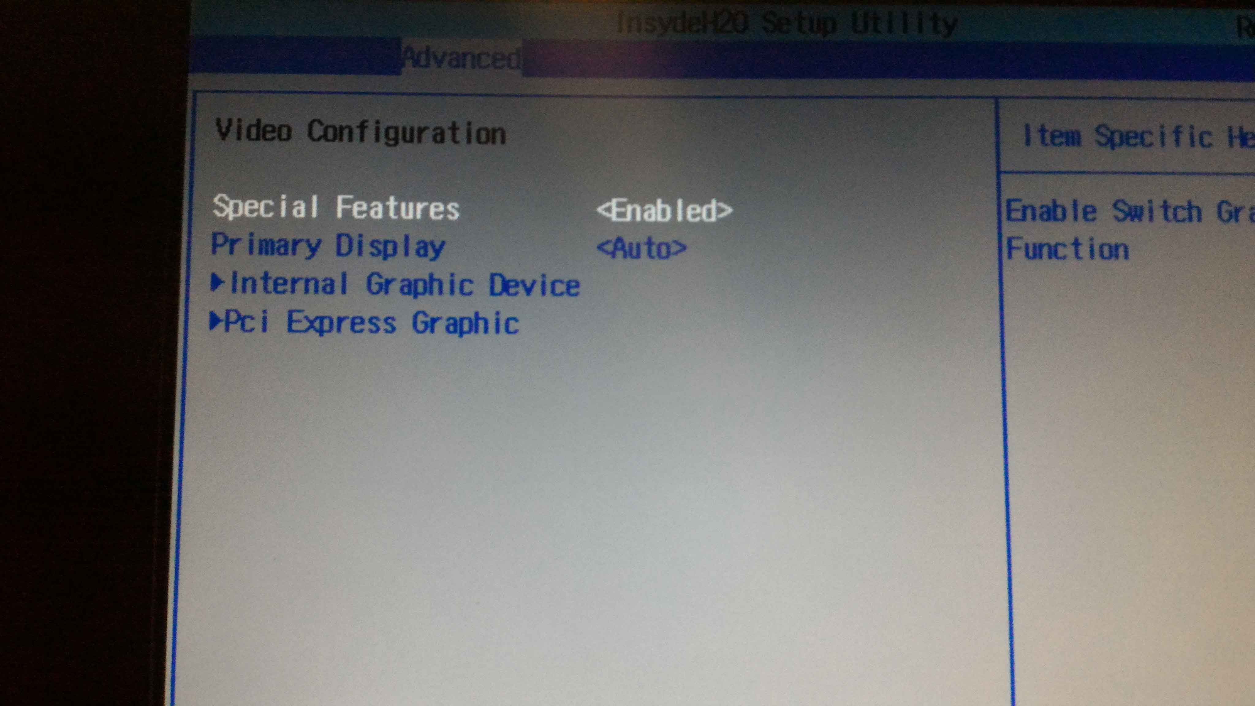

I conduct my bios experiment. I change video configuration> enable special feature> there are igfx,peg,pci.
When I change to igfx, I can use internal and external graphics (extend screen monitor+internal display), but my egpu (checked in GPUz) is not able to use cuda and opencl. There are no check marks.
The case is different if I put pci on bios menu. I use egpu with monitor and work fine.
Sometimes I got trouble with setup 1.3, blankscreen after test chainloader. I use win 7. Would you like to send me some pictures about your hp430 notebook?
Sent from my ASUS_Z00AD using Tapatalk

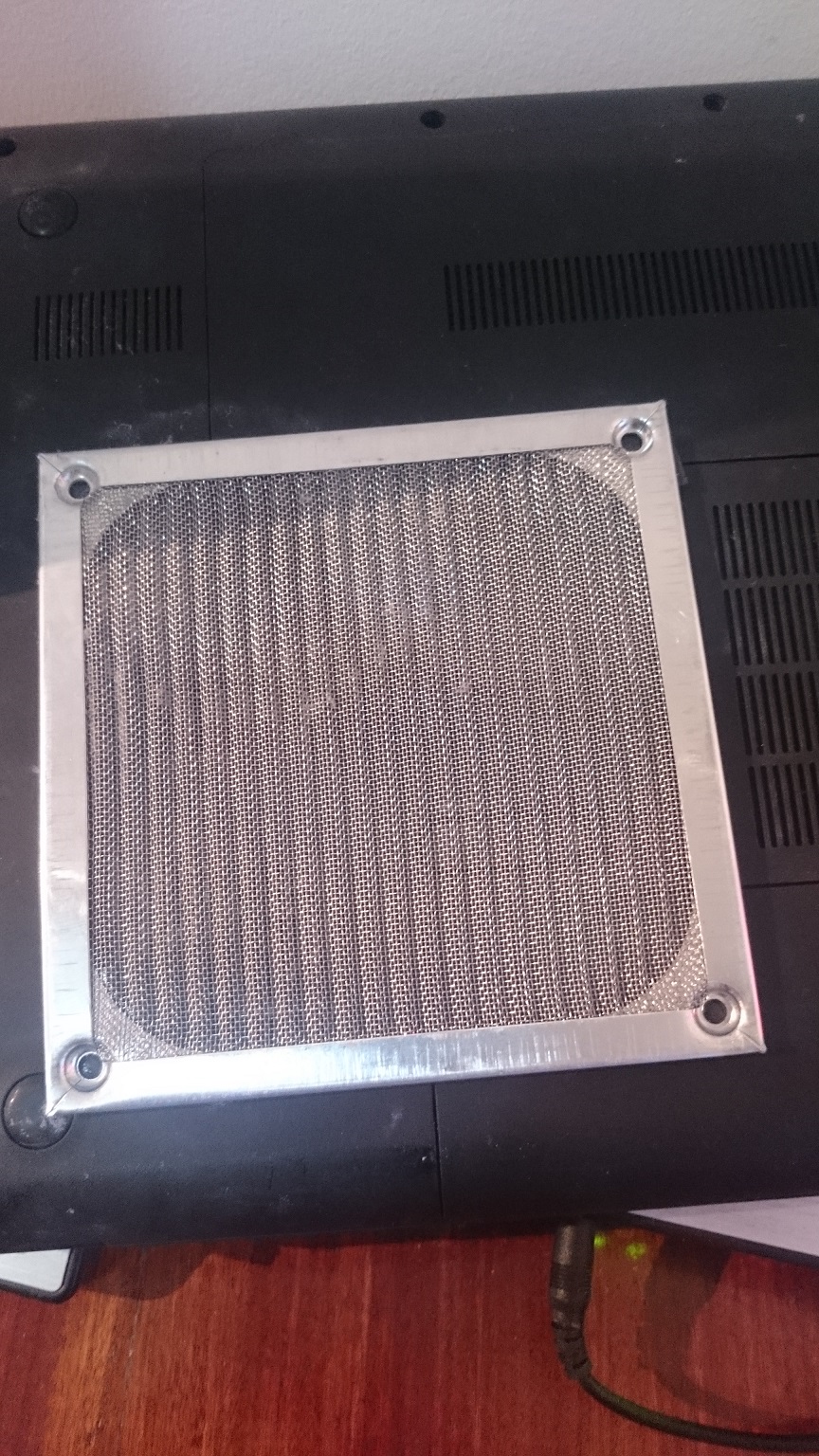

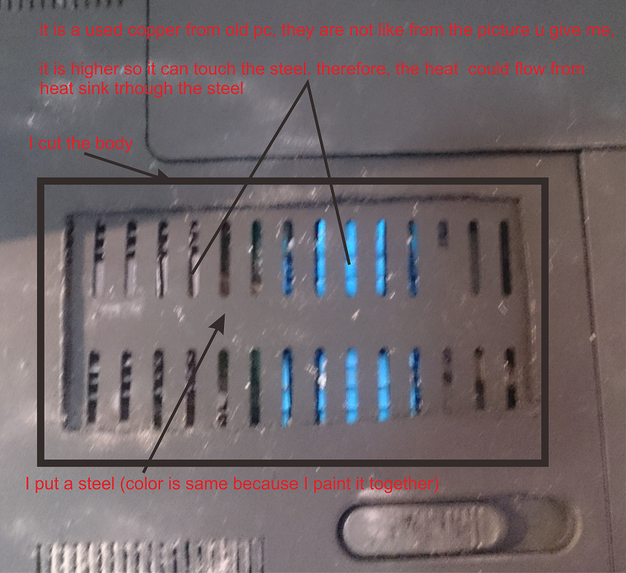

I think most of HP 430 owner suffer the heat problem LOL, so I customized the heatsink long before cpu upgrade or this egpu project. i make a hole beneath the cpu (on bottom plastic body) and cover it with steel plate with small holes, and connect the main heat sink to this plate with used copper heatsink so the heat can flows from the heatsink to outside. I also put a dust cover under the plate to avoid dust come to the heatsink. with this tweak, i notice considerable decrease of temperature.

Wow.. Amazing. You have done reduce the heat problem before conducting egpu project. I should follow you. That's good idea to make notebook cooler than before. May ask you again? I curious about inside of your notebook. The hole look bigger and allow air flow better, but what is the blue? below the hole should fan, so you put heatsink below hole? I hope you give me reference to custom my notebook too. I plan to upgrade cpu same as you and my ram.

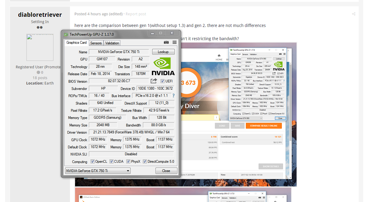

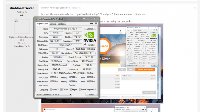

4 hours ago, diabloretriever said:
here are the comparison between gen 1(without setup 1.3) and gen 2. there are not much differences
I saw you sre using vga from your gpu to your monitor, isn't it restricting the bandwith?
Please check the graphics score. Like I said before although there is no significant performance the FPS will drop fastly if you play game. Yeah that's not big problem, We still play game so well, right?

Oh I remember. Let me ask you again. When Using internal display like your screenshoot in windows 10, the external display and internal display work as extended monitor. So you active Intel hd 3000?

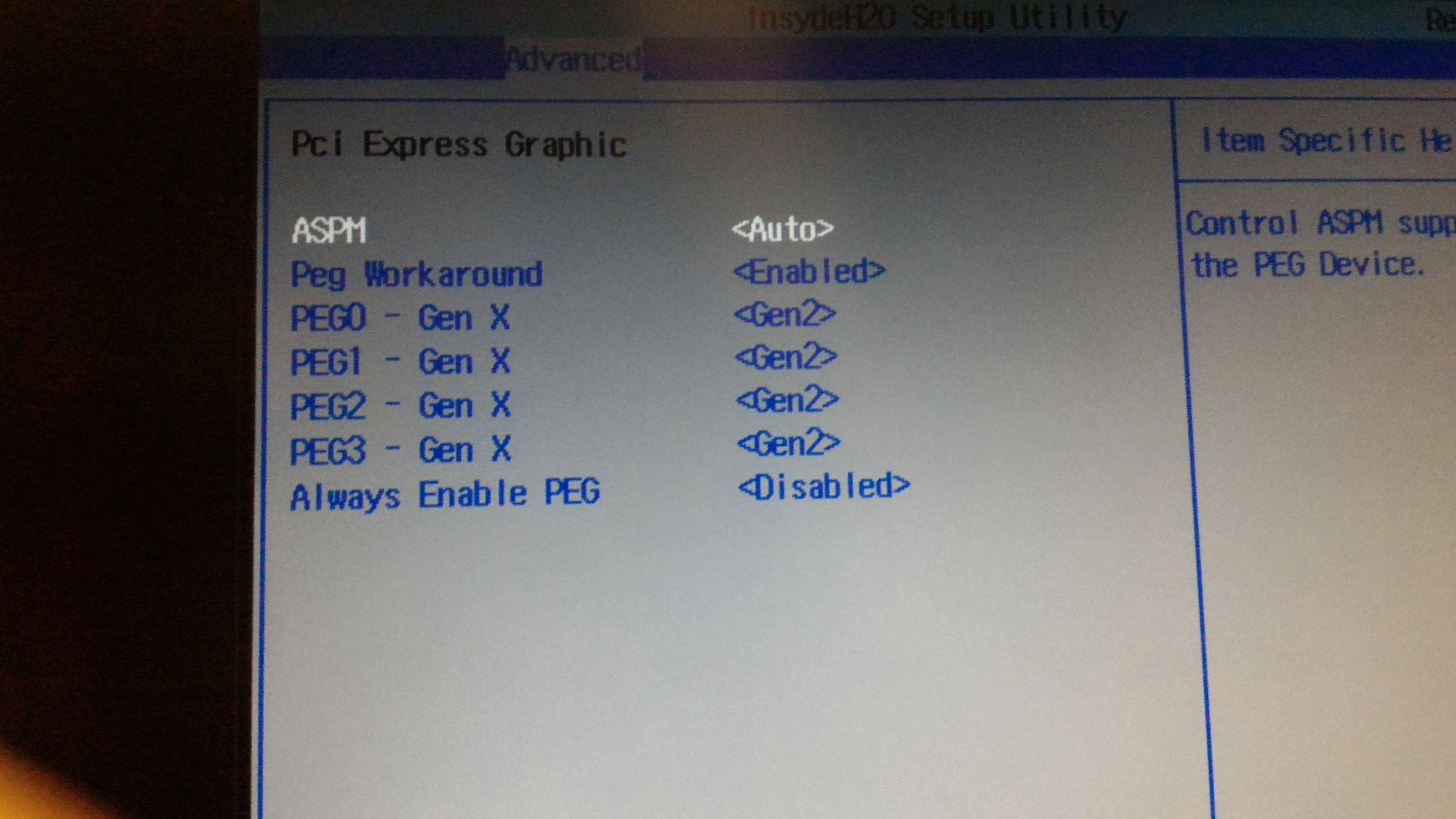

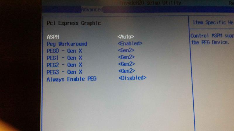

Here is my bios setting. I If I choose Auto on primary display  (video configuration), I can use my egpu on external video only 100%.
I can use internal and external display (failed to use optimus) if I choose IGFX. I hope you send me your bios configuration like this. I will be waiting for you to do that. Thank you

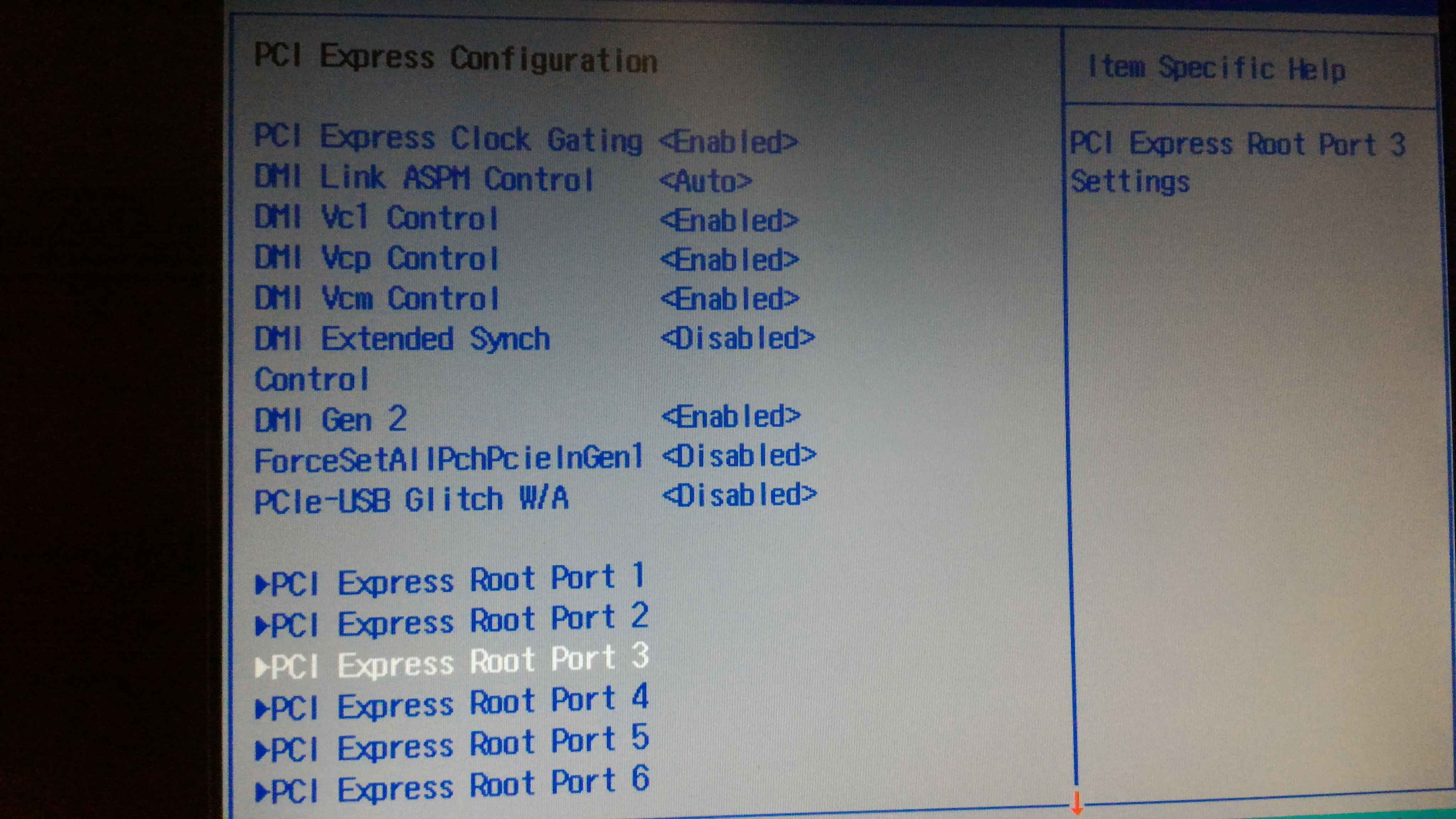

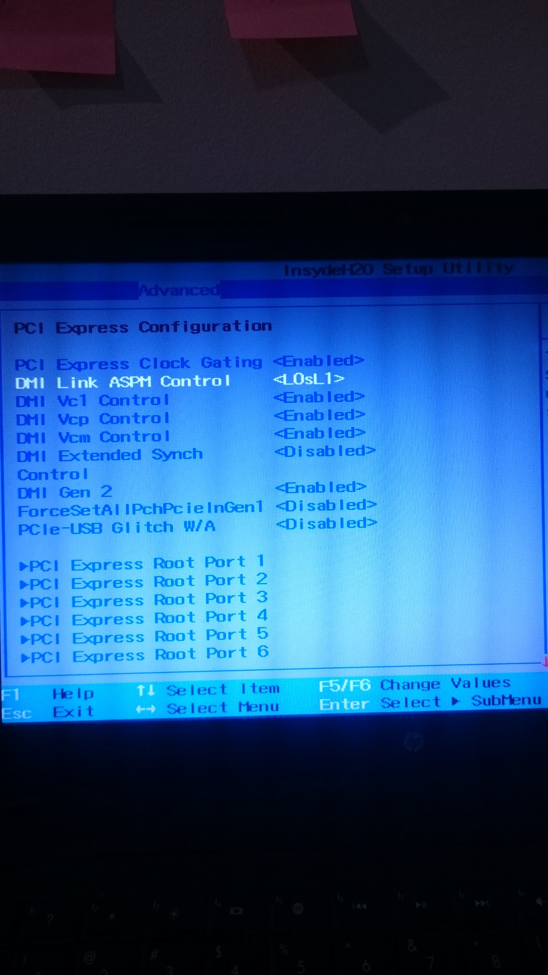

Here is my PCIE configuration. Without Setup 1x I can use Gen2 because the bios provide this configuration. Please check it

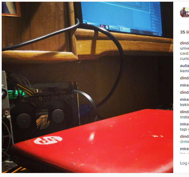

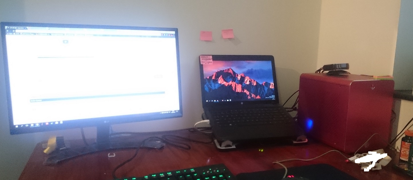

This is my Egpu
yes because previously i am used to playing games on this laptop and it  became hot too fast. I will share you the images but maybe at the weekend so i can disassemble my laptop to show the  heatshink scheme.

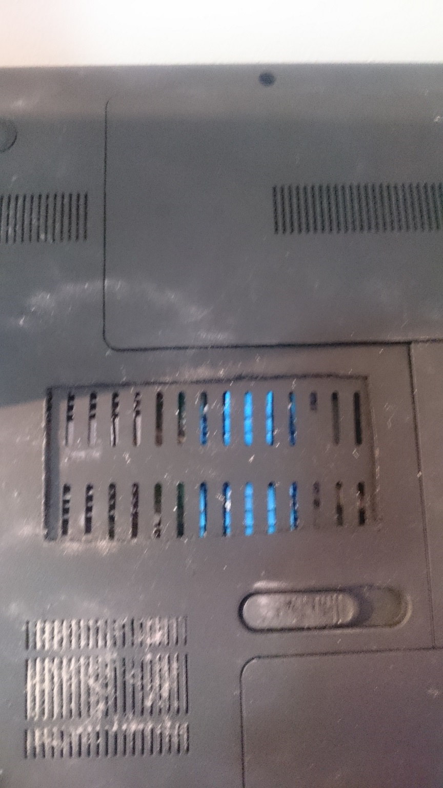

i cut the body near the mpcie port so the pcie cable could sit perfectly. i am using powered hub since i use many usb: fan, keyboard(need two usb), mouse, bluetooth dongle.
Have you done to make comparison with your gpu run in PC than in your notebook. I've heard that we lost many FPS game because of limited bandwith that we use on notebook.
i think the best way to benchmark your laptop/pc performance is to use benchmarking software beacuse it simulates the game with many feature: you can see fps, usage etc like u are playing game but better because it is standardized. http://www.makeuseof.com/tag/benchmark-cpu-gpu-like-pro/

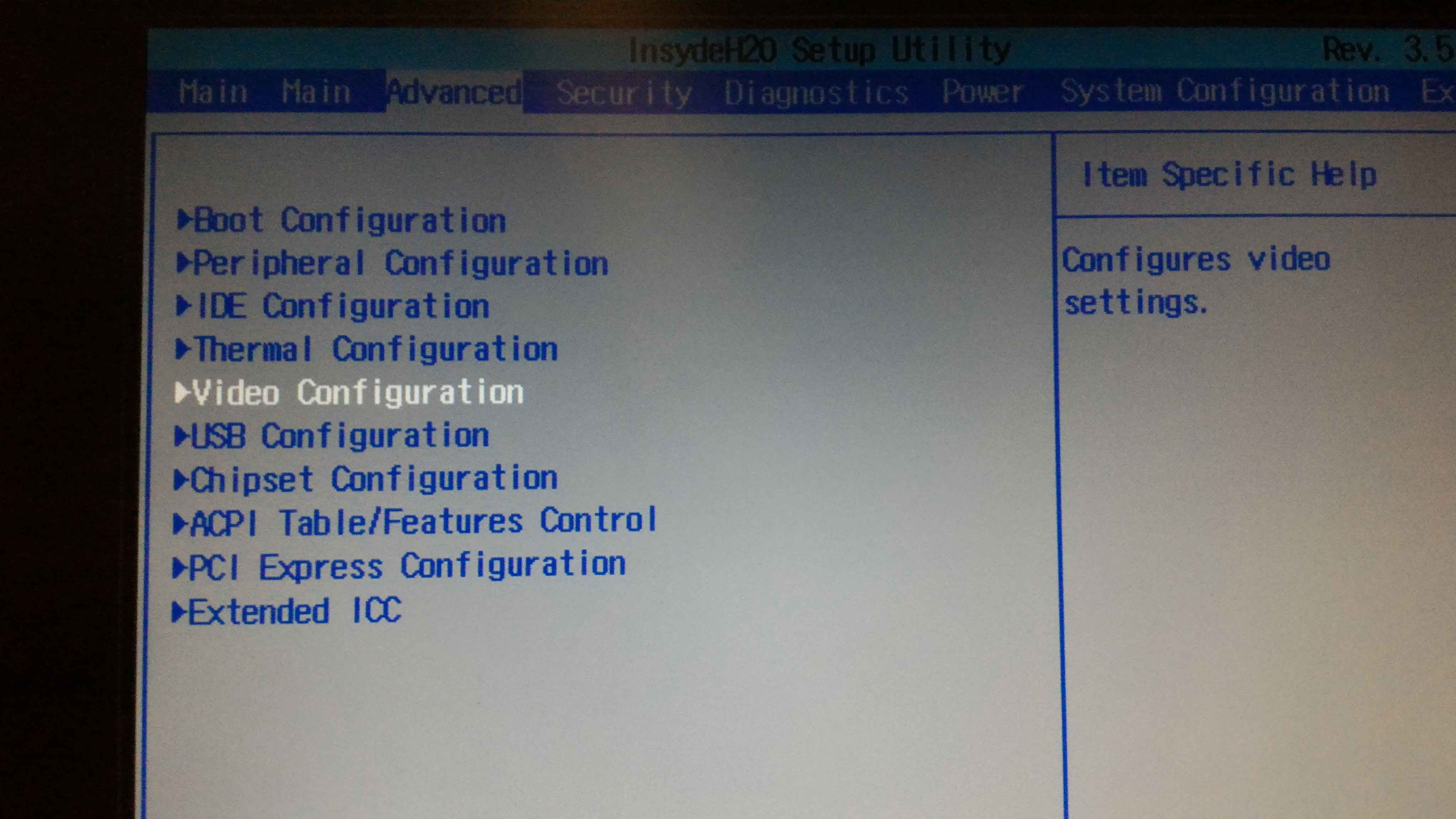

i have checked the bios and surprisingly it have not been activating  until now. lol. so the special feature is off.
woooooowww thankss. it is really help. i will activate it. below is the image of my bios screenshoot of pcie port. as you can see, all the configurations are same.
here my score using gen 2 activated and primary display: auto
i tried it twice and it is shown similar results: the first one is around 14.000 and the second one is around 13800. it might be concluded that my result is same (before turning special feature on). I dont know why, maybe it is because the laptop somehow activating the nvdia as primary display when it is detected
Oh I see. You want to permanent place your mpcie cable just like PC which is staying in one place. But unfortunately, I use my laptop to keep mobility, sometimes I put my wificard to get internet access in public area. Hehehe.. it is still free, I should use the facility as well. All I need to do just isolate the cable to keep movement. That's good idea. Powered USB can handle all your device, I should try it.

Oh the graphics card recognize as two monitor. So you can expand the monitor. My question is can you play game on internal display with your nvidia card? I affraid of internal display just use intel HD 3000 only, the nvidia just use external monitor. i want to clarify it.
Yup, you're welcome. The bios is providing all we need to use egpu. But we must carefull to change the configuration. Hey, I found the core cpu. You can use 2 core or 4 core, there are optional configuration.
Oh you conduct experiment again. I just wonder to see your result. There is no significant performance like you said before. I think your configuration is enable IGFX. Yeah we can avoid of using setup 1.3 by setting the bios.

Yep, maybe i will order thermal paste first because the old one already finished. I just play pro evolution soccer and dota2 only when i have not implemented egpu yet.
oh i got it. i transform my laptop now to a pc.

5 hours ago, druna27 said:
copper shims or thermal pad. Have you ever heard about it? I guest that you mount it on the processor, right?
similar to this but it is different. i used copper from another pc.

yes, before i bought a monitor, i used my internal screen and optimus is enabled.
So, you never configure your bios to get internal dispaly work. Mmm.. I just wonder, I can not do that. Before bought egpu, I thought that windows 7, the older, can run optimus as well as all people do it. The fact is I got external display. I confused and tried DSDT overide. Yeah I can do it, but I failed to use my wifi card again. So I make clean instal windows 7 and no DSDT override by changing bios (primary dispaly>external monitor). What is your version of your windows? I should try your OS to make comparison.
On 2/17/2017 at 5:22 AM, diabloretriever said:
i set it to auto so the bios could set it automatically to peg when it is detected. i can do another experiment for you if you would. what do you it would be the best? i could try it for you
and, what is your best setting, i would compare it
Hey, when I set it to auto, I can not use internl display. If you want to use internal display just choose IGFX. Oh thank you. I never setting my bios again since I found that my egpu work fine in my notebook. Nice.. IMaybe I will try again later.
On 2/17/2017 at 5:34 AM, diabloretriever said:
yes i ever considered to use thermal pad, but it is to low so it cant touch the modified steel. so think it would be useless.
After I realize that you are able to use custom heatsink, actually I curious to know about your heatsink. I watch youtube and someones use doubled thermal shims on the processor. They report that decreasing 20 degree C. I think your custom heatsink same as them. yeah, I'm wrong. How about your promise? It is weekend, right?
Would you like to send me size of your old copper from internet? I want to know the dimention of the copper. You can give me another references such as heatsink from intel pentium or what else. Your suggestion is important for me. Thank you mate
