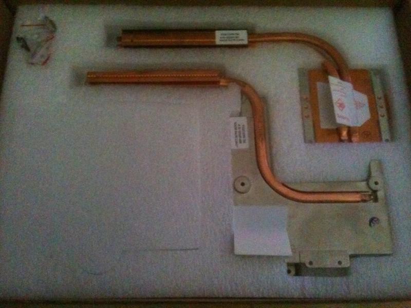

Hello, which heatsink is best for P150SM-A with gtx980m? I See P150SM have different heatsink
And GTX980m came with this which is actually seperate vram from core heatsinks.

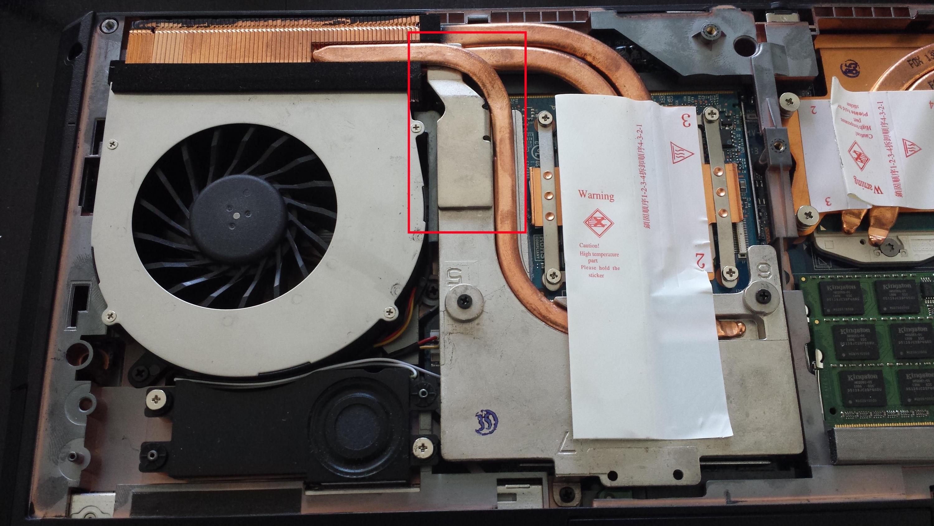

There are 3 different GPU heatsinks for P150 series as the series progessed. For the ones you linked, the upper is superior to the lower. The reason for this is on later models Clevo made the core heatpipes thicker. You actually didn't link the best heatsink, which has radiators similar to the one in the 2nd picture, but has the fatter heatpipes like the one in the 1st.
The heatsink in the 2nd picture you have is the earliest heatsink. It is found in P150HM and P150EM series laptops.
The 1st picture is the first heatsink update. This was found in 700m series cards in P150SM laptops.
The unpictured heatsink that I described is the latest heatsink. It was used on 900m series cards.
