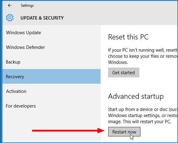

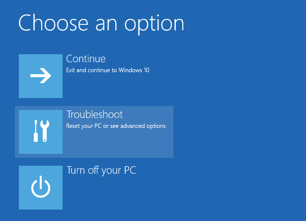

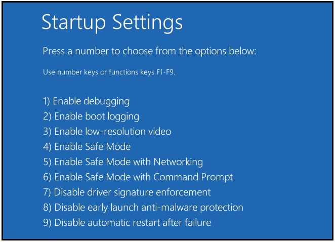

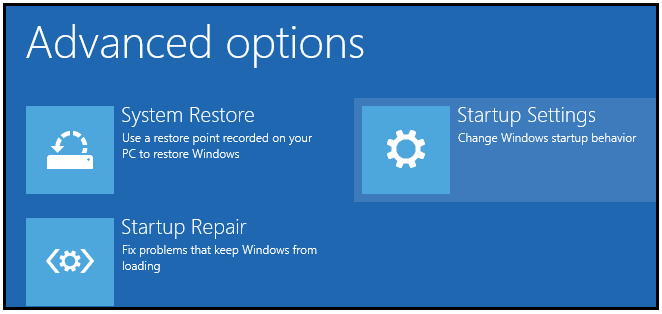

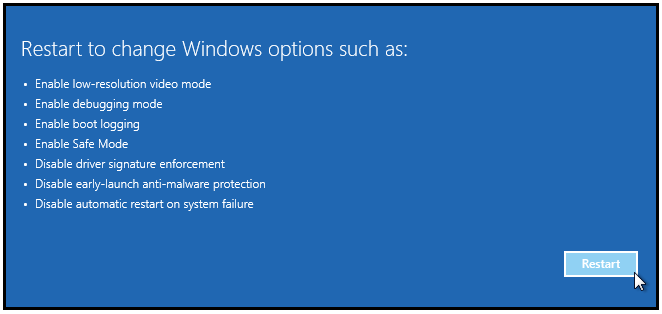

Yes I understand that, but I want to know what is causing the fps. It sounds like the coreclock stays at idle. MSI afterburner can tell you that. Also I am not 100% family with the m17x r4, I think it maybe has nvidia optimus technology, so the problem could be it keeps using the Intel graphicscard and not the nvidia. Said in another way, it stays in powersafe mode.
But in general, nvidia has fucked up their drivers very bad, making many cards useless. Your modding seems to be correct. I assume you did disabled the forced driver signature, otherwise modded drivers will not install probably.
I will give you a link for a thread where the newest drivers are modded so the performance issues are gone.

19 minutes ago, Henrik9979 said:
Hi henrik,
thanks for posting back.
I'm not sure what you mean by disabled the forced driver signature. I don't recall having to do that. What should I have done?
I will play around with MSI afterburner and report back.
Sorry for all the questions pal, you must be getting sick of me :)

To disable driver signature in Windows 10.
First you click on the Windows 10 logo in the bottom left corner and choose settings.
Then just follow the pictures.
When getting to the last picture press 7 or F7, it doesn't matter.
Remember, this way you only disable driver signature until you restart the computer again.
If you want to disable it permanently let me know.
