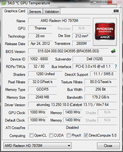

  18. Congrats on the new card! You're going to really enjoy it since it's a massive jump in performance from your 4870M. I don't think you have to worry since you have a CLEVO card. Those reports were for Dell cards. There hasn't been any reports of newer CLEVO card's having the same behaviour so I think you're fairly safe. That vBIOS came with @nitsun69's CLEVO 7970M and worked perfectly with no compatibility issues. After some googling I found that, that vBIOS seems to be built for the P370EM.. and is enduro enabled. So I have no idea how it worked in his R2 honestly. Another strange thing was that his vBIOS had default 1000mhz core and 1400mhz memory clocks... so someone most probably tinkered with it. He took the below GPU-Z screenshot. He subsequently flashed a stock undervolted vBIOS since his temps were hitting 90C's with those clocks and didn't backup the version that came with the card. If you could, please backup that vBIOS and post it here once the card arrives. @svl7 Do you have a copy of this vBIOS by any chance?
