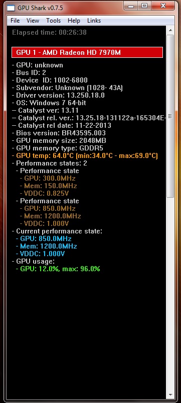

  2. This screen is amazing, in the dark my friends and i drool a little. My touch pad is blown, so it needs to be replaced, then its (almost) mobile (the bettery doesnt even last an hour, without gaming! hah) anyway.. I did try the hdmi. I get video but no audio =( I did get vid and audio with the 4870m, the 7970m should be capable of pushing both.. I know @sangemaru gets audio and video out of the hdmi, what gives! Here is the screen shot of the GPU Shark, while playing sanctum 2. Steam ID - StoneyBologna420
