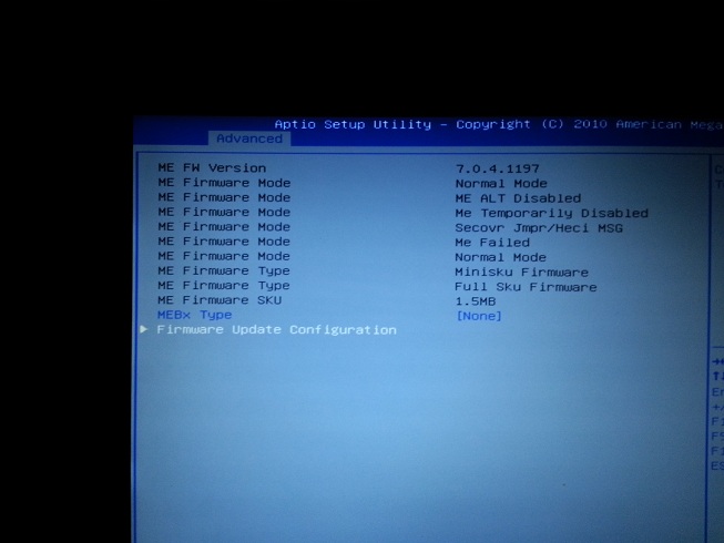

I've been looking into this for a while, right now I've reached a dead end because I can't open my original ME FW in FITC to see the oem uuid to be able to flash an unlocked one. It has an .424 file extension but I can't even open it when changing extensions to .bin .rom or whatever. I've been able to make a backup of my current ec fw in dos but this file is also encrypted of some sort. When I change it to .bin and open it from FITC then it reports "unrecognized bin format". If I can edit the file in some way I would in theory be able to access the mbex. -

@Xonar You dont happen to know how to convert a .424 file into .bin? I've been searching my a** off.
That's certainly interesting, I really hope it's not a dead end. I will look in to this just a bit more before I give up but first i need 12hours of sleep before I get hallucinations ;D *edit* From what I've read you wont have to modify and flash the ME fw if I get this to work.

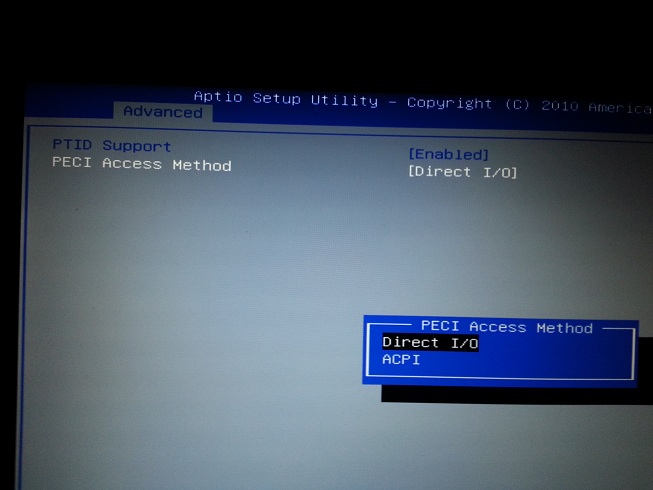

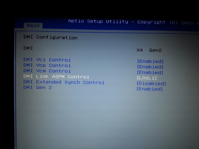

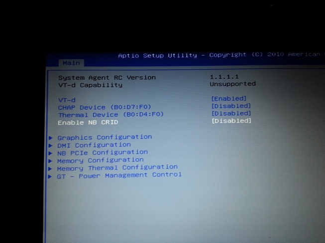

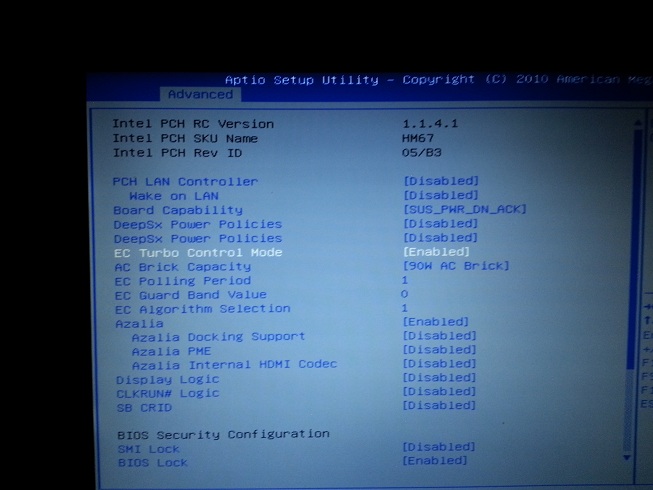

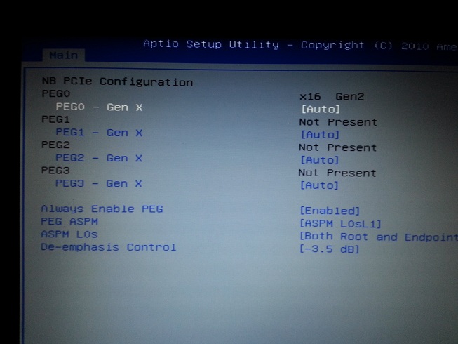

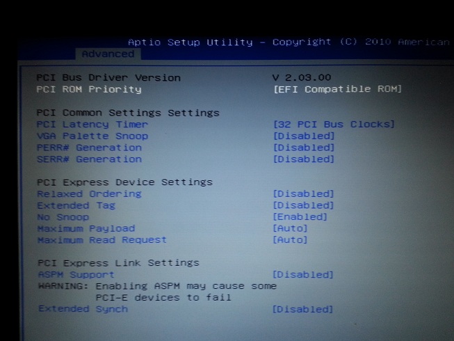

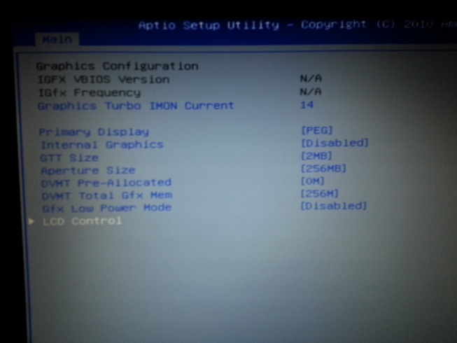

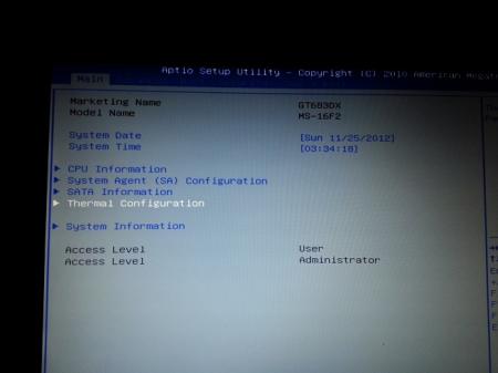

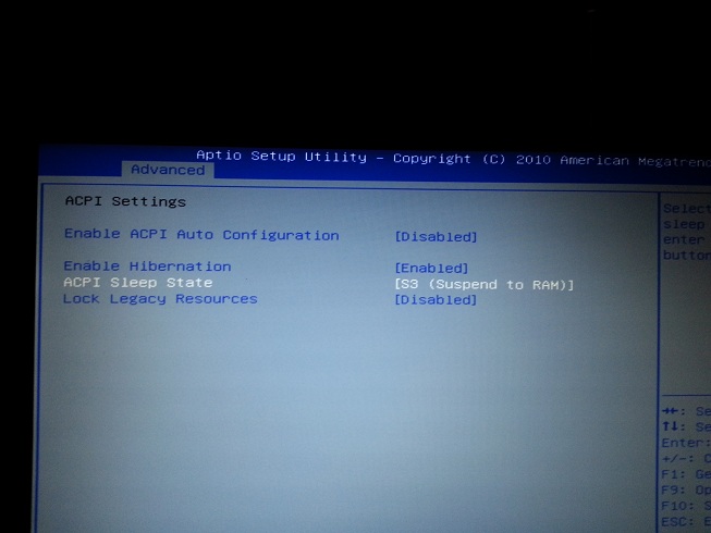

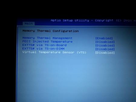

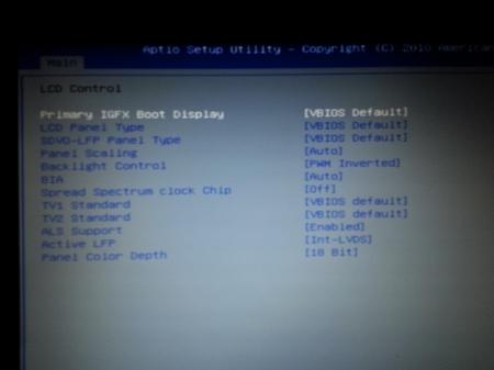

I've unlocked a lot of different features on my gt683dx that I couldn't see with the gt680/gt683 bios, I've been up for 34 hours looking for a way to access the mebx menu and now I'm trying to find a string in the bios where I can enable or find the key combo to enter the mebx which is integrated in the chipset, if this is possible I should be able to edit the me firmware too see if there's anything of interest in there. What I've learned is that dell uses ctrl+p, and others use ctrl+alt+f1 in post to access the mebx and the default password should be admin to gain entry to the management engine interface. Most other oem uses there own key combination I don't know if this is possible but I sure hope i might find a way around this.
