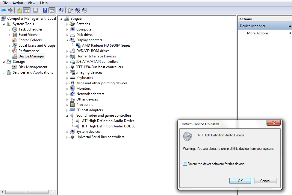

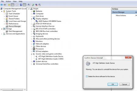

  19. The way I installed the audio driver was: Installed M17xR3 6970m driver. Updated to the current amd driver. Now that the graphics are set I removed the audio driver. Remember tick on "Delete the driver software for this device". After that I used the device manager to update the driver from the dell package here: C:\dell\drivers\R291070\Packages\Drivers\WDM\HDMI\W764a (the post editor doesn't show this space, which shouldn't be there -.- : "HDMI\ W764a") Then restarted the pc and it worked. Thats the same way I had to do with the 5870. For some reason it didn't want to install correctly through installer.

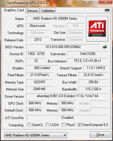

  20. Yea just like inap's card, i needed to swap the metal thingy beneath the card. (used one from a dell 260m) The fans adjust just fine for me. Temp goes from 52 to 85 C, a little bit hotter than my dell 5870m. (think it was topping about 75). I like that throttlestop is able to see the temp sensor.
