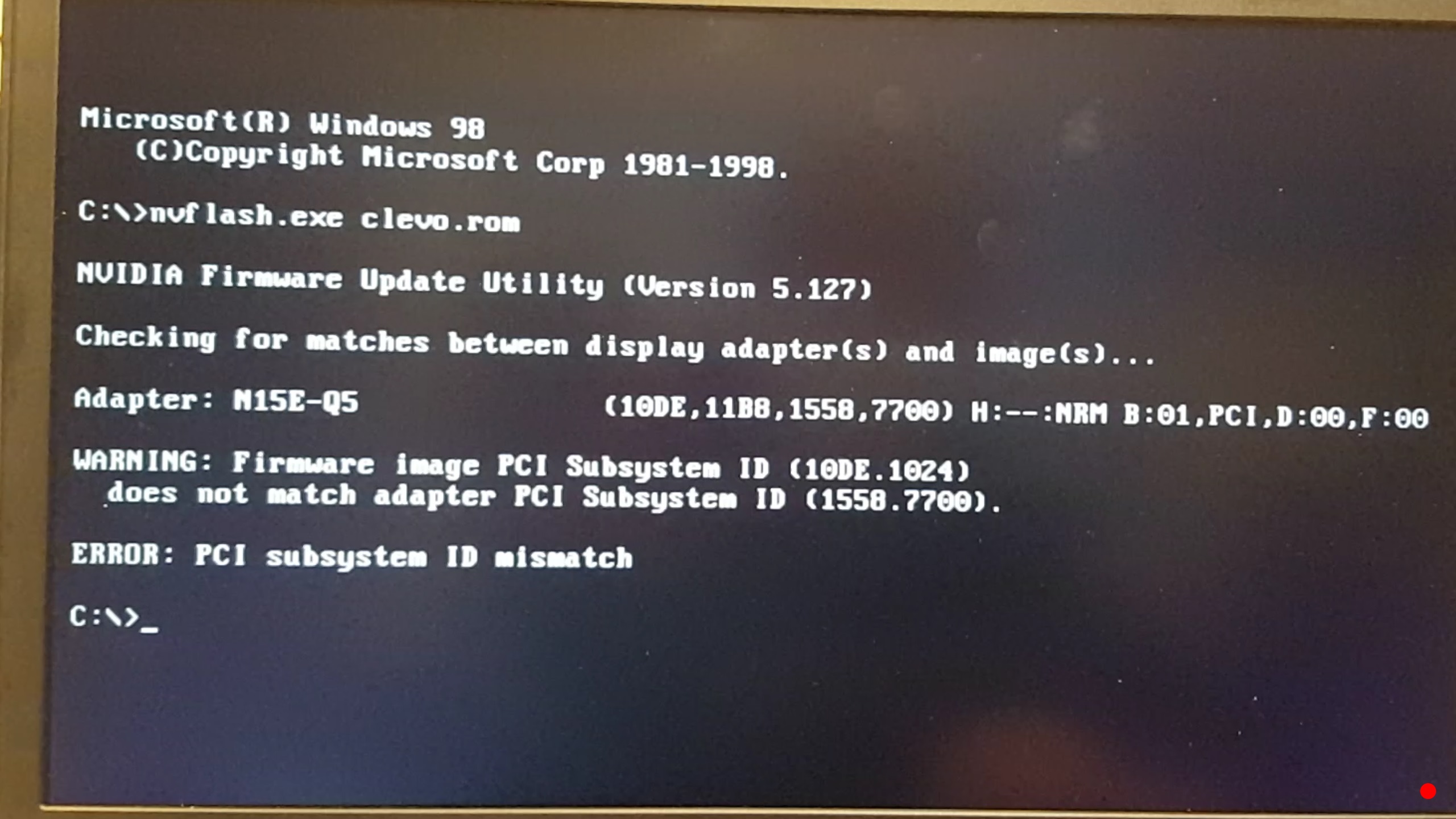

Flashed the vBIOS. It worked, thanks again!
I tried to flash the vBIOS using nvflash from a DOS startup disk. It said that there was a mismatch, and wouldn't flash (nvflash.exe clevo.rom). Would you recommend that I proceed with typing -6 to force flashing the vBIOS?

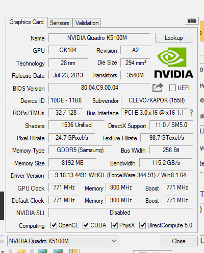

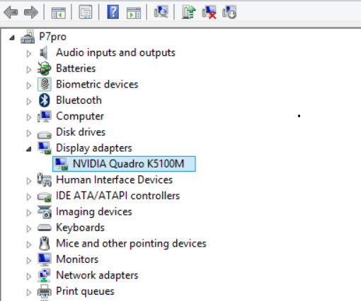

I removed the Geforce 980m and replaced it with the K5100M in my Clevo P770-ZM The card worked right away without having to modify anything. The K5100M was an HP card bought off Amazon.
