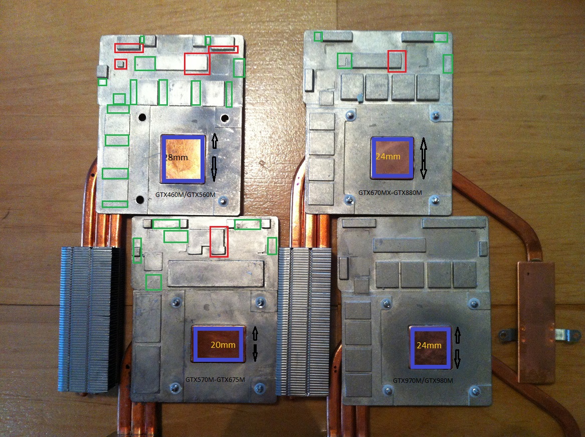

Hello Both CPU`s are not working in GT780,only Sandybridge CPU`s are working there. For Example:i7-2670MQ. You could use this Cards: GTX 460M,GTX 560M /same Heatsink GTX 570M/GTX 580M/GTX 670M/GTX 675M /same Heatsink GTX 765M(Clevo Vbios)/GTX 770M(Not Dell) /same Heatsink GTX 970M/GTX 980M /same Heatsink All other Keplercards like: GTX 670MX/GT X675MX/GTX 680M /GTX 870M /GTX 780M / GTX 880M and Quadro K3000M / K3100M / K4000M / K4100M/ K5000M / K5100M not working. But i think that Maxwell GTX 965M and Quadro M2000M / M3000M / M4000M M5000M also will work On the Pfoto You cansee the different Heatsinks

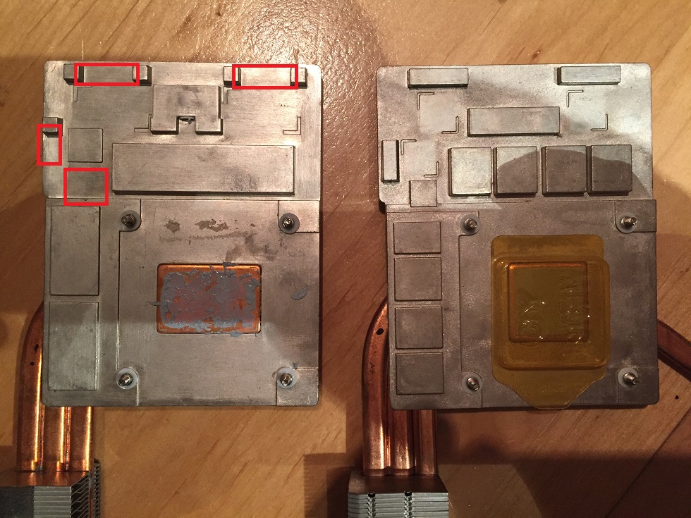

Is plug & play,if You have a 180W Power Adapter than all is fine. Here You can see the Different between the Heatsink from Fermi and Kepler Cards.
