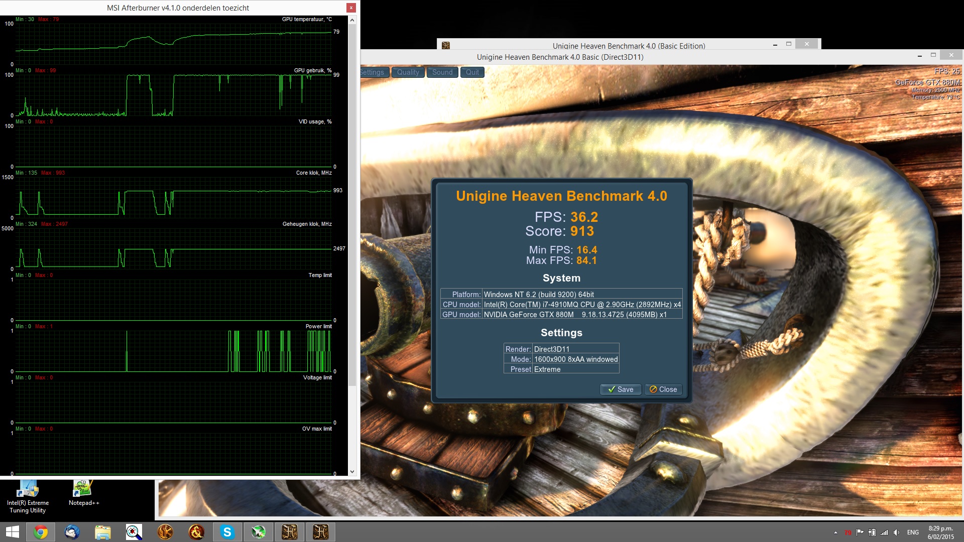

  8. I did a Heaven run with core clock (no changes with Afterburner or NVidia Inspector. I'm using MSI Afterburner to show/measure the stats during the run. My CPU is currently running at 3.9/3.8/3.7/3.7 with a core voltage of 1.2 V. I believe I'm running into some power throttling during parts of the benchmark: I don't think it's a lot, but wondering if there's anything I can do about it.
  9. Optimus is disabled (120 Hz screen with 3D). It's about 2 weeks old, and I haven't installed too many things on it yet. Machine is plugged in when I do any tests. What can best be used as actual fps benchmarks? I'm kinda new to this stuff.
