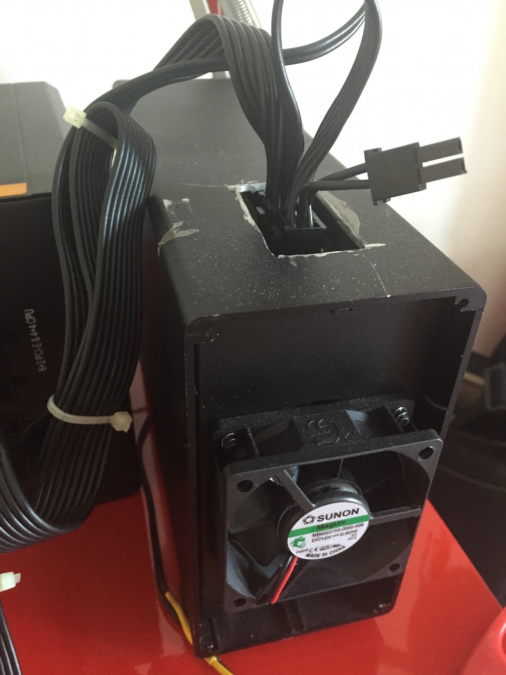

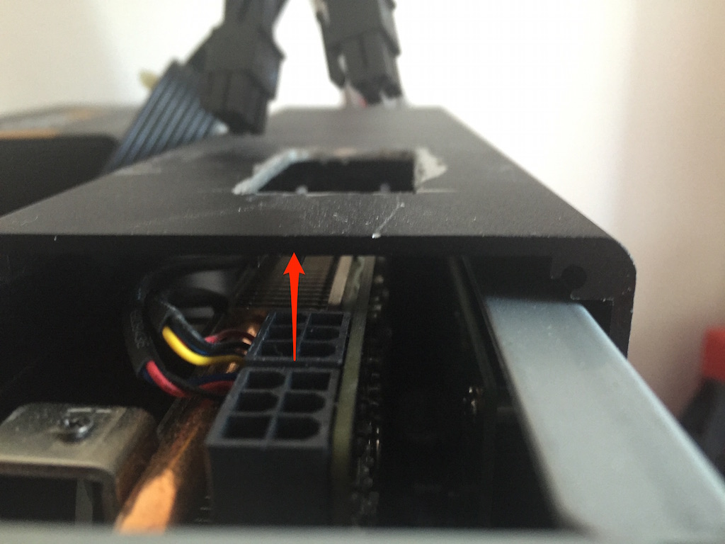

  1. Hi, there isn't any space, I had to make a hole in the case for it. I also had to mount the fan externally.

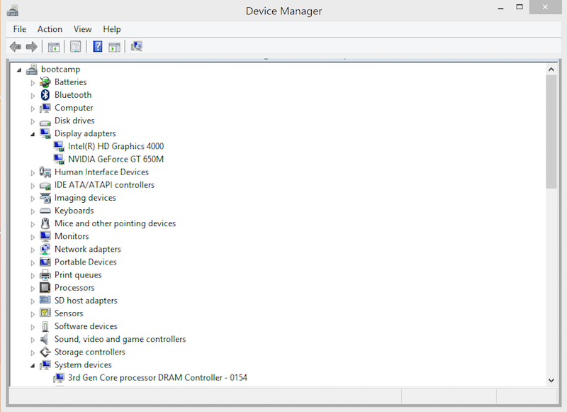

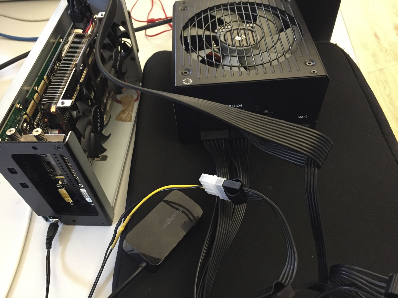

  2. I made a new package for build ​14C1510 https://dl.dropboxusercontent.com/u/422147/WebDriver-343.02.02f02-mod.pkg

  4. Great setup, it looks very tidy! I myself ended up cutting a hole over the pic-e connectors in the akitio box and keeping the two units (egpu & psu) separate.

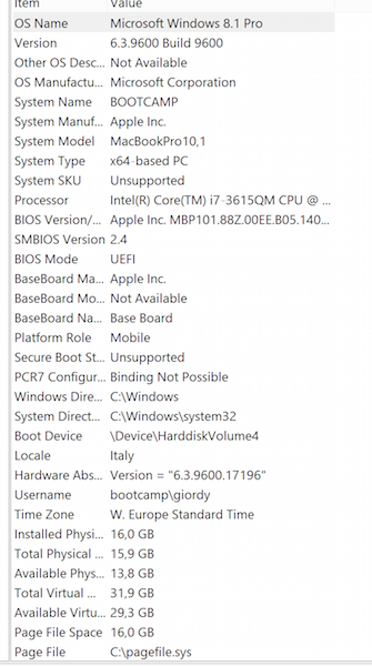

  8. Quick update: It looks like my macbook pro does not fully support UEFI (the fact that the sound card didn't work was a clue) so I reinstalled windows without UEFI, configured eGPU DIY Setup 1.20 following these instructions (http://forum.techinferno.com/implementation-guides/8006-%5Bguide%5D-2012-15-macbook-pro-gtx750ti%4010gbps-tb1-akitio-thunder2-win8-1-bios.html) and then everything started working properly! Kudos to @Tech Inferno Fan for sending me the software so quickly! The only issue that I have so far is that sometimes, when I boot windows with the eGPU attached, it would start on the external screen (the rift in my case) and it won't let me initialize the eGPU. If i start unplugged and connect it when windows boot then DYI Setup won't recognize it.
