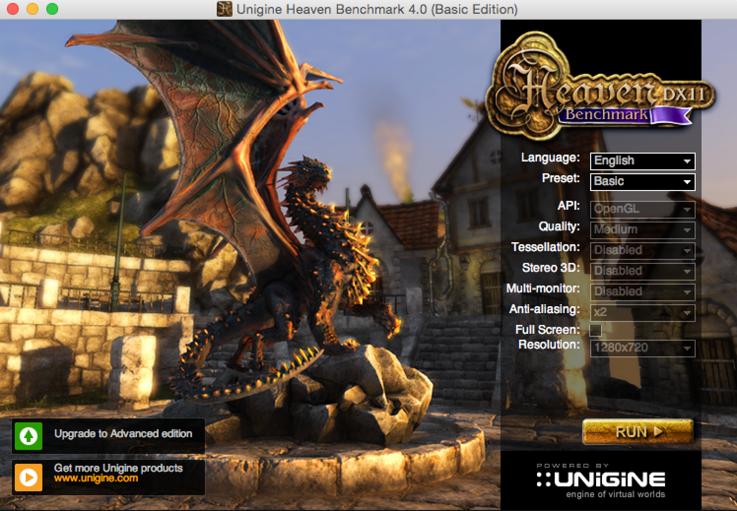

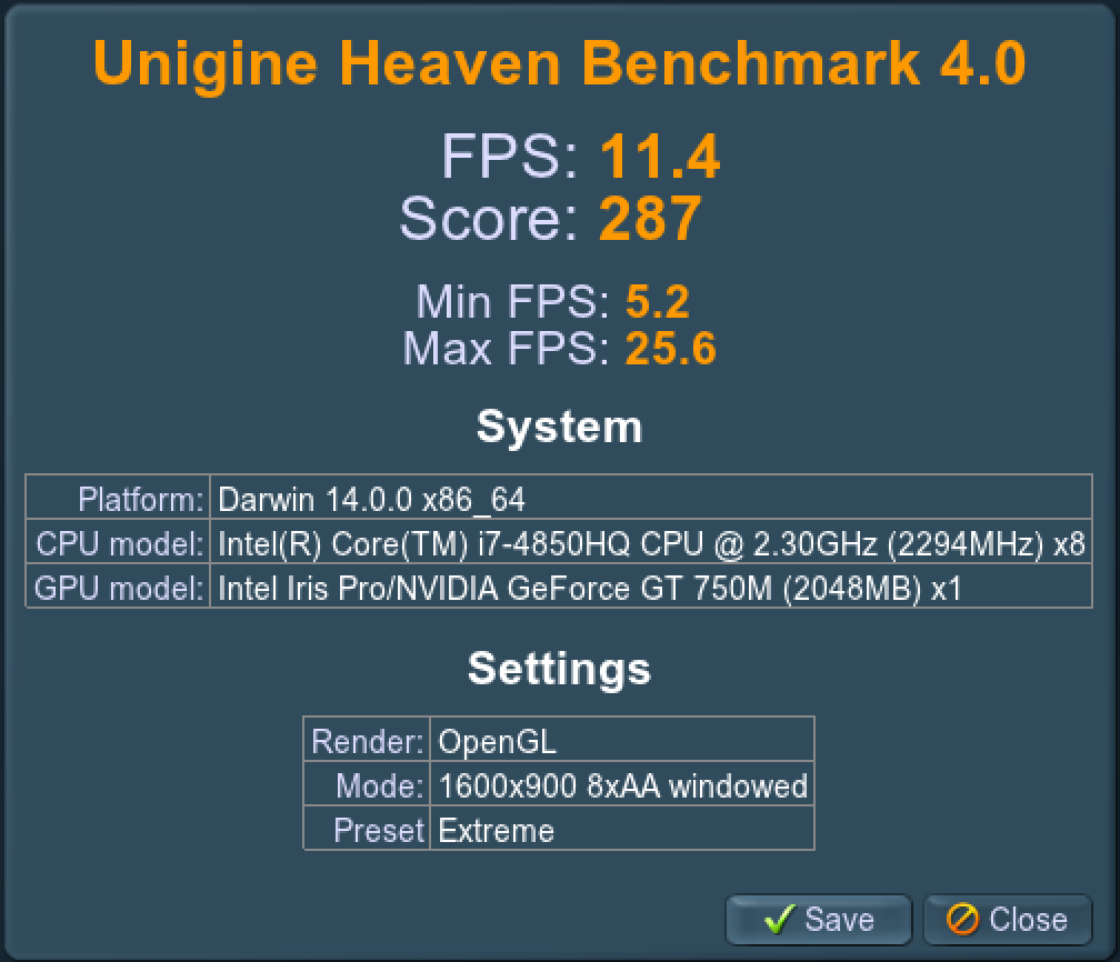

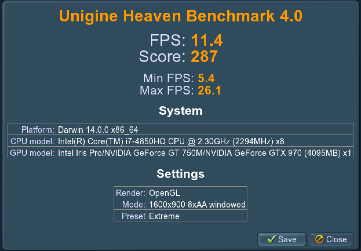

  2. The score with extreme parameters is very low...so I've tried to start the test without the GTX970...and the scores are exactly the same...there's something wrong in the settings of my eGPU?

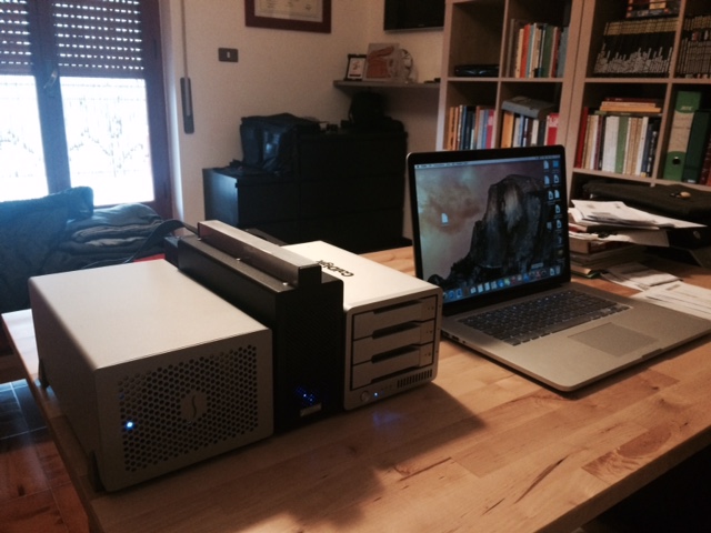

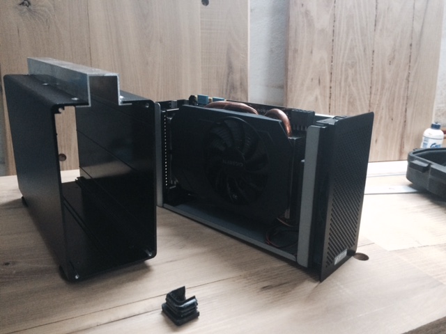

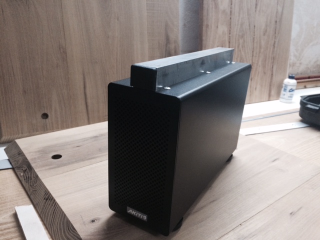

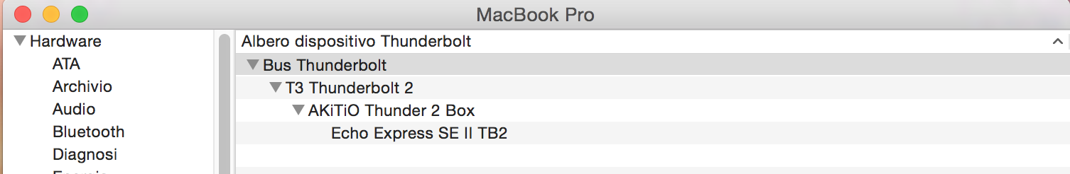

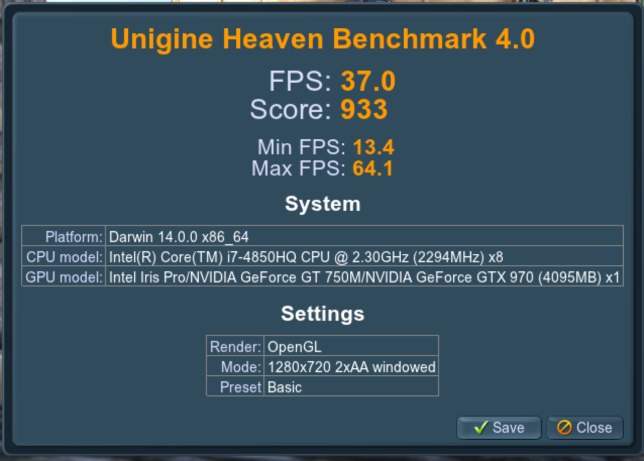

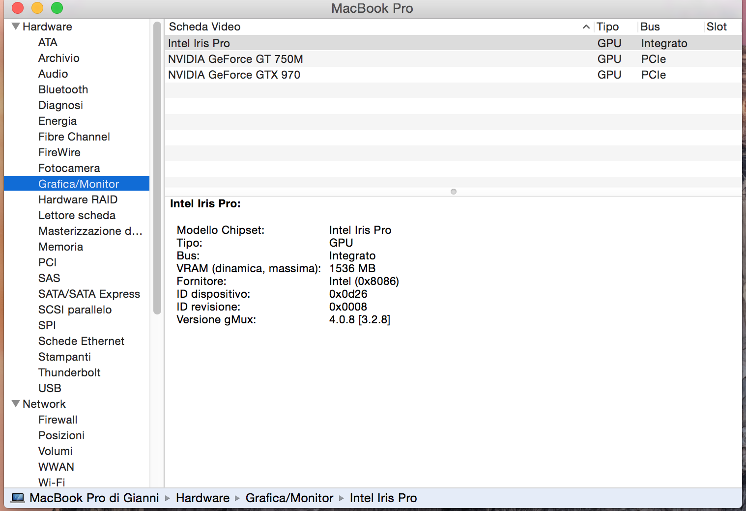

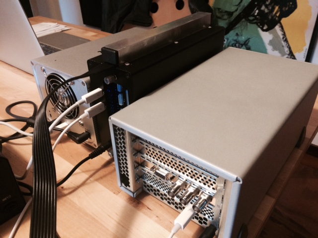

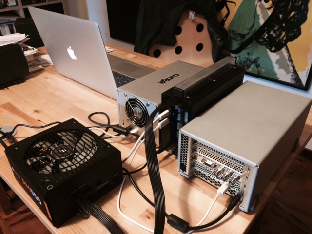

  3. Hi guys, here we are! Finally I have chosen an Atikio Thunder2 and this is what I've done... Second, I've followed this procedure: [GUIDE] 2013 15" Macbook Pro GT750M + GTX780Ti@16Gbps-TB2 (Sonnet EE III-D) +OSX10.10 This is my new macbook... The computer, now, starts properly and the GTX 970 appears (not on the first window)... I've tried to test the gpu with Heaven (basic option) and this is the score...what do you think? I want to precise that the fan of the Corsair 550 has never spinned. Is it normal?
  4. Hi, after more and more tests I've understood that probably the problem is due by an uncompatibility between the Sonnet EE SE II and the GTX 970. I've followed MVC's instructions for modding the Nvidia web driver and the kexts files and I've tried with Yosemite 10.10.1 OS and Windows 8.1. I've plugged the eGPU on PSU, and the TB2 on computer. I've turned on the PSU, the Sonnet and finally the computer, but it begins to work (the fan spins and the temperature increases) while the monitor and the keyboard are completely black and the mac doesn't works. In the Sonnet I've plugged two PCIe cards: GTX 970 and DeckLink SDI 4K. So I've thought to try disconnect first one and after the other, and start the computer. When the only Decklink is plugged in, the computer starts. When GTX 970 is plugged the computer doesn't works. So I believe that the problem is the Sonnet...What do you think I can do? I've to try with Akitio or something like that? What do you suggest? Thank you.

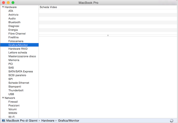

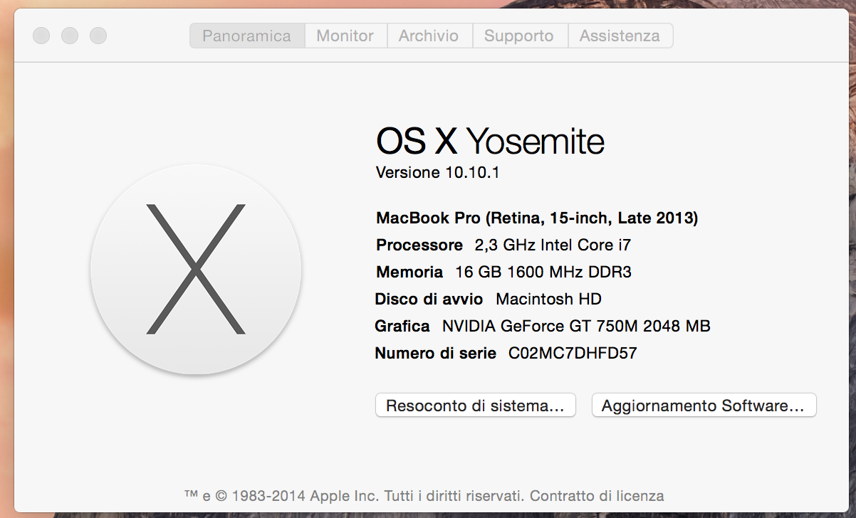

  8. I've reinstalled Yosemite and I've done all steps one more time. I've tested the PSU with a fan and it works. Finally, I've booted OSX and plugged the thunderbolt...Now any graphic card is shown in the system infos and, if I start o restart the computer with the thunderbolt connected, it doesn't boot the OSX.

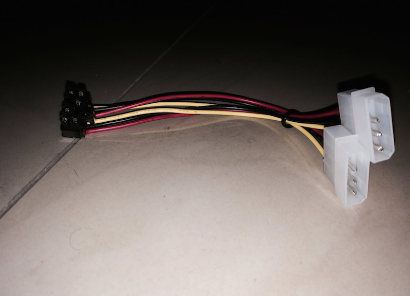

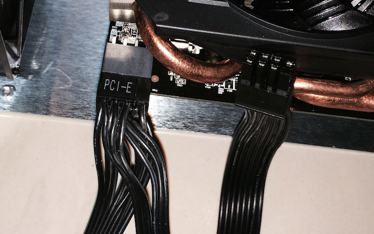

  11. I didn't used a paperclip. I've just used the molex I've found in the box of gtx 970: After I've used the cable of PSU, a PCIe 6+2 pin like this: I didn't used a powered riser but I've used the sonnet external power. I've Windows 8.1
