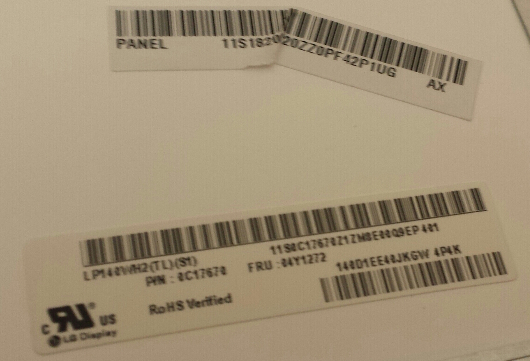

  14. the new screen is this (EmberV on notebook review said he got that exact model number to work on this laptop). I will edit my post when i get off work and disassemble my laptop and tell you the 768p screen model number. thank you so much for your help and time! I also decided I'll try and splice in the extra cables or something. attached a photo of what the tag says on the 768p monitor. sorry I'm late.
