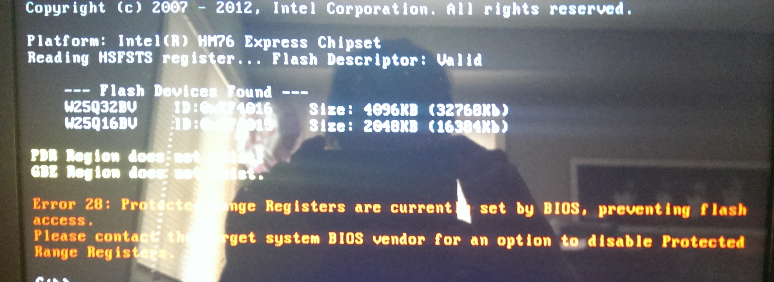

  2. Holy cow! first off the thread was a great help and very easy to follow. I managed to do everything correctly. booted into the dos and then fpt.exe -v204mod.bin -bios i get this does this mean im basically screwed? tried to search forums couldnt find another thread about it.
