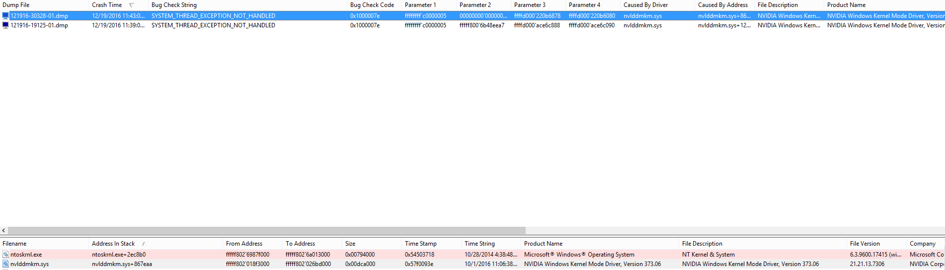

  5. Wanted to move to a stable driver newer one, from 369.05 I moved to 373.06 and I get Black screen boot and then machine reboots all over and then it boots successfully says PC ran into a prob checking the dmp file shows the nvlddmkm.sys / ntsokrnl (wmiacpi - this one is new one i noticed after 4th time of failure never saw it again tho), which error happened . Anyone with AW17 R1 could replicate this ? Running SVL7 vBIOS. Edit : Tried Prema v2 vBIOS, same issue, tried the driver 375.63 same issue with both vBIOSed. Tried disabling the Win8.1 fastboot no change, always happens when I shut the system down and start, with restart doesn't happen, A huge PITA T__T. Win8.1 something is happening with the new drivers...!! Edit2 : Weirdly after disabling the hiberfile using powercfg.exe -h off it boots (the reboot causing the system to boot everytime after that shutdown is because of the messed up hiberfil, wow ngreedia & I disabled the fast boot in BIOS it doesnt but the admin cmd does disable the fast booting properly wtf ? ) Keeping that aside, So what's the issue with the Hiberfile.sys on these new drivers ? They don't allow what ? Dafuq Nvidia shenanigans did omg !! Trying the notebook drivers this time.. EDIT 3 - Posted at Nvidia forums.
