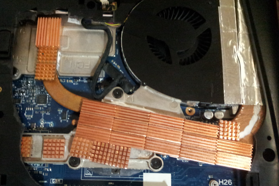

  19. Dude you have the worst timing for your requests lol
    The laptop is back together and its setting overnight :(  Takes 4-5 hours for thermal glue to set
    Preliminary testing is fun though, Pushed 1300 core on the single 755m +100mv offset. Might try for 1350c tomorrow, sad to see 1400c is too much
    Too bad SLI is garbage and crashes under almost any GPU intensive title I play @stock. (R6 Siege mostly, Coh2 doesnt support SLI)
    I bridged the gap between the heatpipes in preparation of its use for the CPU exclusively. Ill show pictures tomorrow, for now its time for bed.
  20. Please be sure to share how you did that, would love to learn that process.
    Are you referring to the Gray boxes beneath the heatpipes
    Well at least can pull 4Ghz for gaming
