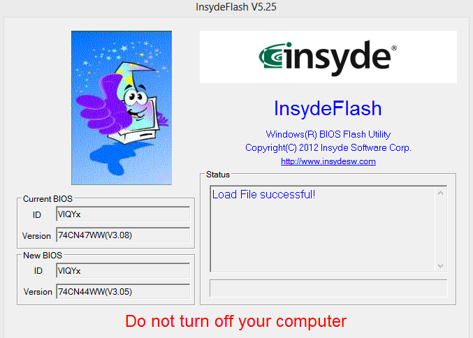

  1. does anyone know if I can downgrade from 3.08 to 3.05 with the stock Lenovo tool (74cn44ww.exe)?
