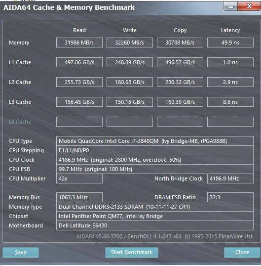

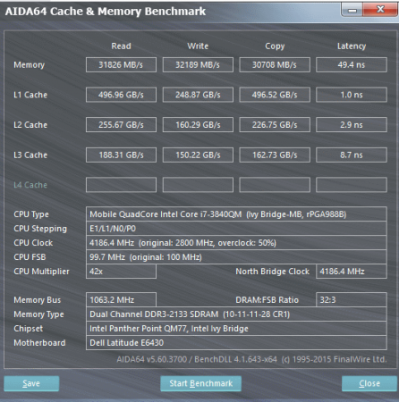

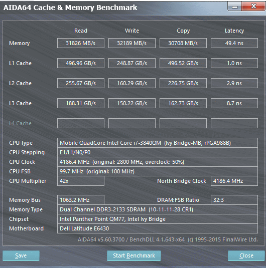

Nice find! It is working indeed! I can boot at 2133 10-11-11-34, trying to tighten a bit more :)
Great!!! It seems like your memory controller can perform.. Could you post some performance results when you find the sweet spot?
i can go down to 9-11-11-X, but it performs rorse somewhy than 10-11-11-X, the memory copy is down from 30.5k to 27k.  , anything lower for tRCD and  tRP than 11 doesn't boot, and , and tRAS wise i can kind of set anything (tried even 13) and it does run memtest without errors, but the setting affect the performance and latency a little bit. Latency wise 28 is the sweet spot, RW speed wise is 27. The difference is very small, but consistent across multiple benchmarks.
2133_10_11_11_27.thumb.png.88cdd845e16242133_10_11_11_28.thumb.png.ffcf096b8f824

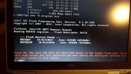

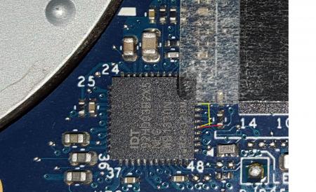

Trying this paperclip mod to unlock bios for dumping and then flashing.
But I get this error. I read about that Error nr 26 means, that I don't have great connection. Or maybe I am connecting the wrong things.
Should I connect pin 5 and 9 with each other (create a bridge between them)? Or what exactly, cant figure out the picture in the first post.
Weird thing is that first time I tried to dump the bios with no paperclip mod, just to see if I get that error- I did. But 2'nd time I connected the pins (at least I think I did), because now it showed that "Flash devices found", which it didn't show before... but still... Error nr 26 at the end.
Added a picture. What should I connect each other? The yellow connection (pin 5 to pin 9) or red connection (ping 5 to resistor)?
Much appreciate the help!
PS. Do I need to maintain that connection through out the entire time, or just so far when I see a boot screen and then release the paperclip?
EDIT: GOT IT!
Connected the pin 5 to pin 9 (yellow line) and this time it started to dump the bios. And had to hold it only when I saw the Dell logo loading.
