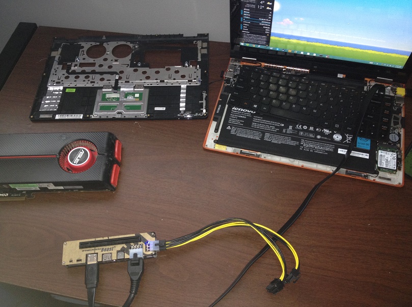

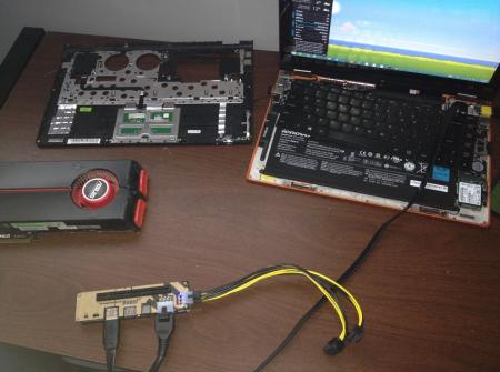

Slamx 10 Posted March 14, 2015 Hallo friends!I recently bought the EXP GDC Beast and am having some issues with it. Here are the specs:Lenovo Yoga 13Windows 8.1 64bitIntel i5-3337U 1.8GHz8GB RamEXP GDC Beast (not sure the version, has a blue and a white LED)Dell D220P-01 Power SupplyATI AMD HD RADEON 5870 (I know it's old)So I can get both LEDs to light up, and the fan on the GPU spinning, but my laptop doesn't pick up any display adapters. The USB port on the Beast also does not function. I have installed the 5870's drivers on the laptop, but it doesn't even see the adapter, am I missing software or something? Quote Share this post Link to post Share on other sites
