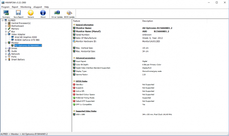

HWINFO64 can read out the screen EDID in the image below. Can it still read this data with the Nvidia driver installed? I'm trying to figure out if EDID reading or eDP output is messed up with the driver.
In the display properties is it not detected by the system at all, or it is detected and enabled but displays nothing?
Edited by Khenglish
Not detected with nvidia driver installed in system and hwinfo. if i disable it and restart, detected. Even not detected, i can use hotkey to shutdown the backlight.

Ok so it's definitely a problem on the screen detection side and not the display output side (I was thinking maybe 4 lane edp was the issue but it's not). The screen should always be read by hwinfo64 as that's a straight spi bus read by the gpu. This means the gpu isn't even trying to read the display, or tries but fails.
As for how to fix this... idk. I'll check your mobo schematic and see if anything looks off compared to other systems with edp.
