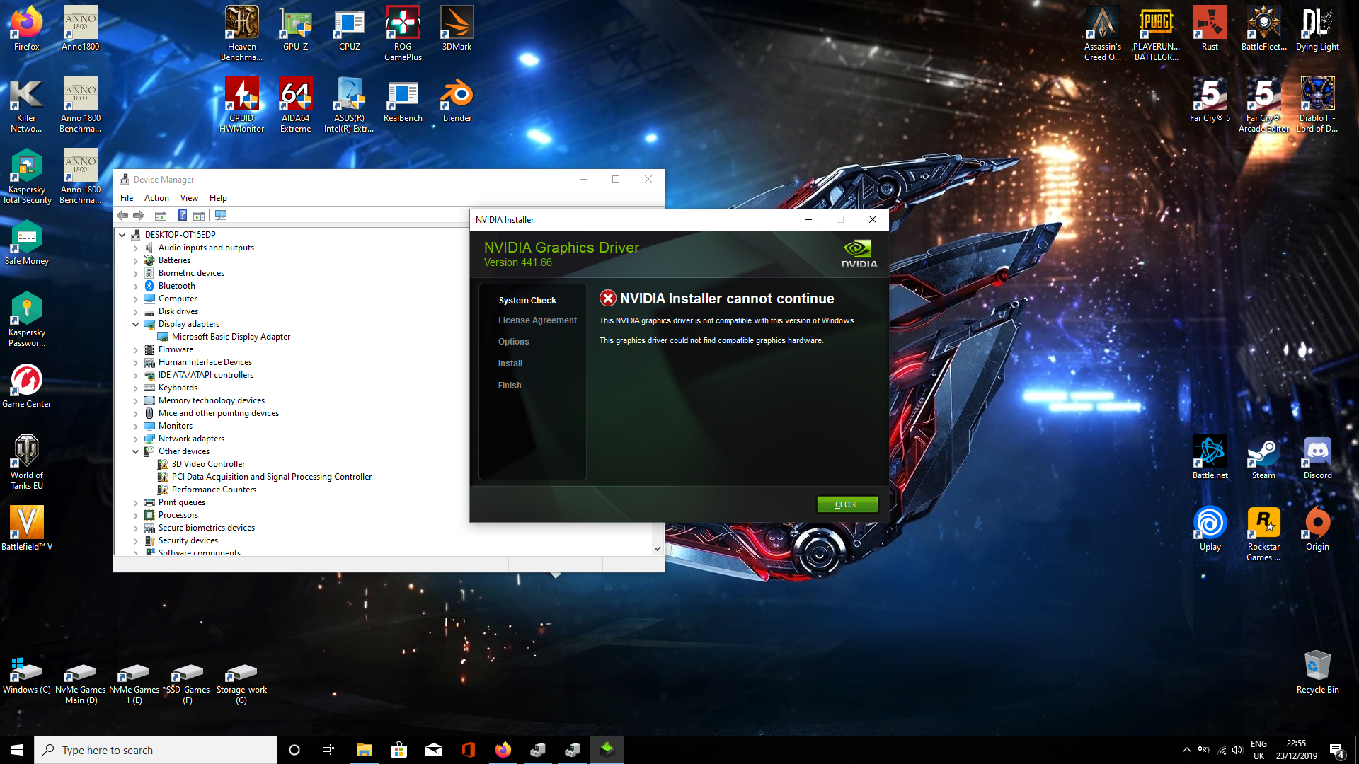

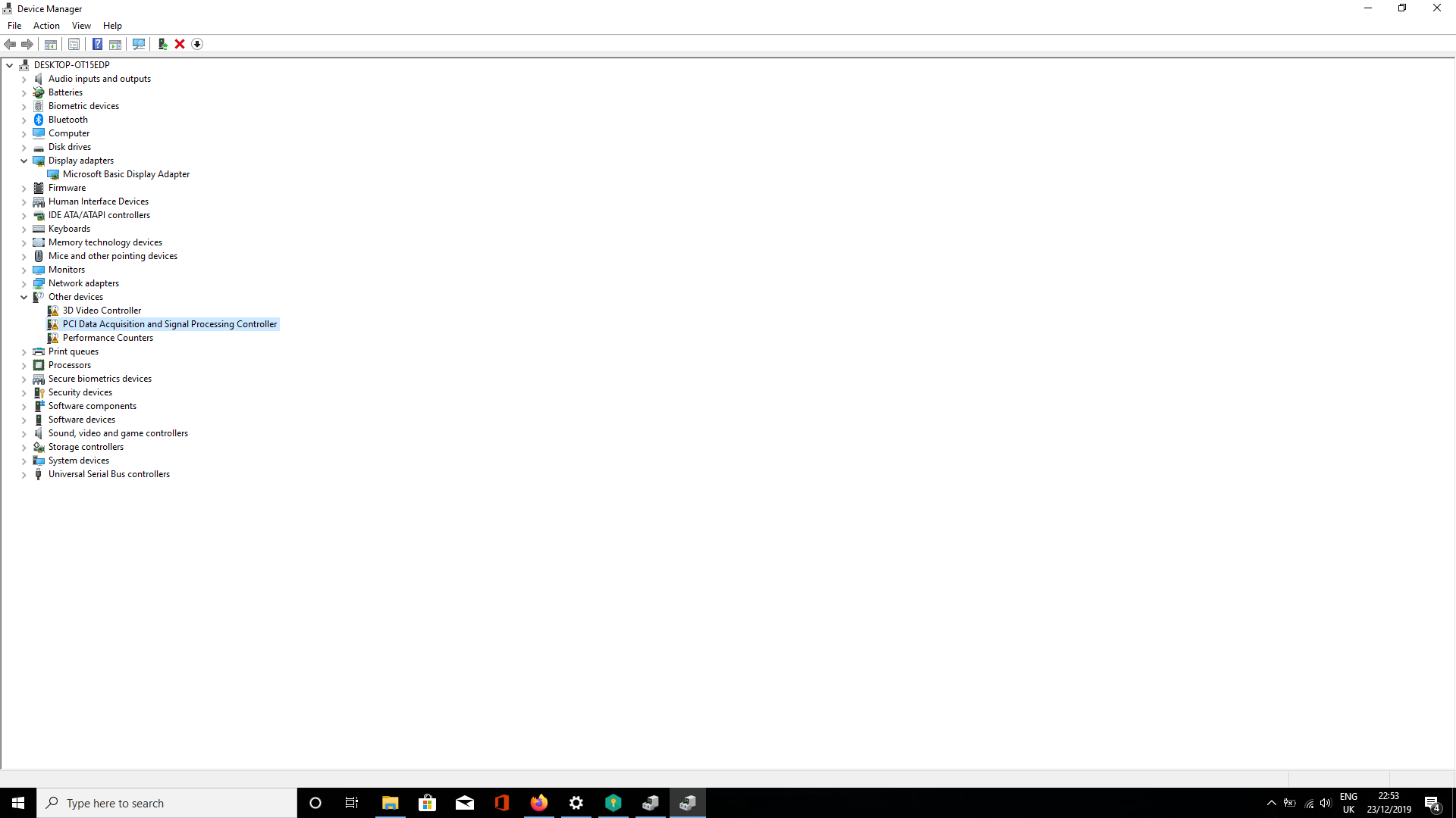

need help after flashing this bios windows 10 no longer sees either of my nvidia 970m's but there both showing in bios ive tried flashing standard bios and still get same problem they worked fine before i flashed your unlocked bios all windows shows is microsoft basic display adapter ive tried everything and searched for hours and hours with no luck tried all drivers and used driver uninstaller and did a clean install of windows, nvidia drivers dont detect cards so cant install the drivers please help thanks..... Right update ive managed to get the drivers on by reverting back to standard bios and modifying the .inf file in the driver as for some reason the cards id's have changed but only problem is iam stuck at 65hz instead of the standard 75hz and iam no longer able to overclock to 100hz screen goes fuzzy after 65hz and ive also lost g-sync i guess i may have to try force an older bios as it stills says same bios version as the unlocked one

seems I'm getting the no GPU's as well, 2 980M just aren't here. microsoft basic display adapter and a ! 3d video controller.
