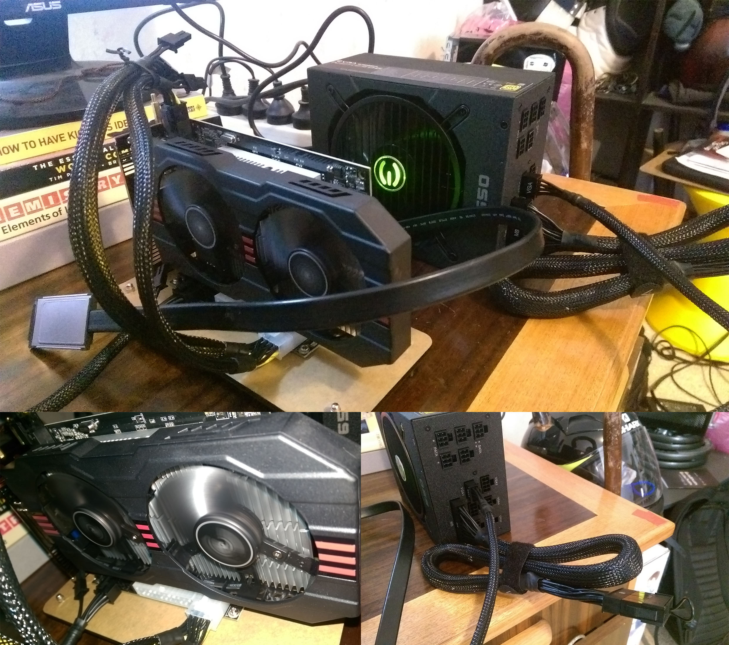

Hey guys. So I got this far.
Connected the laptop HP EliteBook 8460p i5 2450M to this ASUS Geforce GTX 750 Ti 2GB GPU via an express card /34
And this resulted in my laptops display not initialising which was to be expected I recall reading on different threads here.
My second monitor is using hdmi so I tried hdmi on the gpu and also connected a hdmi to dvi adaptor to the laptop and sadly the monitor never detected anything,
Can anyone help make sense of this with me?
BTW I connected the egpu while the laptop was off. Then powered the laptop on

10 hours ago, Arbystrider said:
I do believe that the 24-pin ATX connector is meant to go on the PE4C.
I have attached the 24pin ATX connector directly to the PE4C and now both fans from the gpu and psu dont run.
Seems to only run when I have the 24pin ATX seperate with a "tester" cap on it, like in the picture.
The only power that is connected is a 6/2 pin to the gpu which is connected directly to the PE4C and a VGA ATX 6/2 to the PE4C power slot lower left, also like in picture.
Adapter may be kill.
I don't know if this applies to PE4C, but on EXP GDC it should turn on the PSU when the laptop starts up.
I stand to be corrected, of course. For all I know I'm talking out my arse.
Whats the function of the SW1 and SW2 switches?
  • Support two delay switch to avoid registration problems when boot. (SW1, SW2)
Also cant do anymore till my laptop arrives, dont want to blow up my brother laptop
Edited by nidhoggur
