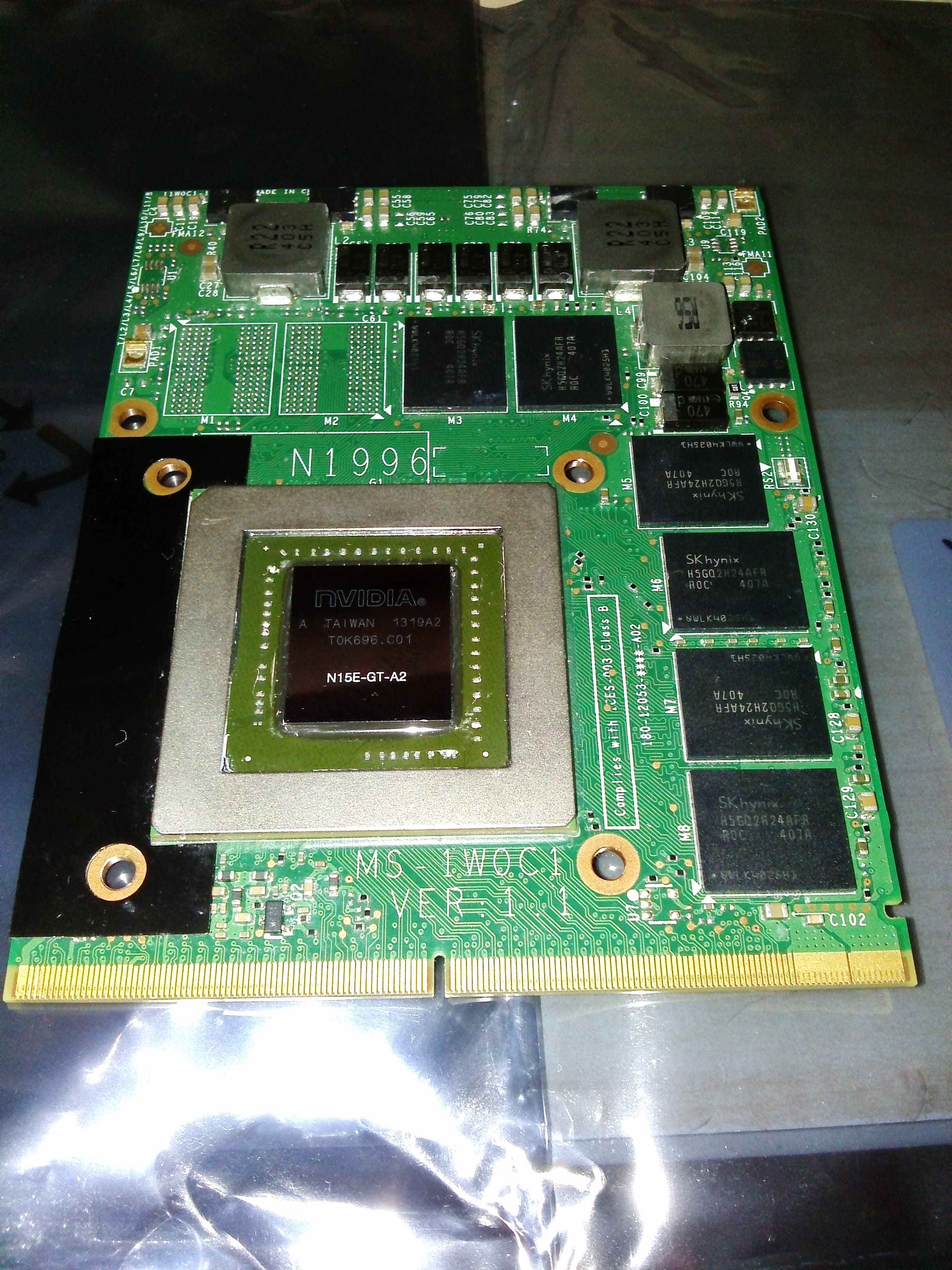

It is weird because I bought the VGA from a guy that tested it in a MSI GT60.
Please make a Picture from the Card. From where you get the Card ?
But you do not make great hopes, I have also been tested  a MSI Version of the GTX870M in a Medion Erazer X6811 (same barebone as your device) without success...
Alternatively, I would recommend the MSI version of the GTX770M that you get with some luck for the 220-250Euro as it is quite rare. The would be compatible to 100% Plug & Play.
I might as possibly even get this version. If interested, I would take care of it.
