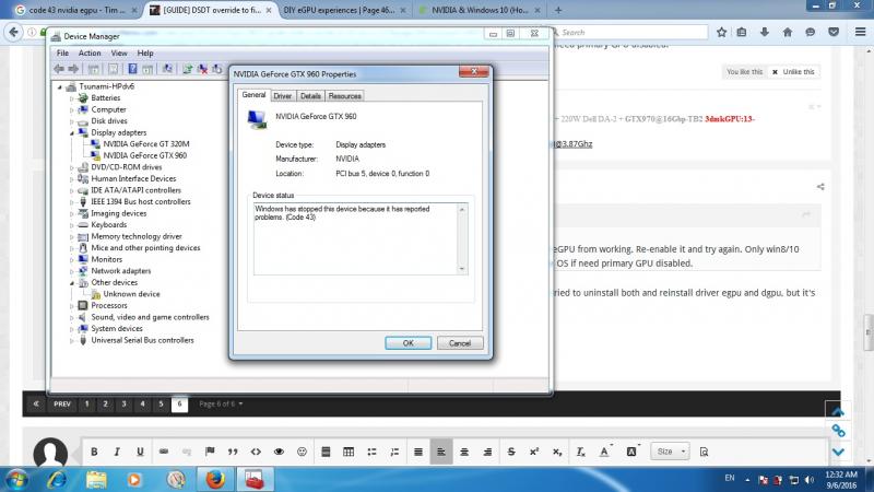

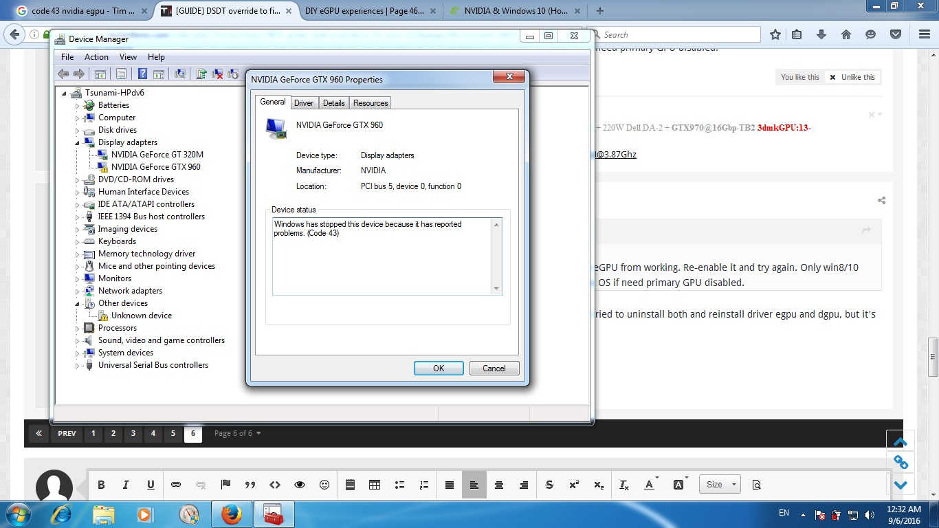

Toan Posted September 5, 2016 Share Posted September 5, 2016 (edited) 2 hours ago, Tech Inferno Fan said: You cannot disable your primary GPU (iGPU or dGPU) under Win7 as doing so prevents the eGPU from working. Re-enable it and try again. Only win8/10 (or older XP) allows the eGPU to work when the primary GPU is disabled so try one of those OS if need primary GPU disabled. Hi, after i enable and install driver for dgpu (nvidia 320m), my egpu (gxt 960) show code 43. I tried to uninstall both and reinstall driver egpu and dgpu, but it's still error code 43. What can i do? Edited September 5, 2016 by Toan Link to comment Share on other sites More sharing options...
Tech Inferno Fan Posted September 6, 2016 Author Share Posted September 6, 2016 12 hours ago, Toan said: Hi, after i enable and install driver for dgpu (nvidia 320m), my egpu (gxt 960) show code 43. I tried to uninstall both and reinstall driver egpu and dgpu, but it's still error code 43. What can i do? Windows uses a unified driver for both your NVidia GPUs. Problem is Win7 uses the old GT320M driver that doesn't support the GTX960. Pls upgrade to Win8/10 where you can disable the Nvidia dGPU and install the Nvidia eGPU driver. 1 Link to comment Share on other sites More sharing options...
