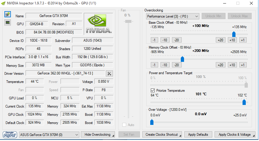

TheSwede86 Posted March 2, 2016 Author Share Posted March 2, 2016 (edited) @Klem Thank you very much I downloaded "Asus GPU Tweak II" which also monitors the temperature (guessing all other OC-programs does this as well) and will be OC:ing and monitoring temperatures with that and benchmarking with 3DMark (Firestrike 1.1) and the built-in Shadows of Mordor benchmark on Ultra. Wish me luck I'll post my before and after results here as well as buying you some beers in a few days mate --- Edit: Tried Nvidia Inspector instead and I am now on my way I'm at +100 / +200 / +0 (Core/Memory/Voltage) and 3DMark runs fine. Temps are max 72 C after running the benchmark. Any idea on how to go above the +135 for Core using "Performance Level [3] - (P0)" which I'm guessing the one I should use? Also when I reboot does Nvidia Inspector resets itself to default clocks and I'll need to create a shortcut with the OC settings and apply them each time I reboot? Which increments (i.e. 25 on core, 50 on memory) are you guys using to up your speeds? Which increments should I then try to raise the voltage with if I experience artifacts? Haha sorry for the many questions, I tried donating to you @Klem but when I log in to PayPal I only get the starting page, if you would PM me your details for PayPal I'll happily send some your way. Edited March 2, 2016 by TheSwede86 Quote Link to comment Share on other sites More sharing options...
Bios Modder Klem Posted March 2, 2016 Bios Modder Share Posted March 2, 2016 (edited) Post here a screenshot in NVIDIA Inspector. If you get any artifacts, then you need a little bit reduce memory clocks. Edited March 2, 2016 by Klem Quote Link to comment Share on other sites More sharing options...
TheSwede86 Posted March 2, 2016 Author Share Posted March 2, 2016 24 minutes ago, Klem said: Post here a screenshot in NVIDIA Inspector. If you get any artifacts, then you need a little bit reduce memory clocks. I actually as of yet does not have any problems with artifacts but guessing that will be the case when I try to go higher. The thing is that "base clock" seems to be capped at +135 so I would not be able to rise it higher then that. Btw the link worked Ty again. Quote Link to comment Share on other sites More sharing options...

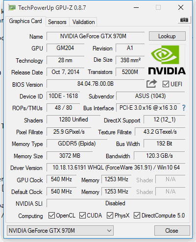

Bios Modder Klem Posted March 2, 2016 Bios Modder Share Posted March 2, 2016 (edited) 48 minutes ago, TheSwede86 said: I actually as of yet does not have any problems with artifacts but guessing that will be the case when I try to go higher. The thing is that "base clock" seems to be capped at +135 so I would not be able to rise it higher then that. Btw the link worked Ty again. No, on this screenshot not my vbios mod. Please read the instructions again and flash mod vbios again. Do not forget then restart laptop. Edited March 2, 2016 by Klem 1 Quote Link to comment Share on other sites More sharing options...

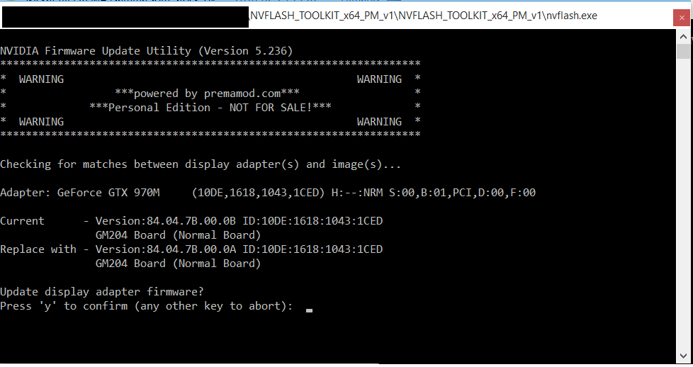

TheSwede86 Posted March 2, 2016 Author Share Posted March 2, 2016 (edited) Weird, these screenshots are from GPU-Z, "0B" is stock and "0A" is the vbios, I followed the instructions and the flash was successful. I downloaded the file named "https://www.techinferno.com/applications/core/interface/file/attachment.php?id=13073" but is that the same file as:https://www.techinferno.com/index.php?/files/file/86-asus_g752vt_970m_gs_unlockedrar/? Unsure which I downloaded but both seem to be the same file. Edited March 2, 2016 by TheSwede86 blanked out path in cmd Quote Link to comment Share on other sites More sharing options...
Bios Modder Klem Posted March 2, 2016 Bios Modder Share Posted March 2, 2016 Yes, you need "0A". On the your last screenshot just type "y", and then program will flash it. 1 Quote Link to comment Share on other sites More sharing options...

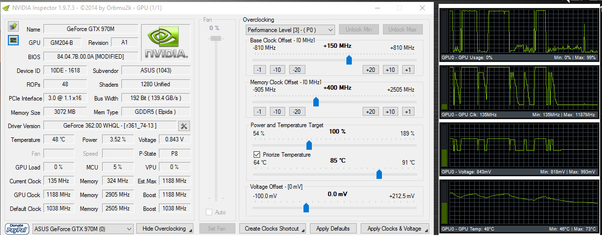

TheSwede86 Posted March 2, 2016 Author Share Posted March 2, 2016 10 minutes ago, Klem said: Yes, you need "0A". On the your last screenshot just type "y", and then program will flash it. Very strange. GPU-Z tells me my BIOS was "0A", when I started NVFLASH Toolkit and reflashed the GPU it told me I was already on "0A" but Nvidia Inspector told me I was on "0B". Anyway I reflashed and rebooted and can now go above +135 Thank you. Quote Link to comment Share on other sites More sharing options...
Bios Modder Klem Posted March 2, 2016 Bios Modder Share Posted March 2, 2016 Ok. Also after any flashing procedure, then good choice reinstall NVIDIA drivers with options "Clean Install". Can you now post new screenshot in NVIDIA Inspector? 1 Quote Link to comment Share on other sites More sharing options...

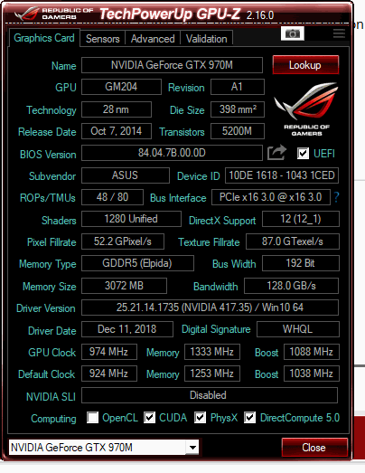

Marmoola Posted December 19, 2018 Share Posted December 19, 2018 HI there. im new and a noob. ive a G752vt gtx970m. i would like to overclock using vbios. anyone could assist? Quote Link to comment Share on other sites More sharing options...
Bios Modder Klem Posted December 19, 2018 Bios Modder Share Posted December 19, 2018 3 hours ago, Marmoola said: HI there. im new and a noob. ive a G752vt gtx970m. i would like to overclock using vbios. anyone could assist? Hi! Post here your stock vbios, I'll take a look. You can get vbios using GPU-Z utility, just mouse click on small icon with arrow, choice "Save to file". Quote Link to comment Share on other sites More sharing options...
Marmoola Posted December 19, 2018 Share Posted December 19, 2018 Attached as requested bro. thanks Quote Link to comment Share on other sites More sharing options...
Bios Modder Klem Posted December 24, 2018 Bios Modder Share Posted December 24, 2018 On 12/19/2018 at 5:04 PM, Marmoola said: Attached as requested bro. thanks You posted just screenshot, but I mean file vbios from your card. Quote Link to comment Share on other sites More sharing options...
