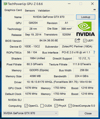

Just finished assembling Zotac GTX 970 e-GPU build based on Akitio Thunder2 box and have tried to test it with internal display using Optimus and Windows 10.
It seems like GTX 970 is recognized by Windows and starting without any problems, however when I'm running 3DMax Firestrike benchmark performance is very poor and I've got only 1347 scores just like using Intel Iris graphics. Here is a link for my recent results: http://www.3dmark.com/3dm/10641833
And my spec is as follow:
MBPr 15" (Mid 2014) Intel Iris only + Zotac GTX 970 + Akitio Thunder 2
Win 10 (Latest updates) and NVidia drivers ver.: 361.75
Any ideas what might be wrong?

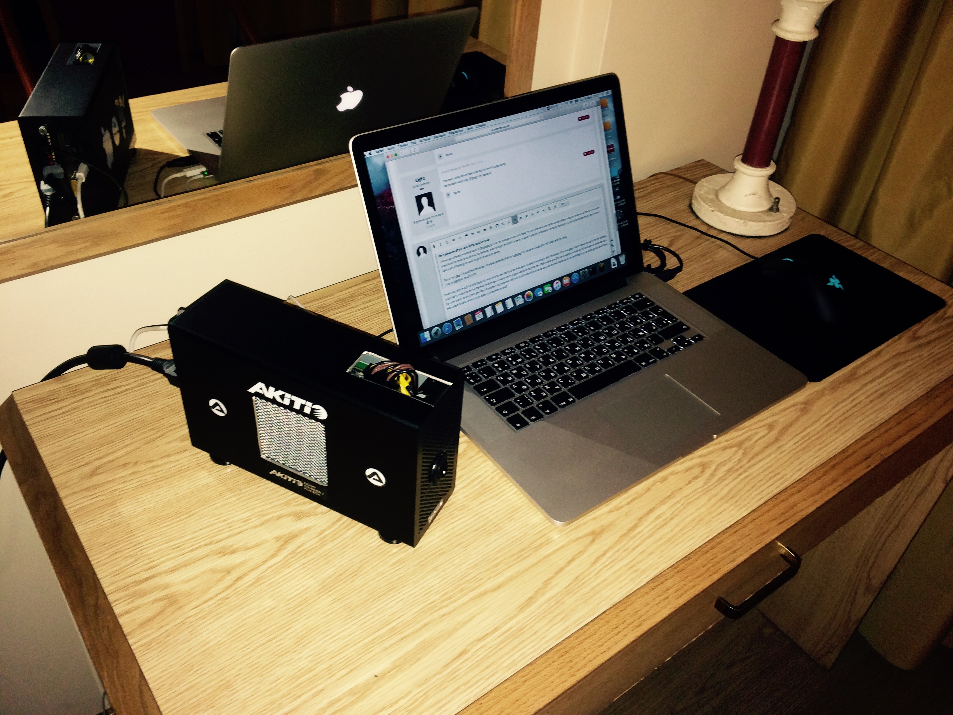

BTW, here is my box. I know, there are a lot of unnecessary stickers on it, but that was done on purpose to avoid questions like "what is that black box with plenty wires" when passing security checks at the airports.  :) However, looks like that didn't help much since had to pass separate check at Frankfurt yesterday when Akitio was placed on X-Ray scan's belt. :P
Not sure if it's worth to make a separate post for it, since it is not brining anything innovative to already well described guides from pioneers of DIY e-GPUs, but anyway I would like to give a huge thanks to Dschijn, HammerFET and other folks on this forum for posting their builds and answering my often silly questions during assembling. :)

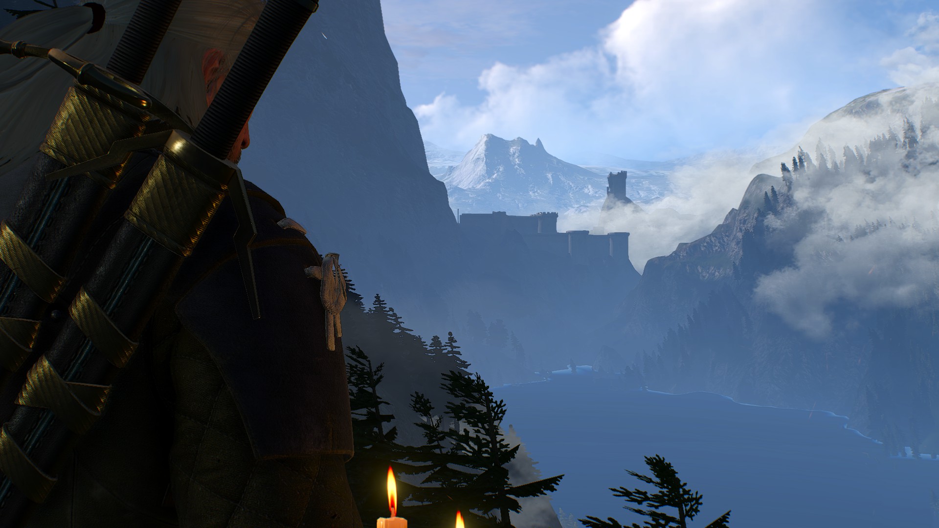

Ok, had to bring my first post up since another question appeared after some time of heavy gaming. :) Hopefully, somebody can give an a bit of help on my issue...
After about 60 hours of almost flawless Witcher 3 gameplay using both Optimus mode and External display have experienced several consecutive e-GPU crashes obviously caused by power failure, since  Dell DA-2 adaptor led is not showing any light indication after crash. In order to restart Akitio box have to unplug it from 220V socket and plug it again. Then, reboot Windows and everything works OK.
I didn't make any diagnostic yet since not sure where to start from but what was found, all crashes happened in different locations but with similar textures prevailing on screen which are looking very similar to haze. Attached screenshot was made just a moment before crash occured and upon restarting from saved game, another crash happened just on the same scene.
I haven't overclocked or changed any stock settings, the only alteration was made is custom e-GPU fan curve which is applied using MSI Afterburner. Akitio box is powered using Dell DA-2 adaptor and self made barrel plug. Any ideas what might be a cause of crashes will be much appreciated!
Thanks ! :)

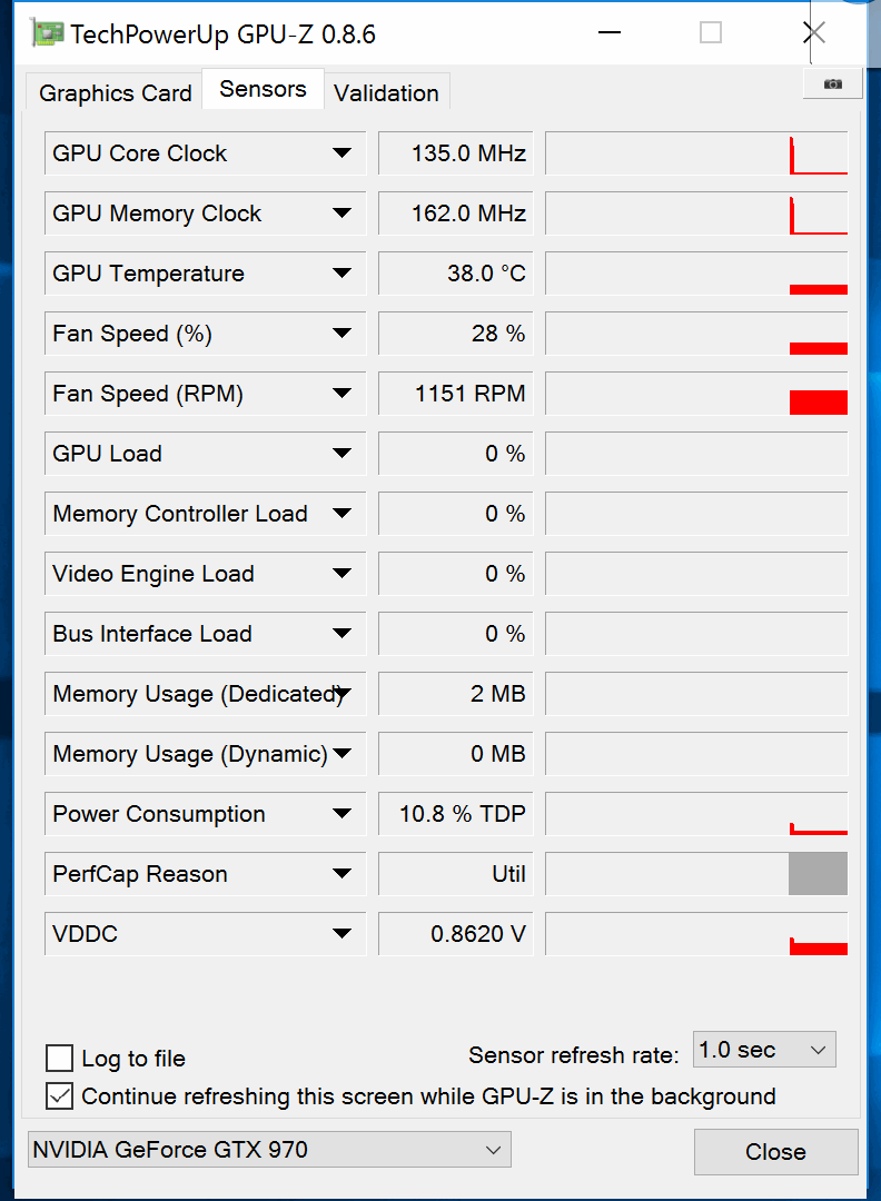

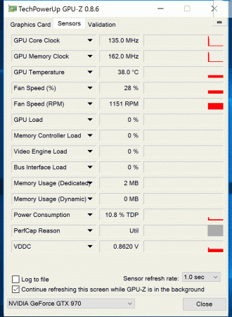

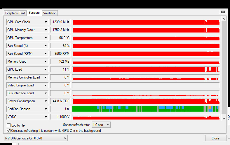

I'm using Zotac GTX 970 . Strange thing! I've just spent another hour in Witcher 3 in same location where I've experienced crashes before and today everything is running smooth. No problems... I was keeping MSI Afterburner and GPU-Z in background and made few screenshots of graphs.
The only thing that I've noticed is GPU power usage peak that was 113% at some point. Max GPU temperature 78, suppose that is normal.
Also, in GPU-Z prevailing PerfCap Reason during game session was Power restriction.
It might be a good idea to lower power limit as you advised above, however not sure if it is a case, since this time game was running stable in same locations without any adjustments... Will keep monitoring graphs and will post e-GPU behaivor in any further crashes.

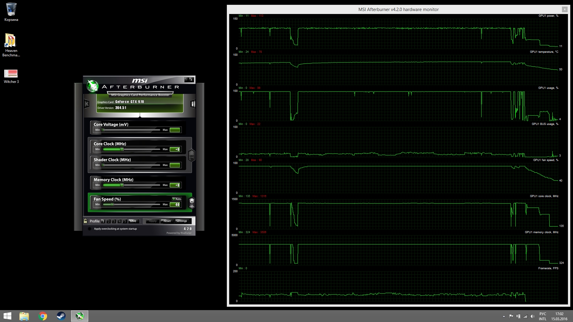

First run about 20 minutes - everything stable. What was found that actual GPU power usage is a bit higher then Afterburner settings, so sometimes it jumped up to 103%. Then, I've loaded location where I've experienced crash before and after 5 minutes in game e-GPU shutted down once again, same place, same textures...
I've managed to capture Afterburner screenshot just after crash occured, looks like a huge jump in power usage! :)
Now I'm wondering is it something wrong with Afterburner or is it more hardware related?...
