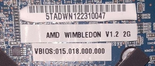

Anyway. I look at 7970M.
Will this card and bios work in my clevo?
Or this card will also need blind flashing?
Edited by pcmaniac
amdsd.jpg&key=45d7c56615a23b1f9c36b4ae277466f24dc37f67ee7a581e731c2cdc890fe9c9
The blind flashing procedure is always needed. There is no workaround, if you want to use the 7970m rev 1.2 in HM-Series.
