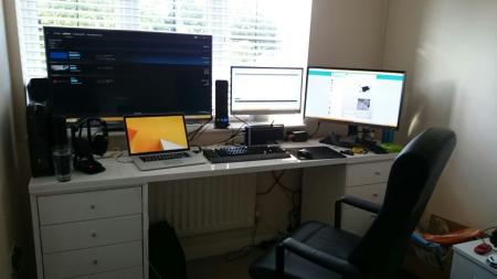

You may have seen my other thread where I got an eGPU working on my 2011 Macbook pro. Based on this success, I decided to take the plunge and do a full desktop replacement, replacing my own-build Alienware x51 desktop for a 2015 15" Macbook Pro with AMD discrete GPU.
Spec of desktop & new MBP
Item/Machine Alienware x51 2015 Macbook Pro 15"
CPU i5 3570k i7 4780HQ
RAM 16GB 16GB
Storage 128 SSD/750GB HDD 512GB m.2 SSD
GPU GTX 660 AMD R9 M370X + GTX 660

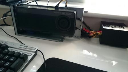

My previous build had me using my eGPU from a (poorly) made aluminium case for portability so that I could take the build on a flight to Sweden for the Dreamhack Summer 2015 festival. For this build, I knew I was unlikely to get nVidia Optimus running, so this eGPU would be primarily desk-bound. As a result, I opened my AKiTiO case to enhance cooling and provide a more secure implementation.

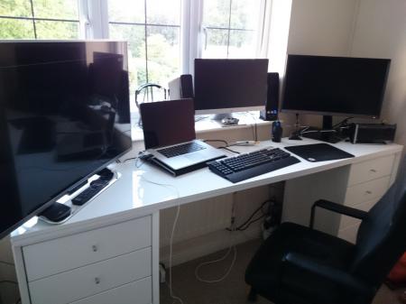

Re-worked desk & purchased a laptop-cooler:
