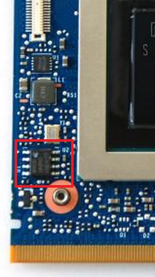

You need to de-solder the old chip, program a new chip and solder it to the board.
Desolder without hot air:
Solder:
Model of the vBIOS Chip: GigaDevice GD25Q20
Chip model and size: SOP8-150MIL (256kb)
Full dump file to program the new Chip attached
Location of the vBIOS Chip:
Chip programmer available from your location (order with DIP8 to SOP8 adapter) :
Nano USB Programmer for PC M B BIOS Repairing with Economic Shipping | eBay
GOOD LUCK! :)
