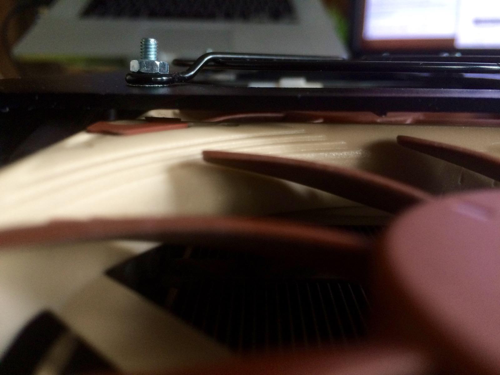

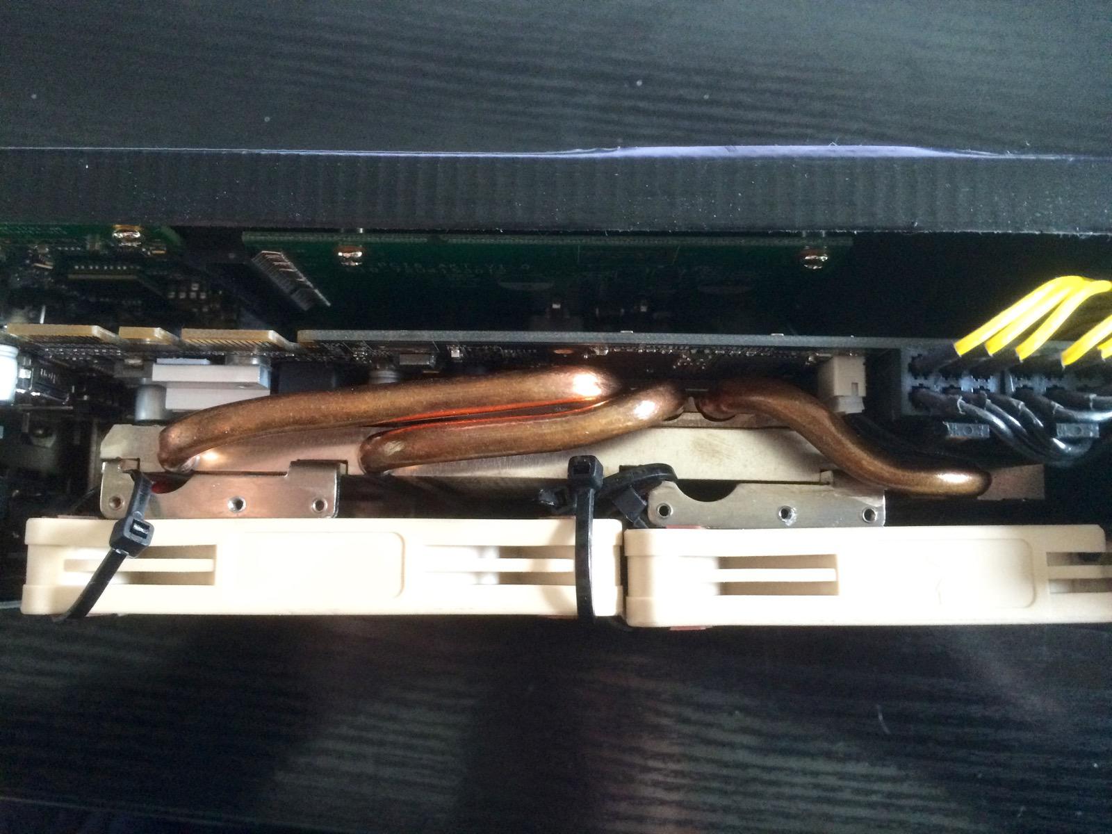

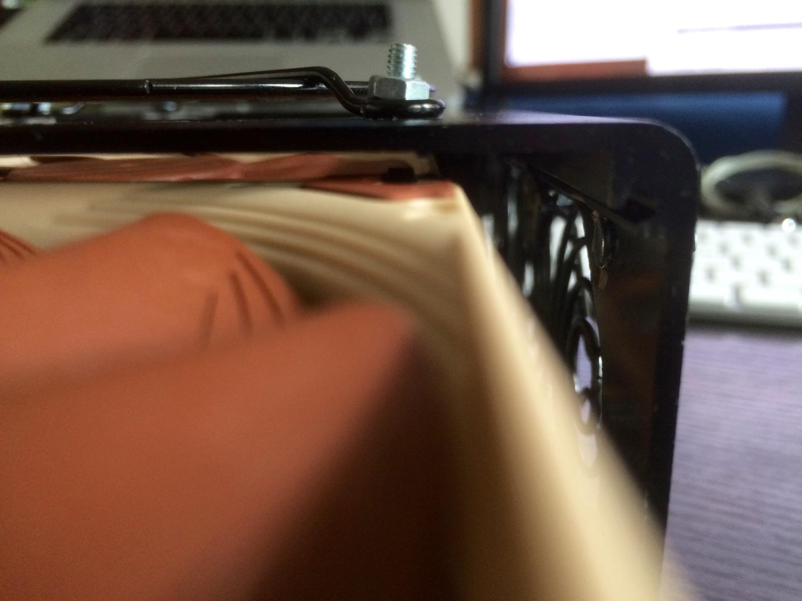

Here are some pictures that show how I attached the fans and how much space is between the fans <-> heatsink and fans <-> case:

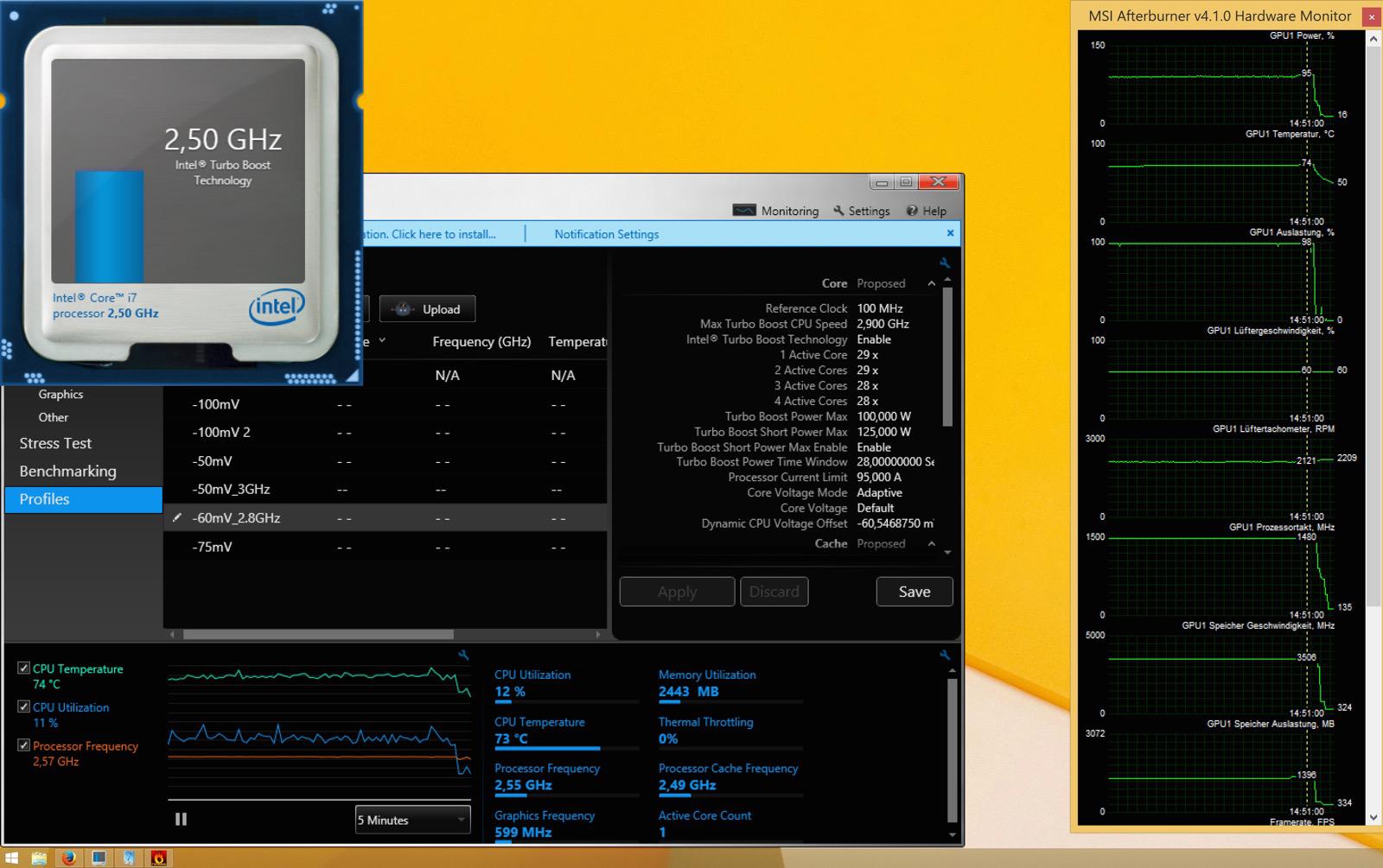

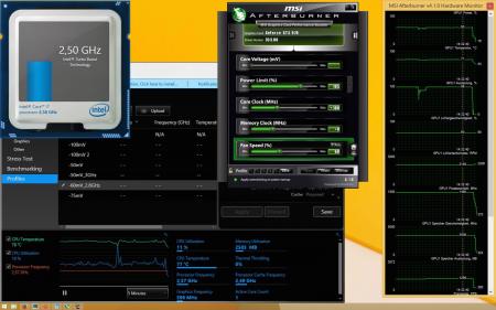

I tested with and without the outer case. The card was always sitting inside the inner cage. To be able to compare the tests I set the Noctua fans to 100% fan speed (60% PWM signal from the GPU) which is a bit more than 2100rpm.
Furmark 1600 resolution and 4x AA:
with case: Hitting 79-80°C temperature target -> throttling clock speed to sth aroung 1400MHz
without case: Hitting 79-80°C temperature target -> throttling clock speed to sth aroung 1400MHz
The Witcher 3 (settings from my gameplay video):
with case: temperatures between 72-73°C had one spike of 74°C after moving camera
without case: temperatures between 70-71°C
with case
withour case
With my owm fan profile I never get higher than 76°C (with case) and the fans stay below 2000rpm.

I did end up picking up a pair of the Noctua fans thinking that extra cooling is never going to be a bad thing. Unlike your setup on the Galax 970, the Zotac has 4 posts that the shroud connects too. The fans almost fit between these brackets, but not quite, so I've bent them out about 50 degrees and now the fans can be wedged in between the posts, which leaves me several millimeters of space between the fans and the outer case (not sure if that's going to be good or bad yet with drawing fresh air into the case). I have to wait probably until the end of the week until the PWM splitter comes in from Hong Kong before I can do any testing, but just wanted to say thanks for all the info and sorry for stealing your ideas! :36_002:

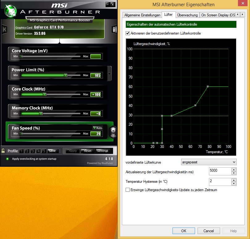

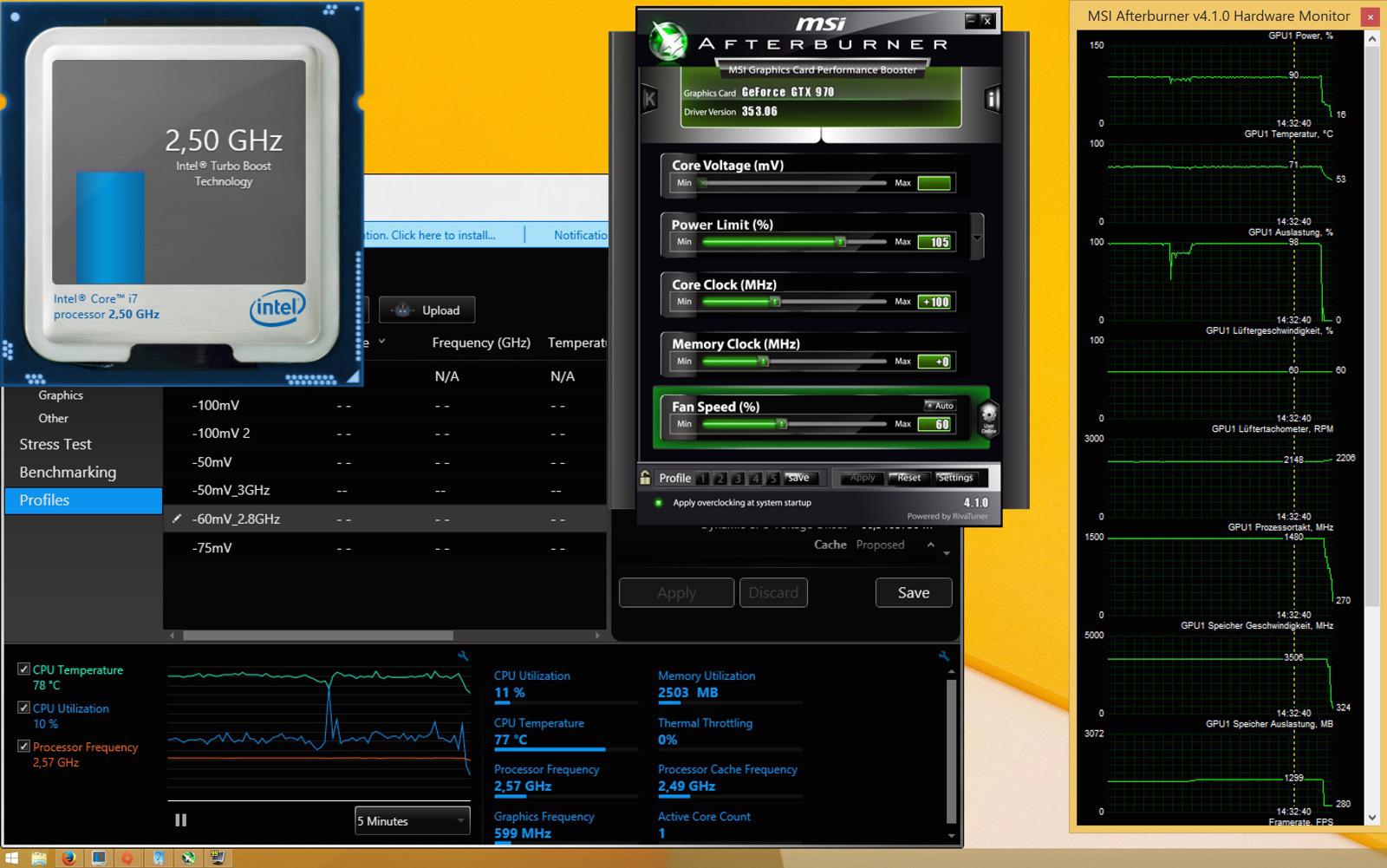

So I created a fan profile for my Galaxy card to control the fans between 30-60%. That fan profile is software controlled in Windows with MSI Afterburner.
If I boot into OSX the card is running on it's stock fan profile in the GPUs BIOS. What happens is that the stock fan profile is getting much faster to 60% fan speed signal (maybe at 60-65°C) and from that moment on the NOCTUA NF-A9x14 fans are at full speed.
The strange thing is... 60% fan speed signal should be 60% PWM signal, but the Noctua fans seem to get a 100% signal. What are the fans getting with a fan speed signal higher than 60%? How are stock fans controlled to work beyond 100% PWM?

This are my MSI Afterburner settings WITH the Noctua fans:
