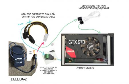

Dschijn Posted January 18, 2016 Author Share Posted January 18, 2016 You have to use an alternative PSU and should never use the AKiTiO PSU. The eGPU setup has 2 power inputs: - the GPU itself (side of the card with 6/8-Pin PCIe plugs) - the AKiTiO Powering the AKiTiO can be done by a powered riser (here you don't use the barrel plug) or a barrel plug (to be plugged into the back of the AKiTiO case), like you linked. Both ways have to recieve the power from the same PSU that is powering the GPU directly, so only use one PSU! The barrel plug you linked is good and you would only need a 2xmolex -> 6-pin PCIe y-cable, cut of the 6-pin and use the Molex plugs to connect to your PSU and the wires to plug into the barrel plug. http://www.amazon.com/Link-Depot-Express-Adapter-Inches/dp/B000JWTIKC/ref=sr_1_6?s=pc&ie=UTF8&qid=1453127843&sr=1-6&keywords=6-pin+pcie+molex I have no problems at all with my mini setup, it is even running overclocked and boosts over 1400MHz stable. The only thing is that it is hitting 80°C when running demanding games and is overclocked. Please keep in mind that you will have to use 90° low profile 6-Pin PCIe extensions if you want to close the AKiTiO with such a short card (available on eBay). http://www.ebay.com/itm/NEW-6-Pin-to-6-Pin-PCI-E-90-Degree-right-extension-w-low-profile4-USA-MADE-/261225911899?hash=item3cd247165b:m:mxGogGSSsz95lLh97DTDU0A The PSU looks fine. If you don't want to do the paper clip trick, you can get this one: http://www.amazon.com/24-Pin-STARTER-BRIDGE-WITHOUT-MOTHERBOARD/dp/B00K38IKRY Quote Link to comment Share on other sites More sharing options...
Lockbox30 Posted January 18, 2016 Share Posted January 18, 2016 41 minutes ago, Dschijn said: You have to use an alternative PSU and should never use the AKiTiO PSU. The eGPU setup has 2 power inputs: - the GPU itself (side of the card with 6/8-Pin PCIe plugs) - the AKiTiO Powering the AKiTiO can be done by a powered riser (here you don't use the barrel plug) or a barrel plug (to be plugged into the back of the AKiTiO case), like you linked. Both ways have to recieve the power from the same PSU that is powering the GPU directly, so only use one PSU! The barrel plug you linked is good and you would only need a 2xmolex -> 6-pin PCIe y-cable, cut of the 6-pin and use the Molex plugs to connect to your PSU and the wires to plug into the barrel plug. http://www.amazon.com/Link-Depot-Express-Adapter-Inches/dp/B000JWTIKC/ref=sr_1_6?s=pc&ie=UTF8&qid=1453127843&sr=1-6&keywords=6-pin+pcie+molex I have no problems at all with my mini setup, it is even running overclocked and boosts over 1400MHz stable. The only thing is that it is hitting 80°C when running demanding games and is overclocked. Please keep in mind that you will have to use 90° low profile 6-Pin PCIe extensions if you want to close the AKiTiO with such a short card (available on eBay). http://www.ebay.com/itm/NEW-6-Pin-to-6-Pin-PCI-E-90-Degree-right-extension-w-low-profile4-USA-MADE-/261225911899?hash=item3cd247165b:m:mxGogGSSsz95lLh97DTDU0A The PSU looks fine. If you don't want to do the paper clip trick, you can get this one: http://www.amazon.com/24-Pin-STARTER-BRIDGE-WITHOUT-MOTHERBOARD/dp/B00K38IKRY Here's the new list: - AkiTiO - Galax GPU - New PSU: http://www.amazon.com/EVGA-Continuous-Warranty-Supply-100-W1-0500-KR/dp/B00H33SFJU/ref=pd_bxgy_147_3?ie=UTF8&refRID=1H4397N7ZFWWKDGHB1D0 - The starter bridge: http://www.amazon.com/24-Pin-STARTER-BRIDGE-WITHOUT-MOTHERBOARD/dp/B00K38IKRY - The molex -> barrel plug: http://www.amazon.com/Link-Depot-Express-Adapter-Inches/dp/B000JWTIKC/ref=sr_1_6?s=pc&ie=UTF8&qid=1453127843&sr=1-6&keywords=6-pin+pcie+molex - 90 degree low profile 6-pin PCIe extension: http://www.ebay.com/itm/NEW-6-Pin-to-6-Pin-PCI-E-90-Degree-right-extension-w-low-profile4-USA-MADE-/261225911899?hash=item3cd247165b:m:mxGogGSSsz95lLh97DTDU0A Unless I'm not understanding the 90 degree extension correctly, how would I power the GPU with the case , closed? As in, how would my molex cable from the PSU connect to the extension inside the case? I looked at your recent setup, and would it be that red cable you have coming out the back of your case, but that looks like it's plugged into the barrel hole on the AkiTiO? Man, i feel like such a noob, thanks for everything again. Quote Link to comment Share on other sites More sharing options...
Dschijn Posted January 18, 2016 Author Share Posted January 18, 2016 You forgot the barrel plug Yes, the barrel plug with the red cable is what is pwoering the AKiTiO and the PCIe slot. Yours would come from the PSU and two of its molex plugs to your selfmade molex -> barrel adapter. The 90° 6-Pin plugs are necessary to beeing able to close the case! Thinking about that, you might need to extend the wires, since they would too short to bring out of the case. Please keep in mind that I used an external Dell DA-2 PSU and my wiring is a bit different. Maybe reading my basic guide would help you to understand most basics (but the thread is currently offline). Quote Link to comment Share on other sites More sharing options...
Lockbox30 Posted January 18, 2016 Share Posted January 18, 2016 (edited) 2 hours ago, Dschijn said: You forgot the barrel plug Yes, the barrel plug with the red cable is what is pwoering the AKiTiO and the PCIe slot. Yours would come from the PSU and two of its molex plugs to your selfmade molex -> barrel adapter. The 90° 6-Pin plugs are necessary to beeing able to close the case! Thinking about that, you might need to extend the wires, since they would too short to bring out of the case. Please keep in mind that I used an external Dell DA-2 PSU and my wiring is a bit different. Maybe reading my basic guide would help you to understand most basics (but the thread is currently offline). I don't understand how the 90 degree 6-Pin fits into this equation. Where would I plug it in at on the GPU, and where would I put the other end at? I guess the 90 degree angle part connects the GPU at the top, where shown at in diagram, and then loops around bottom of the case to connect to the PSU Molex cable (After removing back grill of to case fit cable). Also, does this PSU (linked above as New PSU, some reason when I paste link it shows a newer but it's not correct one) come with the 6-Pin PCIe Express to Dual 6-Pin and/or a 8-Pin PCIe Express 2.0 Cable (Or is it just called the PCIe cable). Thanks. Edited January 18, 2016 by Lockbox30 Edit Quote Link to comment Share on other sites More sharing options...
Dschijn Posted January 18, 2016 Author Share Posted January 18, 2016 Yes it would be like the white cord. Take a look at the image you posted. You can see that the ASUS card is as high as the case of the AKiTiO is. Now imagine plugging a plug into the card (where the green arrow points to). You will not be able to close the case because the white cable is perpendicular coming out of the card pointing upwards. There are two ways to solve this problem: 1. get a slimmer card (ASUS cards are very wide) and the edge of the card will be lower as the case 2. get a 90° PCIe cable to route the cable parallel to the card itself and not stick it out on the top Quote Link to comment Share on other sites More sharing options...
Lockbox30 Posted January 18, 2016 Share Posted January 18, 2016 3 minutes ago, Dschijn said: Yes it would be like the white cord. Take a look at the image you posted. You can see that the ASUS card is as high as the case of the AKiTiO is. Now imagine plugging a plug into the card (where the green arrow points to). You will not be able to close the case because the white cable is perpendicular coming out of the card pointing upwards. There are two ways to solve this problem: 1. get a slimmer card (ASUS cards are very wide) and the edge of the card will be lower as the case 2. get a 90° PCIe cable to route the cable parallel to the card itself and not stick it out on the top Yup, starting to understand now. Was i correct in stating where the 90 degree would go, and how the other part would flow under the card and be connected to the PSU Molex by removing the grill on the back of the case? Also, can you verify that the cable needed comes with the PSU i posted (Not the 90 degree cable, the 6-Pin, believe it is). Final checklist: - AkiTiO - Galax GPU - Molex to Barrel Adapter - 90 degree cable - Starter Bridge Adaptor (For Pin trick) - PSU (Linked above) Thanks, finally feel comfortable. Quote Link to comment Share on other sites More sharing options...
Dschijn Posted January 18, 2016 Author Share Posted January 18, 2016 Yes list is good, but you still need the molex -> 6-Pin PCIe (I think I am repeating myself… ). You don't want to cut the cable of the PSU, you want to use an ADAPTER in between. Quote Link to comment Share on other sites More sharing options...
Lockbox30 Posted January 18, 2016 Share Posted January 18, 2016 17 minutes ago, Dschijn said: Yes list is good, but you still need the molex -> 6-Pin PCIe (I think I am repeating myself… ). You don't want to cut the cable of the PSU, you want to use an ADAPTER in between. Ah, my mistake, I kept thinking that was the Molex to Barrel Adapter. Would this cable work? http://www.amazon.com/HDE-PCI-Express-Pin-Molex/dp/B002CZANA8 Where would this fit at now, or was it in the overview that I posted with the ASUS card? Quote Link to comment Share on other sites More sharing options...
Dschijn Posted January 18, 2016 Author Share Posted January 18, 2016 Yes that is good. You will have to cut off the 6-Pin. After that you will have 2x Molex plugs with wires (black and yellow). yellow has to go into the + side of the barrel plug with the screw terminals and black into the - side. The barrel side will than go into the AKiTiOs back side, the exact same spot where the original PSU would go in. The Molex plugs have to be plugged into the matching inverse molex plugs of the PSU. Quote Link to comment Share on other sites More sharing options...
Lockbox30 Posted January 18, 2016 Share Posted January 18, 2016 3 minutes ago, Dschijn said: Yes that is good. You will have to cut off the 6-Pin. After that you will have 2x Molex plugs with wires (black and yellow). yellow has to go into the + side of the barrel plug with the screw terminals and black into the - side. The barrel side will than go into the AKiTiOs back side, the exact same spot where the original PSU would go in. The Molex plugs have to be plugged into the matching inverse molex plugs of the PSU. Ah, understand now, I thought that cable was coming with the PSU. Final (Final) List: - AkiTiO - Galax GPU - PCIe 6 Pin - 2 Molex (Cut off both Molex heads, both yellow go in inverse positive, both blacks go in inverse negative) - 90 Degree Cable (Top of GPU, then wrap the remaining around the bottom of the case then connects to PSU outside of the back of AkiTiO case) - Starter Bridge Adaptor (PSU Paper Clip replacement) - PSU Man, I don't know how I can thank you Dschijn. I'll give you guys an update on how it goes after I order all the parts and set it up. Links for all products: AkiTiO - Akitio Thunder2 PCIe Box Galax GPU - http://galaxstore.net/GALAX-NVIDIA-GeForce-GTX-970-OC-4GB_p_32.html PCIe 6 Pin - 2 Molex - http://www.amazon.com/HDE-PCI-Express-Pin-Molex/dp/B002CZANA8 90 Degree Cable - http://www.ebay.com/itm/NEW-6-Pin-to-6-Pin-PCI-E-90-Degree-right-extension-w-low-profile4-USA-MADE-/261225911899?hash=item3cd247165b:m:mxGogGSSsz95lLh97DTDU0A&afsrc=1&rmvSB=true Starter Bridge Adaptor - 24-Pin ATX/EPS PSU JUMP STARTER BRIDGE, RUN YOUR POWER SUPPLY WITHOUT MOTHERBOARD/ MADE IN USA, GREAT FOR BTC RIG'S! PSU - EVGA 500 W1 80+, 500W Continuous Power, 3 Year Warranty Power Supply 100-W1-0500-KR Quote Link to comment Share on other sites More sharing options...
