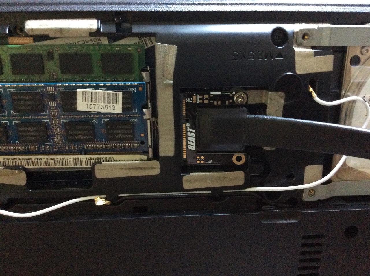

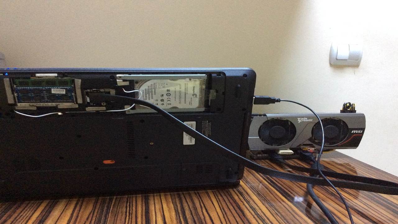

eGPU parts

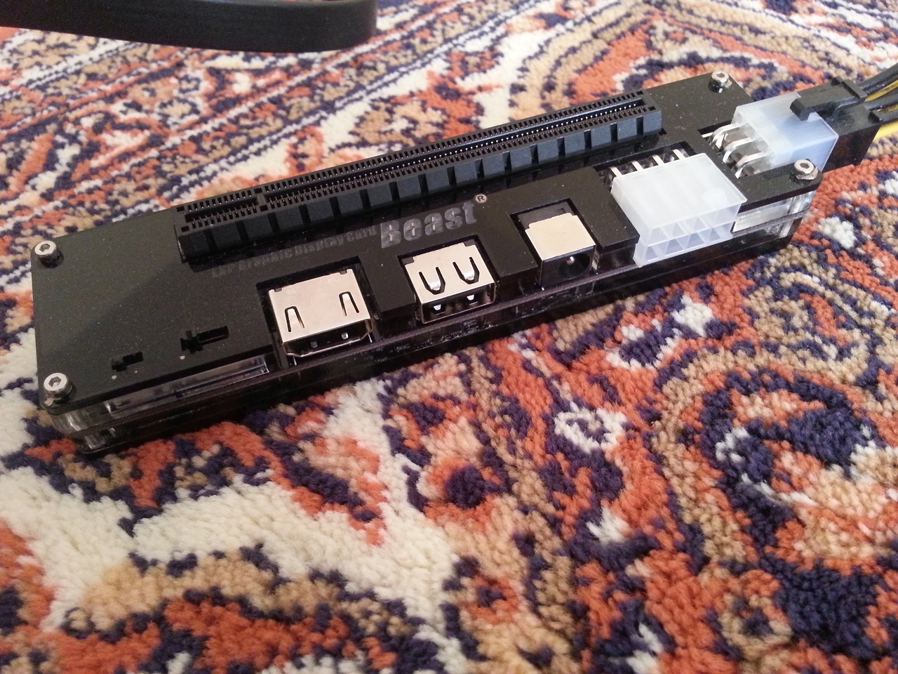

EXP GDC Beast mPCIe
220W Dell DA-2 AC adapter
2GB Zotac GTX670 Amp Edition
eGPU Setup 1.3 software
Nvidia Driver 350.12

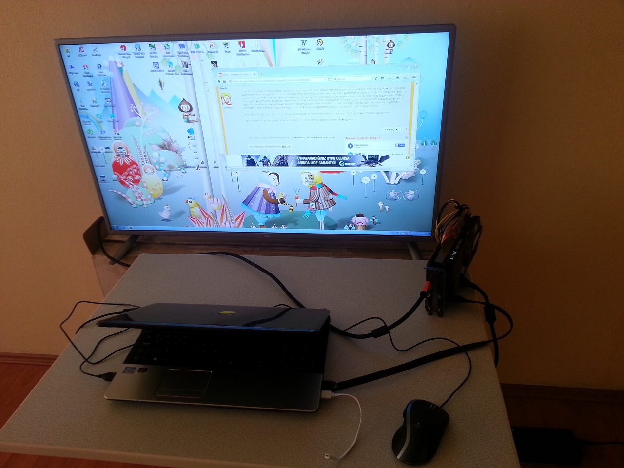

External monitor 42" LG 42LB580N

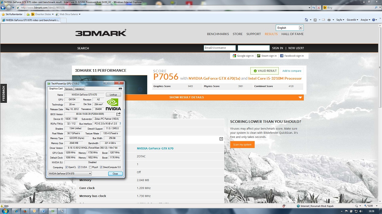

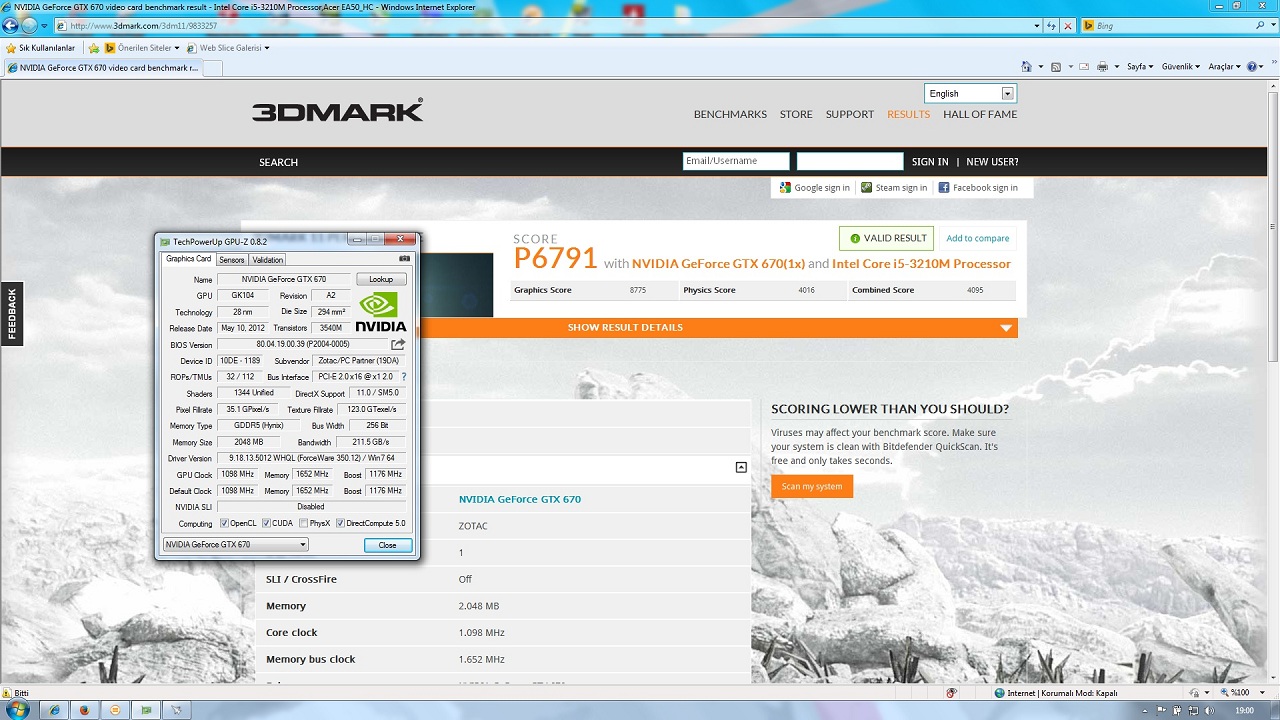

Benchmark results
3dmark11.GPU=8775
3dmark11.GPU=9403 (with +111 mhz core +156 mhz memory clock overclock)
with a friend's GTX970:
3dmark11.GPU=13366
3dmark13-FS.GPU=10901

one of the picture is with my old graphic card gtx 570
Videos (most in Turkish, the majority with the GTX570 + internal LCD. Only the last two with the GTX670 + external LCD)
