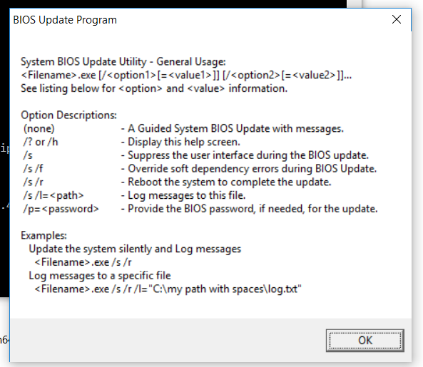

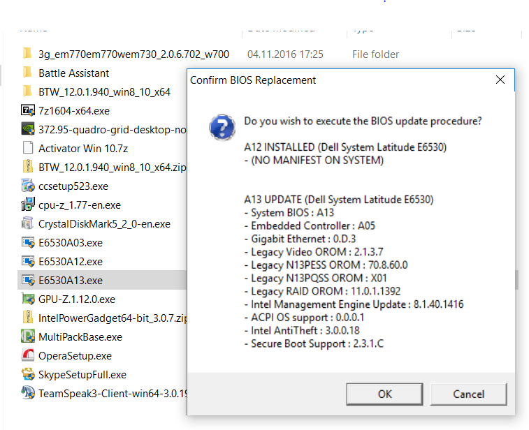

Oleksii_S Posted December 27, 2016 Share Posted December 27, 2016 (edited) Hello. Need help guys. I am stock. I have big problem with bios. I spend two days already. The deal is. I have Dell Latitude E6530 (he is the same like E6430). I had bios version A12. I need to upgrade bios to A13. I red that I need to downgrade to A03 than write A13. After successful downgrade I went to bios to switch SATA to AHCI. After apply this I got black screen. I wait 20 minutest and nothing changed. I turned OFF and On, and laptop didn't boot. I opened case to remove CMOS battery and I saw that battery cords are damaged. I live in small city. There is no Dell service. Local service found image of same laptop model and flashed it directly into bios chip. After this laptop boots normaly. But I can not upgrade or downgrade bios. I have same serial. but other mac address. Off bios runs well but after restart nothing happens. Under Windows 10 or DOS (pen drive) nothing works to write bios. I downloaded FPT from Noob section and i have backups of large bin and small bin. With UEFI Tool I check large bin and all regions are read/write. Here are screen shots of OFF flash utility How I can update my bios? I need this version (A13) for OS X. Only this version runs perfect with Mac OS. PLS help me. There is no information in Internet about my problem (((( Edited December 27, 2016 by Oleksii_S Quote Link to comment Share on other sites More sharing options...
Khenglish Posted December 28, 2016 Share Posted December 28, 2016 4 hours ago, Oleksii_S said: Hello. Need help guys. I am stock. I have big problem with bios. I spend two days already. The deal is. I have Dell Latitude E6530 (he is the same like E6430). I had bios version A12. I need to upgrade bios to A13. I red that I need to downgrade to A03 than write A13. After successful downgrade I went to bios to switch SATA to AHCI. After apply this I got black screen. I wait 20 minutest and nothing changed. I turned OFF and On, and laptop didn't boot. I opened case to remove CMOS battery and I saw that battery cords are damaged. I live in small city. There is no Dell service. Local service found image of same laptop model and flashed it directly into bios chip. After this laptop boots normaly. But I can not upgrade or downgrade bios. I have same serial. but other mac address. Off bios runs well but after restart nothing happens. Under Windows 10 or DOS (pen drive) nothing works to write bios. I downloaded FPT from Noob section and i have backups of large bin and small bin. With UEFI Tool I check large bin and all regions are read/write. Here are screen shots of OFF flash utility How I can update my bios? I need this version (A13) for OS X. Only this version runs perfect with Mac OS. PLS help me. There is no information in Internet about my problem (((( I had a similar problem too with a 6530. The system bricks when going various large BIOS version number upgrades when crossing the v13 barrier. I had to revert twice with a programmer. I submitted this info to Dell with no response. 1 Quote Link to comment Share on other sites More sharing options...
Oleksii_S Posted December 28, 2016 Share Posted December 28, 2016 I have opportunity to program my bios again. What bios file I need to take? Quote Link to comment Share on other sites More sharing options...
Khenglish Posted December 28, 2016 Share Posted December 28, 2016 1 hour ago, Oleksii_S said: I have opportunity to program my bios again. What bios file I need to take? If you made a backup flash that on. Quote Link to comment Share on other sites More sharing options...
