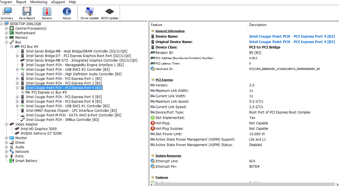

sulocanx Posted October 25, 2016 Share Posted October 25, 2016 (edited) @Mr_Western I tried everything but pcie bus only x1 1.1 I installed A11 bios mod and turn off dgpu(gt525m) on bios but this time I can't use internal screen I used setup 1.30 close dgpu after run pcie compaction and I can use internal screen. Performance is same. I tried disable nvidia hd audio but results same Pcie port support gen2 but runs gen1 Edited October 25, 2016 by sulocanx Quote Link to comment Share on other sites More sharing options...

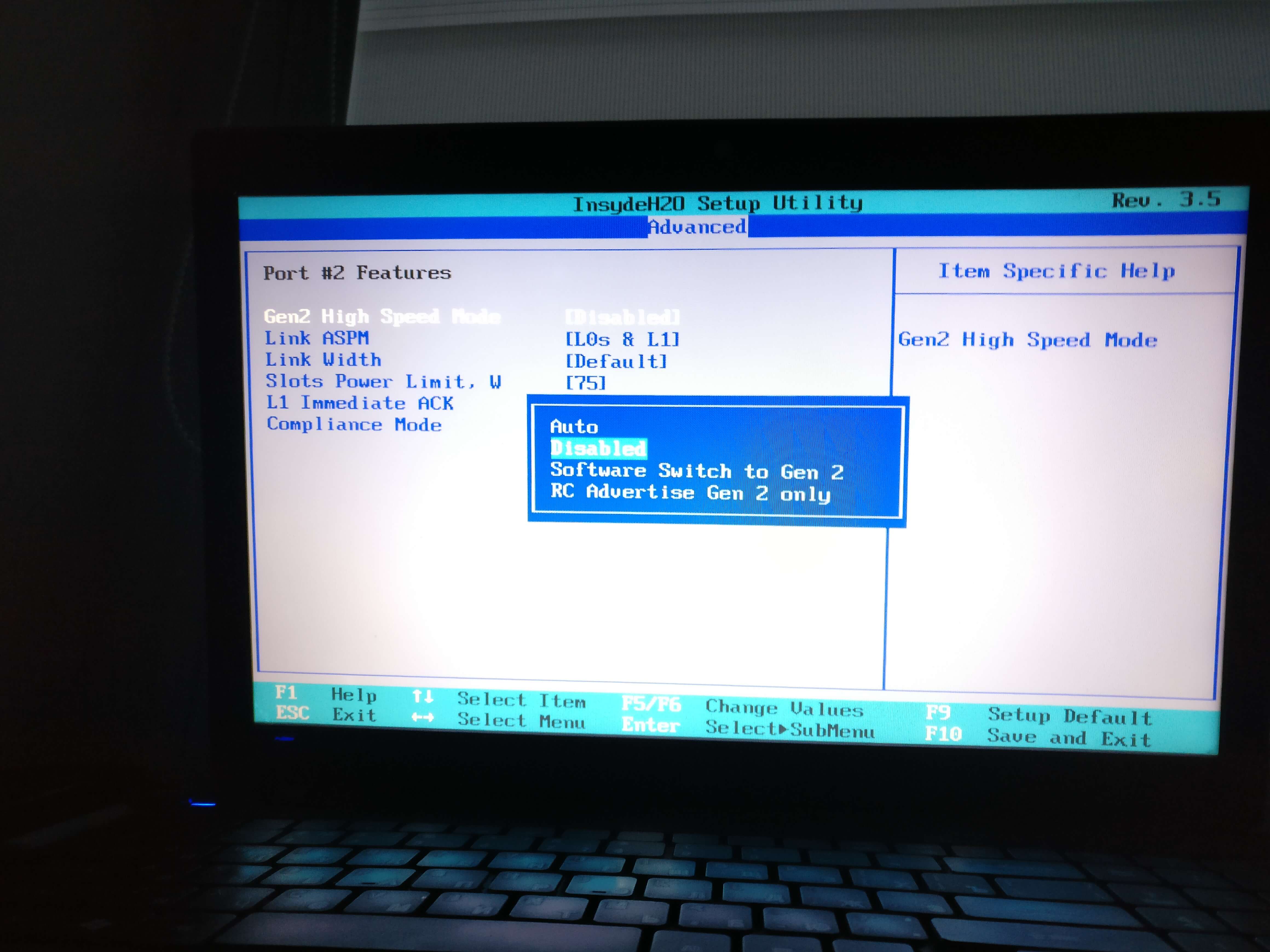

Mr_Western Posted October 25, 2016 Share Posted October 25, 2016 @sulocanx If you are running a modded BIOS, there should be an option to force gen 2 on the PCIe port, that's what I did on my laptop (however, I had 4 PCIe ports showing up in BIOS so I forced the first 2 to gen2). Strange that your laptop and my laptop has the same name for the BIOS, I am running a modded A11 BIOS on my XPS 15. However, I see you have setup 1.3, I have never used that before so I think it might be best to forward this concern to Nando since he stated that his software suppose to force Gen2 on the PCIe port even if the BIOS won't do it. But I am still seeing that gt525, if it was properly disabled and its drivers removed, it should not be visible by your system (windows would see it as a generic display device). Go to your device manager and change the "view" (the tab on top) to "Devices by Connection" Look for a heading marked PCI to PCI Bridge, there is multiple nests (heading, titles whatever you call it) of this, one of them should be nesting your iGPU (gt525) disable the whole nest (see attachment), I already disabled mine so you won't see it as having anything in it, but you will see yours with your iGPU in it.. If this does not open up your PCIe port to 2.0 instead of 1.1, maybe a driver needs updating. By the way, what software is that you using, I like it. Hopefully I am communicating properly with your, if there is anything mixing you up, feel free to point it out. Quote Link to comment Share on other sites More sharing options...

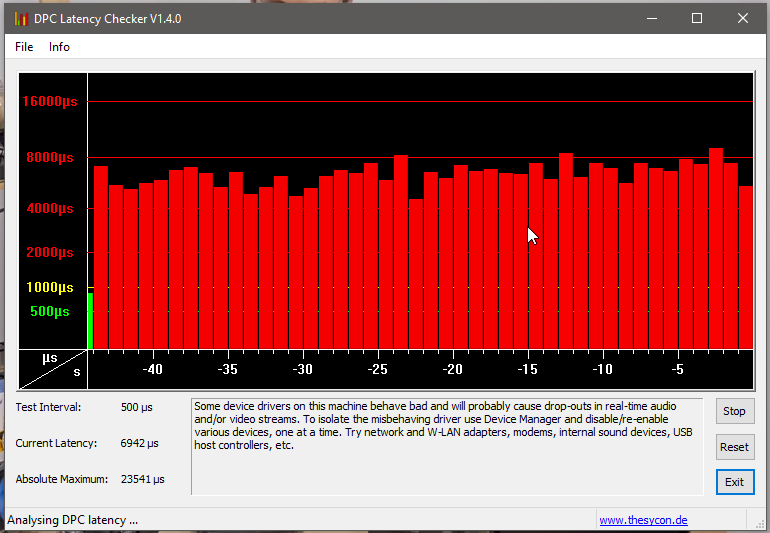

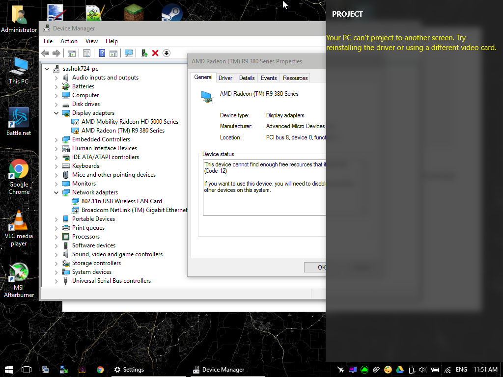

sashok724 Posted October 31, 2016 Share Posted October 31, 2016 Hi. I have Acer Aspire 5552g laptop with unlocked BIOS, EXP GDC v8.0 and AMD R9 380X GPU. I've also enabled PCI-E gen2 in bios settings on all ports The problem is, while GPU connected, i experience audio stutter and micro lags under any graphics activity Here is screenshot of DPC checker while just watching video on YouTube: I just don't know the cause of problem. Is it notebook, EXP GDC/it's cable, GPU or something else? What i can do to fix it? Sorry for my english, it's not my native language BTW: Is there any way to install newer graphics drivers? My notebook has Mobility Radeon HD 5470 dGPU, and latest driver that supports both eGPU and dGPU is Catalyst 15.11 beta Quote Link to comment Share on other sites More sharing options...
Tech Inferno Fan Posted October 31, 2016 Share Posted October 31, 2016 31 minutes ago, sashok724 said: Hi. I have Acer Aspire 5552g laptop with unlocked BIOS, EXP GDC v8.0 and AMD R9 380X GPU. I've also enabled PCI-E gen2 in bios settings on all ports The problem is, while GPU connected, i experience audio stutter and micro lags under any graphics activity Here is screenshot of DPC checker while just watching video on YouTube: I just don't know the cause of problem. Is it notebook, EXP GDC/it's cable, GPU or something else? What i can do to fix it? Sorry for my english, it's not my native language BTW: Is there any way to install newer graphics drivers? My notebook has Mobility Radeon HD 5470 dGPU, and latest driver that supports both eGPU and dGPU is Catalyst 15.11 beta Switch to Gen1 speed for the eGPU and test to see if it helps. EXP GDC is known to cause Gen2 instability with the AMD drivers implementing some fault tolerance which may express itself as high DPC latency. PE4C 3.0 with it's soldered capable providing a more reliable Gen2 link. The other things to try are disabling the AMD eGPU audio as well as disable the HD5470 where you'd use just a Basic Microsoft adapter instead. Quote Link to comment Share on other sites More sharing options...

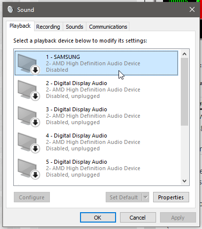

sashok724 Posted October 31, 2016 Share Posted October 31, 2016 Tried gen1, nothing changed. Same for disabling HD5470. To disable HDMI audio, i just need to disable it in sound settings like this? Quote Link to comment Share on other sites More sharing options...
Tech Inferno Fan Posted October 31, 2016 Share Posted October 31, 2016 Just now, sashok724 said: Tried gen1, nothing changed. Same for disabling HD5470. To disable HDMI audio, i just need to disable it in sound settings like this? Maybe. I disable devices in Device Manager. Also check if you have eGPU stuttering while being used. I had a problem with crosstalk on the eGPU adapter cable that gave such choppy results. Quote Link to comment Share on other sites More sharing options...
sashok724 Posted October 31, 2016 Share Posted October 31, 2016 You mean i should buy spare cable and it could fix problem? BTW, in BIOS, there are many options for gen2 which i don't understand. Which is best? The only thing i know is that gen2 is working on Auto Quote Link to comment Share on other sites More sharing options...
Mr_Western Posted October 31, 2016 Share Posted October 31, 2016 @sashok724 If I was you I would not give a damn about the laptop dGPU and outright disable it and uninstall the drivers for it. If you are going with an eGPU solution your primary goal should be having an environment most suited for your eGPU, this includes GPU drivers of the latest, not what is compatible with 2 different cards. So my advice, get rid of all drivers (except for your HD graphics drivers) using DDU (display driver uninstaller, free from guru3d) and reinstall the latest version of your eGPU driver. Make sure your intel drivers are up to scratch as well (chipset, HD graphics and intel audio [if applicable]). Quote Link to comment Share on other sites More sharing options...
sashok724 Posted November 1, 2016 Share Posted November 1, 2016 (edited) 8 hours ago, Mr_Western said: @sashok724 If I was you I would not give a damn about the laptop dGPU and outright disable it and uninstall the drivers for it. If you are going with an eGPU solution your primary goal should be having an environment most suited for your eGPU, this includes GPU drivers of the latest, not what is compatible with 2 different cards. So my advice, get rid of all drivers (except for your HD graphics drivers) using DDU (display driver uninstaller, free from guru3d) and reinstall the latest version of your eGPU driver. Make sure your intel drivers are up to scratch as well (chipset, HD graphics and intel audio [if applicable]). The problem is, while drivers is not installed for dGPU, eGPU is not working at all. And i can't disable dGPU completely (not just in device manager) because 'iport' is not working on AMD chipsets Edited November 1, 2016 by sashok724 Quote Link to comment Share on other sites More sharing options...

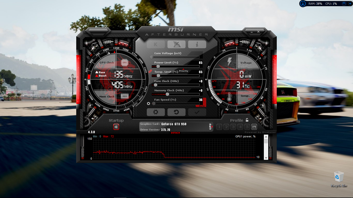

Mr_Western Posted November 18, 2016 Share Posted November 18, 2016 @n3uralhack3r My setup consist of the GTX 950 which does not have a power connector either (its an ASUS mini which you can check out here). Good news and a bit of bad news; in my experience it worked without the extra power connector for about an hour and then crashed (thats the bad bit) but the good news is that if you use MSI afterburner and down the power limit from 100% to about 85-90% it works without a problem. You should not get any performance difference with this reduced power so don't worry. Attached image related. Since I am here, has anyone been able to download Forza Motorsport Apex, I am getting a DirectX issue on the requirements section of the download page and as such not allowing me to download. See attached image... 1 Quote Link to comment Share on other sites More sharing options...

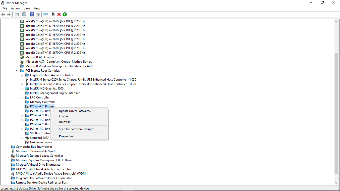

Mr_Western Posted November 20, 2016 Share Posted November 20, 2016 (edited) @n3uralhack3r Yes it is because you did not disable the laptop GPU. You don't really need a BIOS option for this as I don't have one. What I would suggest is to read this post, it will explain how to properly disable your laptop GPU using the device manager. Explanation starts at the third paragraph. Edited November 20, 2016 by Mr_Western Quote Link to comment Share on other sites More sharing options...
n3uralhack3r Posted November 21, 2016 Share Posted November 21, 2016 I tried the method above but still I get error 43.. did i miss anything? Quote Link to comment Share on other sites More sharing options...
