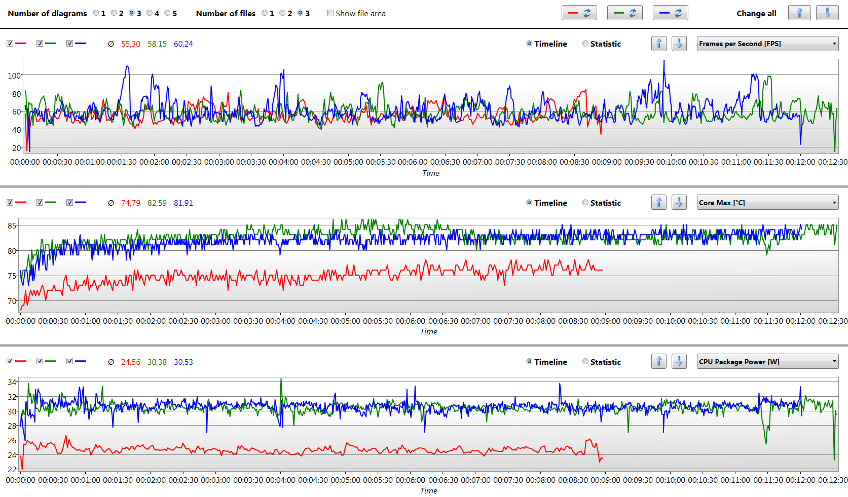

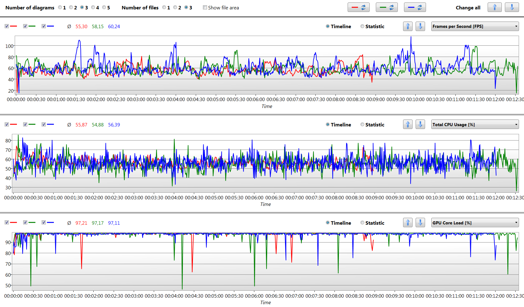

here You have comparison for BF4, multi, 64x64, paracel, medium + FHD. today gameplay for GTX760 only for ten minutes, tomorrow I'll try to run it for 12-14 minutes, then we will se if differences will be bigger or smaller. For now, we have mean differences around ... 8% between OC versions GTX760 and GTX680. In my opinion it is not worth of paying extra cash for GTX680.
red: GTX760 OC mini
green: GTX670 OC MSI TF
blue: GTX680 OC MSI TF
Another picture present differences in temperature and TDP between i7-3630 and i7-3632. In my opinion is really worth to get CPU 35W TDP instead of 45W TDP (or downcloch it to the level 35W TDP, as You like :) ). We can also detect that there is the same CPU and GPU utilization for both CPU's.

I was lucky to find a ASUS GTX670 mini. It's about 60% the size of my HD7970Ghz edition with a max 225W input power (vs 300W for the HD7970!!).
If you put your 35W CPU under extreme load (eg: linx) then you'll see Intel's turbo algorithm TDP throttle the 4-core turbo . It might go down to x27 or even less. For that reason I'd recommend getting a 45W TDP CPU to give more TDP headroom to play with. You have the flexibility of being able to use Throttlestop to limit the highest multiplier on a 45W CPU to bring temps down to 35W TDP CPUs if needed.
But take a look that even BF4 as a game focused on CPU, uses CPU almost barely (so I don't need a 45W TDP efficiency). I'll check how it works after cores unlock/parking.
