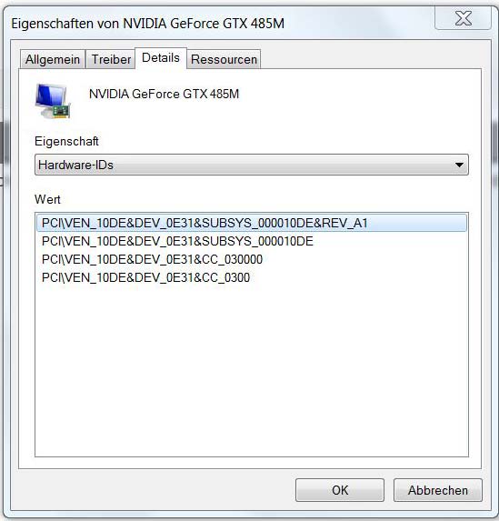

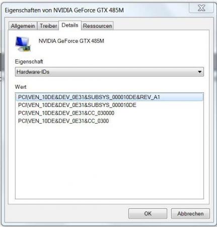

Borpf Posted November 10, 2013 Author Share Posted November 10, 2013 Wow!!! How Quick! Great!!! I take a Screenshot of it: Thank you very Much!!! Quote Link to comment Share on other sites More sharing options...
svl7 Posted November 10, 2013 Share Posted November 10, 2013 That's for the 331.65 driver, just replace the original .inf with the modified one and then run the setup.exe. Make sure that the driver signature check is disabled, else it won't install.nvcvn.zip Quote Link to comment Share on other sites More sharing options...
