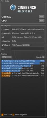

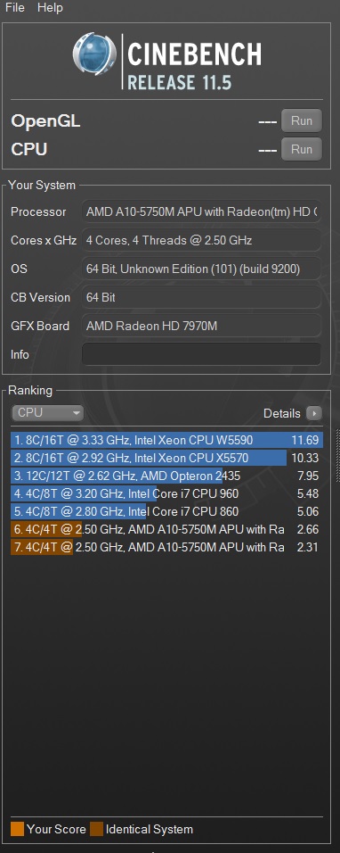

skidmarek 23 Posted September 20, 2013 Hey Kenglish We're trying out your method now and on the a10-5750m the cinebench improvement is impressive as you can see. The improvement is a little harder to see in games though, with it the cores basically all stay locked at 3.2Ghz, when idiling I see the first two occasionally bump up to 3.5ghz but not when used. Do you know if there's anyway to lock say two cores at 3.5ghz and two at 3.2Ghz? Quote Share this post Link to post Share on other sites

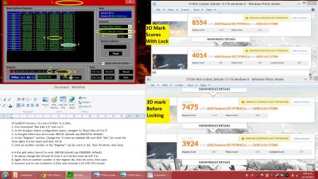

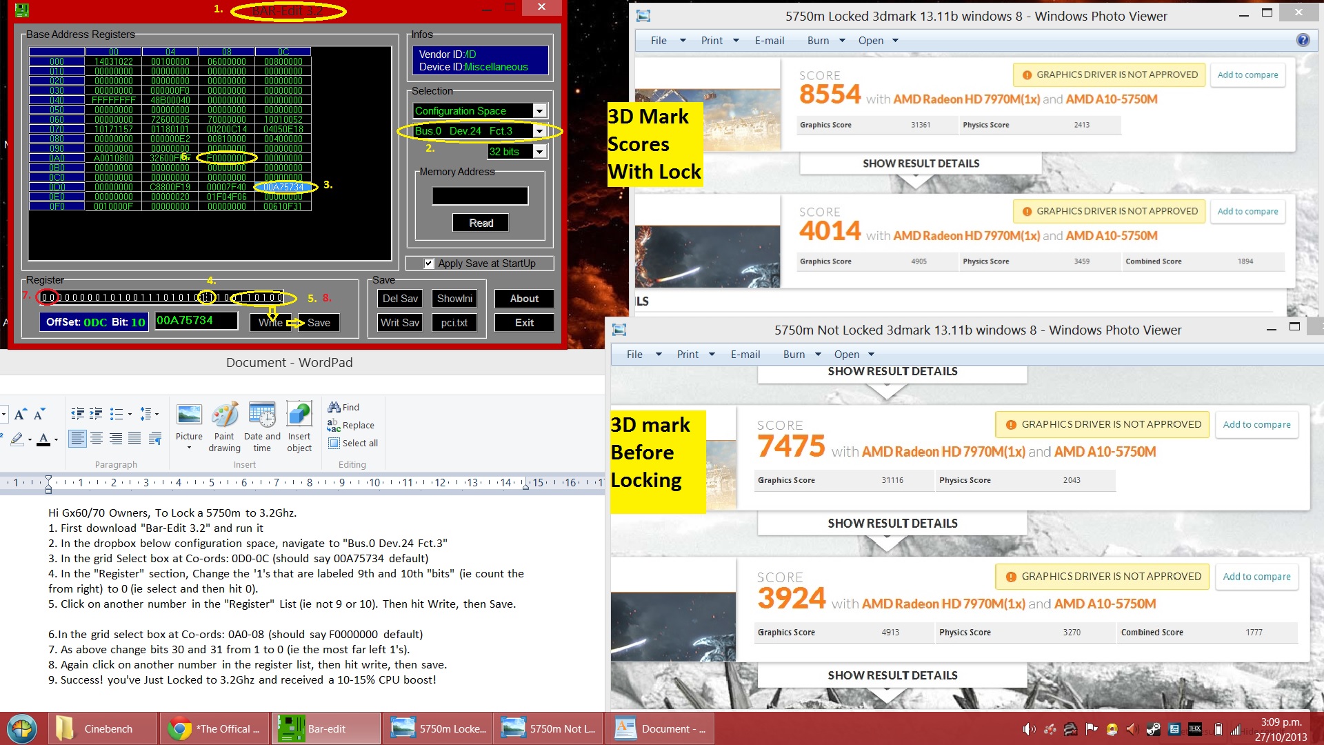

skidmarek 23 Posted October 27, 2013 Hi there Guys In case there's someone out there that wants an idiot-proof step by step guide of Kenglish's fix I've Made one and worked it into one picture: Enjoy! Quote Share this post Link to post Share on other sites

nyxzz92 10 Posted January 25, 2014 Hi there GuysIn case there's someone out there that wants an idiot-proof step by step guide of Kenglish's fix I've Made one and worked it into one picture: [ATTACH=CONFIG]9379[/ATTACH] Enjoy! Hate to ask, but I cant view that image. Can anyone post another link to it or something? I've been trying to get some better performance out of this horrible 5750m for months Quote Share this post Link to post Share on other sites
Chrack 11 Posted January 26, 2014 You need min. 5 post to see the picture or attachments. Gesendet von meinem GT-I9205 mit Tapatalk 2 Quote Share this post Link to post Share on other sites
