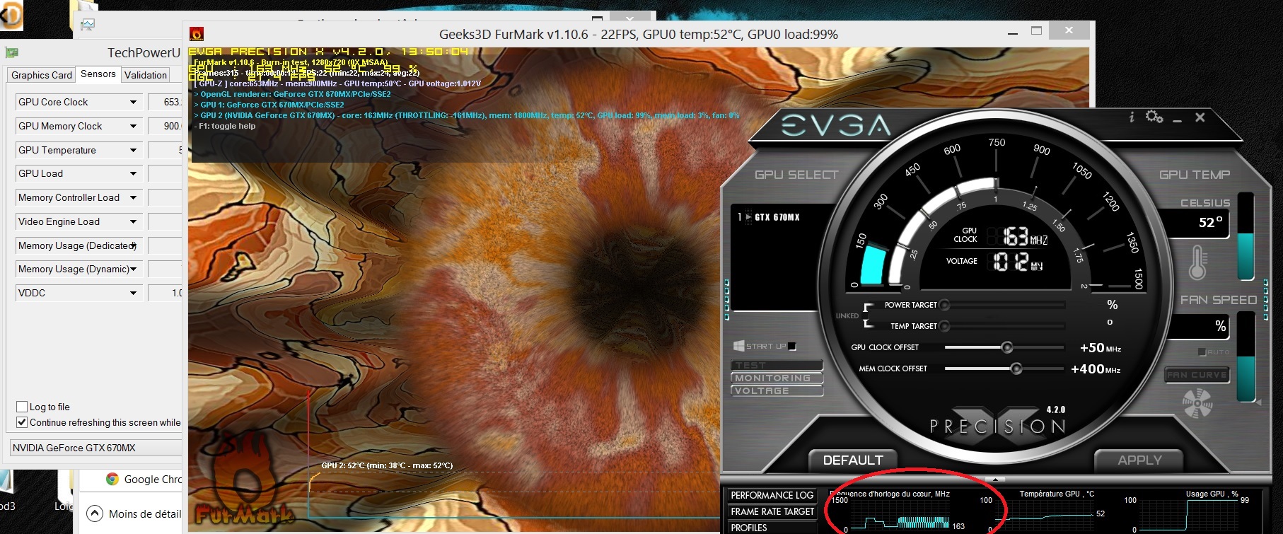

Hi! I have a msi gt60 0nc with 670mx/ i5 3230m
When i begin to overclock the GDDR more than 300/400mhz, i have this problem (see the picture)
Idem for the core
Do you know what's the problem?
P.S.: overvolt doesn't help
Yeah, your problem is FurMark. Don't use it, it's that simple. :)
I don't see any point in ever running FurMark, it stresses the voltage supply circuits of the GPU beyond a usual level and can effectively harm your card. Nvidia started to implement automatic throttling when such apps are run.
Try to run a game or 3dm11 at those clocks and I'm pretty sure you'll be fine.
