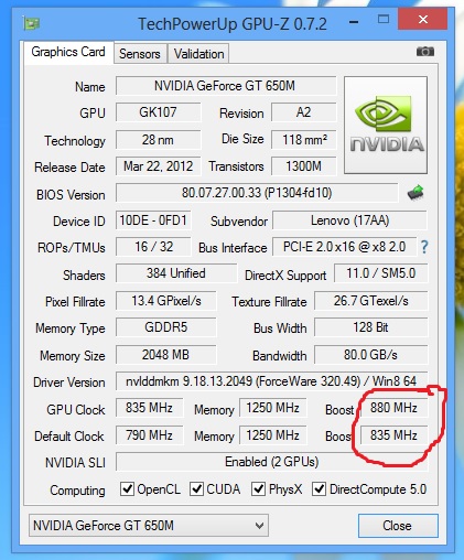

Hi, I have Lenovo Y500 GT650m Model. I don't understand my GT650m stock core is 790mhz and boost to 835mhz. ,I never see GT650m core speed run over 790mhz (I see in GPU-Z) , Even when overclocking The Values of core speed is up but speed is not up after Values. // My Bios version is 2.02 and Driver Nvidia Version is 320.49 // Sorry for bad Language I don't strong :'( Thank you.

GPU Boost is disabled for the 650M in the Lenovo. It's never worked for anyone.
[ATTACH=CONFIG]8383[/ATTACH] Thx for reply me. I don't understand because values in circle. How to GT650m core speed run over 790mhz. Thx for helps :'D
That's just a reporting error. Subtract 45 MHz to get your true core clock speed.
