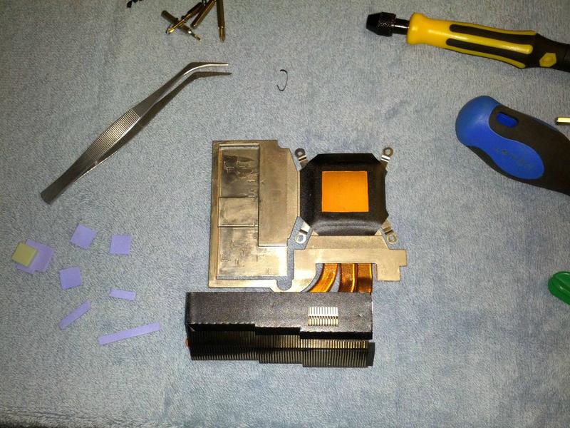

[75watt 660m heatsink modification]
Before I tore my laptop apart I had been told by Alienware that there was only one kind of Nvidia heatsink for the m18x, this is not the case as it seems.
For the 660m Dell made a different heatsink labeled "75w", it appears to use the same amount of copper and surface area but is molded slightly different to properly touch certain
parts of the card (power regs, voltage stuff, ect.). Along with that the area for the core to touch the heatsink is smaller and was designed for a lower resting GPU core
, so it required some tinkering to get it to work.
In this picture I used a razor blade to cut out a bigger surface on the copper base of the heatsink.

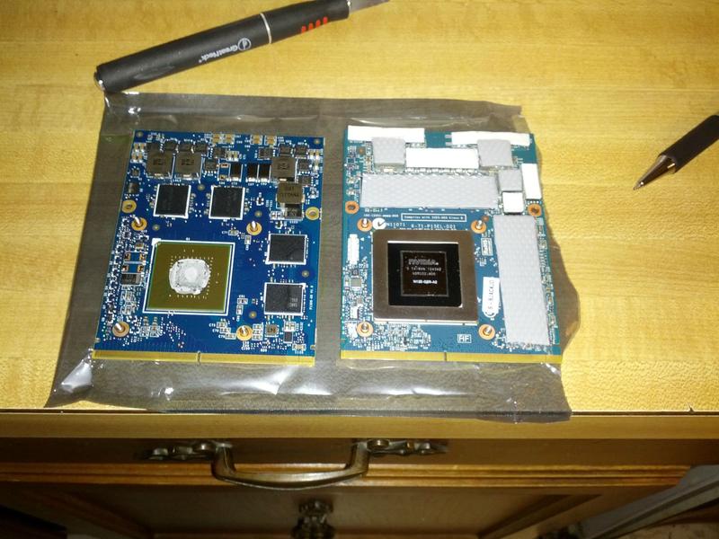

Pictured beside 660m for comparison.

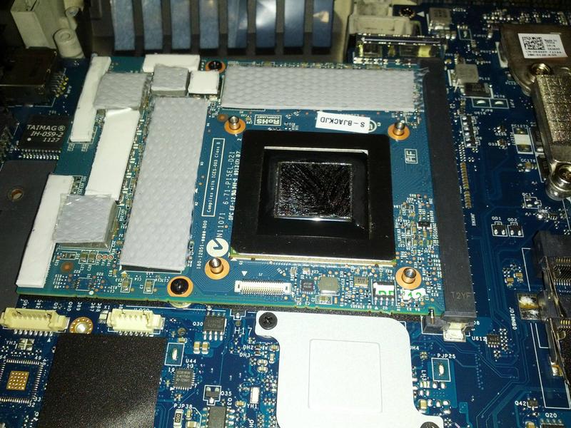

Installed into m18x, applied Liquid Ultra.
Applied heatsink, which allowed to you over tighten the screws because the core rests a good 2mm higher then the 660m so be careful!
Done!
Required heatpad thicknesses for use with 75w heatsink.
VRAM: 2mm
Square blocks (power regulators?): 1-0.5mm
Outer edge chips (voltage regulators?): 2mm
Temps are normal: 50-75C max

Hi Max, really appreciate for your post. I have a question. With the cut, is 75w and 100w heatsink identical?
The two heatsinks are not the same, the metal heatsink for the voltage and ram are different with different heights on certain raised parts to better fit the chip layout of the 100watt style cards.
You can still make it work though, just requires thicker heat pads in certain places. That's how mine is, never goes above 80C with an overclock.
[ATTACH=CONFIG]7249[/ATTACH]
Done!
VRAM: 2mm

i need to ask u question
i'm upgrading my m18x R1 gpu from the gtx 460m to the new gtx 780m and i have the 75w heatsink with the three plads of copper , and i checked the 780m and the 680 ram and electronic parts they looks almost the same so my question is (and excuse me for that question because i'm new to laptop upgrade ) what did u meant by cutting out a bigger surface on the copper base of the heatsink ? do u mean the area touching the main gpu processor or u men this small recessed afea on the main heatsink metal ? if u can mark it on the picture u post pefore i really appreciate that
