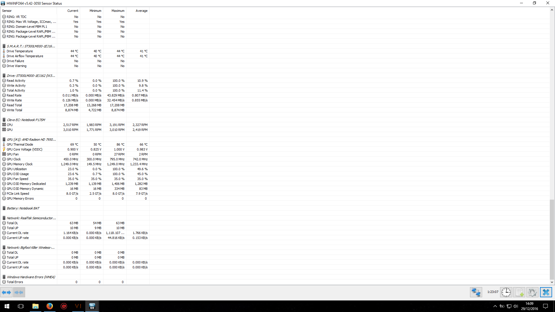

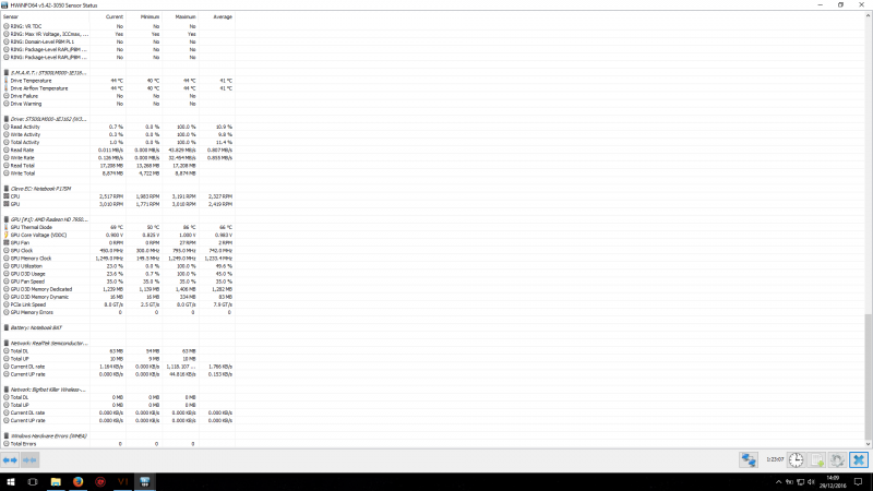

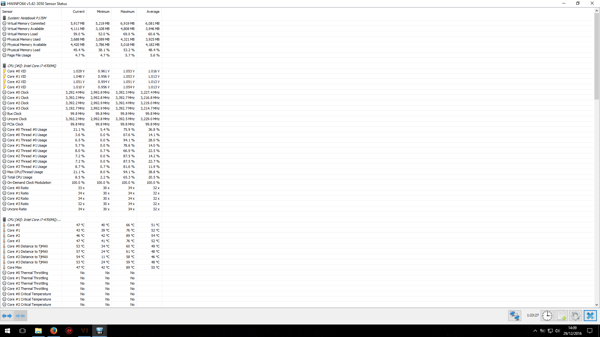

Keejteej Posted December 29, 2016 Share Posted December 29, 2016 Thanks, downloaded HWInfo and seems great utility. When using that I saw as shown below in images if they attach right. From what I read the cores and GPU do not seem too hot, but I am no expert. At the RPM's shown the fan is making a horrid whirring noise that irt never used to do, and is on the left of the laptop as you look at it, which I believe is the CPU fan. All has been cleaned out, the vents are all clear and everythign connected and free of dust. Any ideas or should I try to replace the fan? Or could I need to use new thermal paste (am not sure as temps do not seem high) Thanks all, have fun Anthony Quote Link to comment Share on other sites More sharing options...
