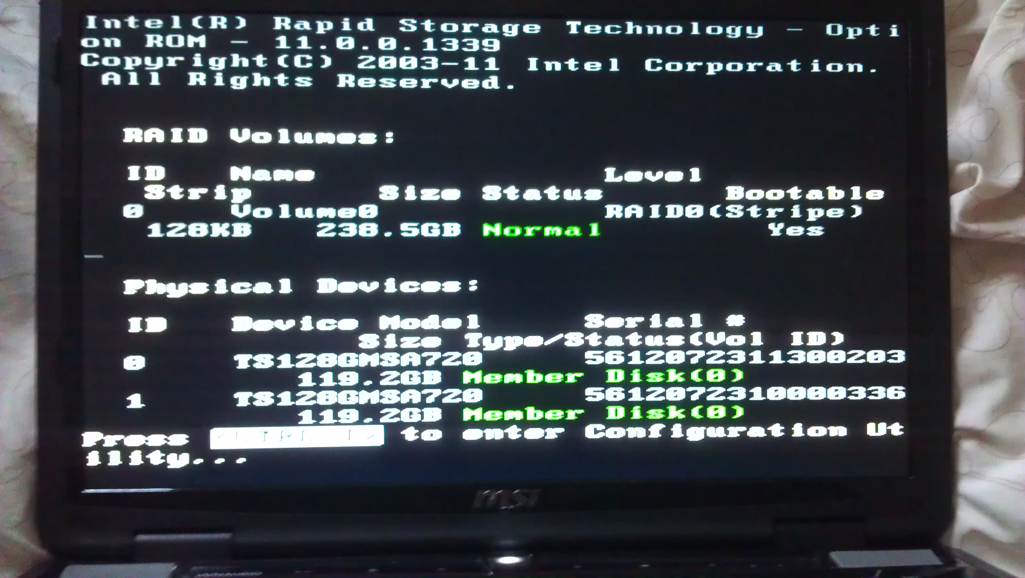

damitdang Posted March 3, 2013 Share Posted March 3, 2013 Hello everyone I'm in a very bad position atm I attempted to nvflash my vbios and realized that I flashed it with a wrong version used clevo instead of a msi vbios. I don't know what happened but after finally being able to get into Dos I nvflashed to Clevo 680m (80.04.33.00.10) 'OCedition' revised v01 rom(think thats where i messed up sighh).ctrl alt deleted and restarted with usb unplugged and now it stuck at the screen with intel rapid storage with disk info thats it.. It won't boot past that!! What did i do wrong? please help Quote Link to comment Share on other sites More sharing options...

damitdang Posted March 3, 2013 Author Share Posted March 3, 2013 Sorry guys it was late last night and I gave up.. Its still hanging at the intel rapid storage where it just shows my ssd and hard drive. I can't make it into boot recovery or bios what do i do? Quote Link to comment Share on other sites More sharing options...
Founder Michael Posted March 3, 2013 Founder Share Posted March 3, 2013 why can't you enter the bios exactly ?as far as i know that screen you showed is shown after the bios splash where you fan press a key to enter it. Unless it's different on the MSI and this is the first screen, highly doubt it though. Quote Link to comment Share on other sites More sharing options...
damitdang Posted March 3, 2013 Author Share Posted March 3, 2013 You're right its usually the bios splash then that screen then bios splash again.. but this time it just stuck at that screen. So far I've tried1) Blind Flash2) Clear EC3)remove all hdd then blind flashany other options you guys suggeest? and If i return it for a rma should i send it to xotic pc or msi.. and should i tell them the truth? and if anybody is available locally in houston,texas im willing to pay a good amount if you can fix it! Quote Link to comment Share on other sites More sharing options...
Founder Michael Posted March 4, 2013 Founder Share Posted March 4, 2013 you mean you turn it on and this screen comes up immediately?can you make a video of you turning it on ? Quote Link to comment Share on other sites More sharing options...
damitdang Posted March 4, 2013 Author Share Posted March 4, 2013 Yes I turn it on and that screen shows up.. To be exact that screen would show up but in normal size and font but after it loads a bit it enlarges to like 150% and stays on that screen. Quote Link to comment Share on other sites More sharing options...
