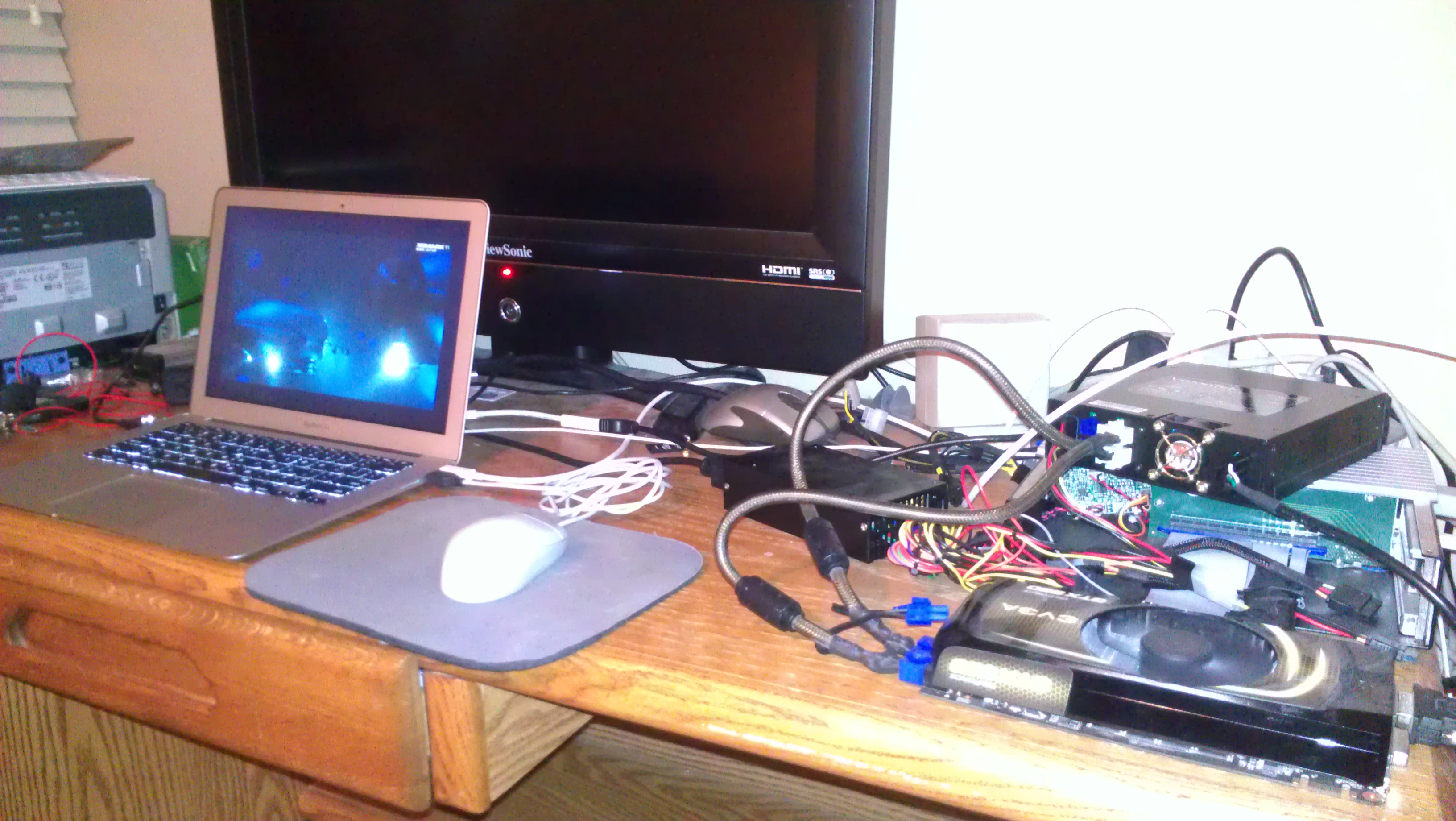

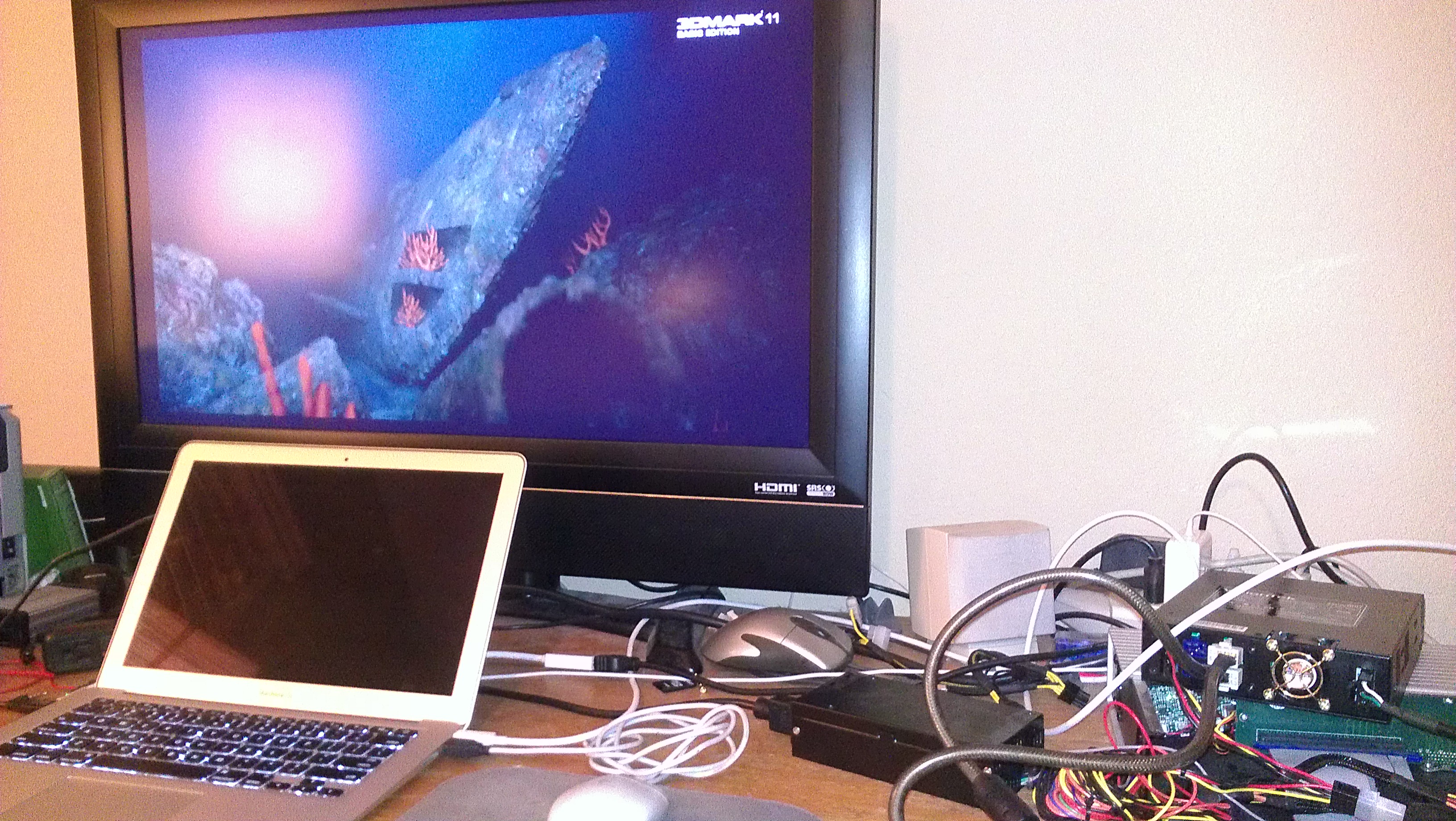

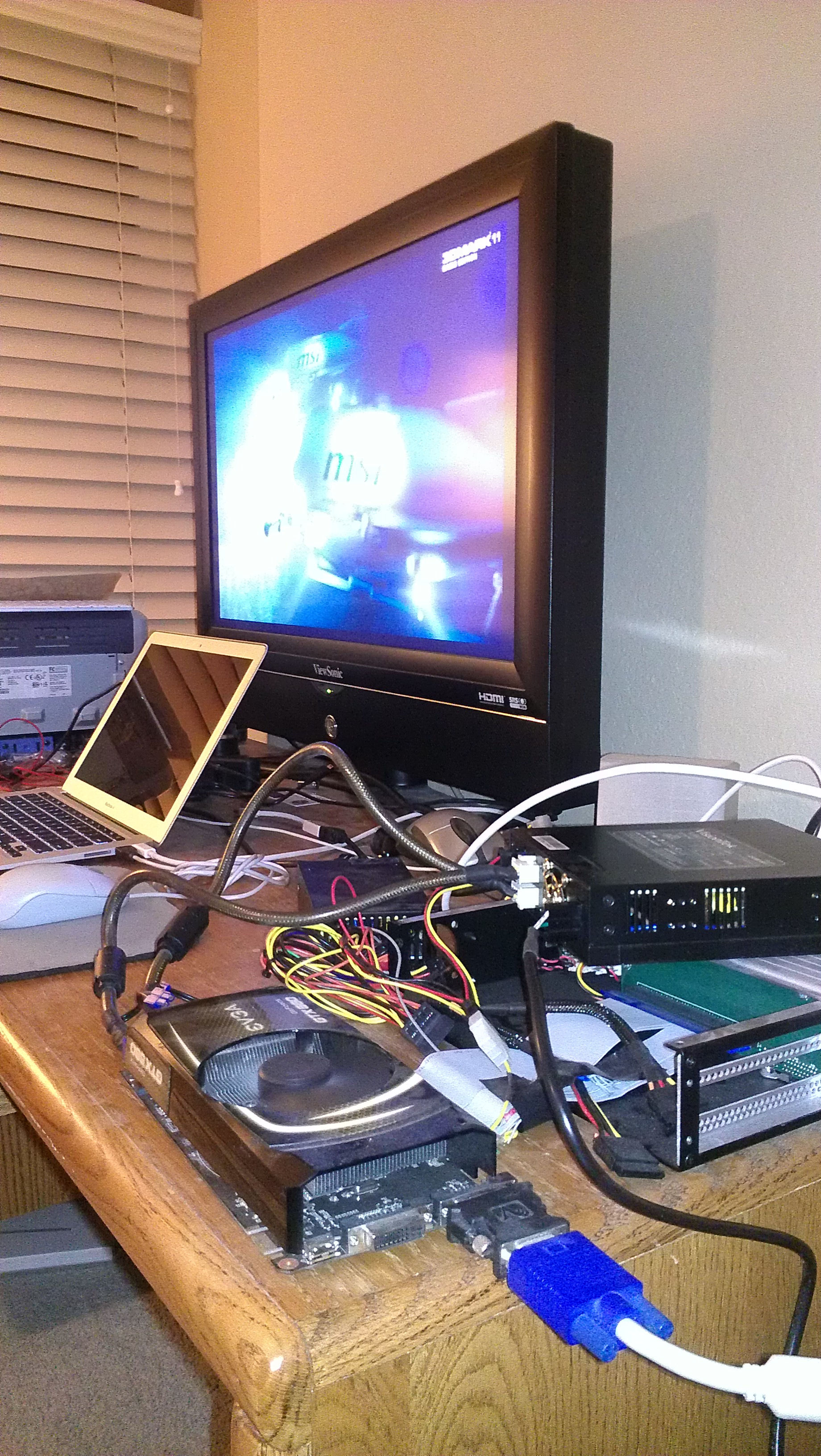

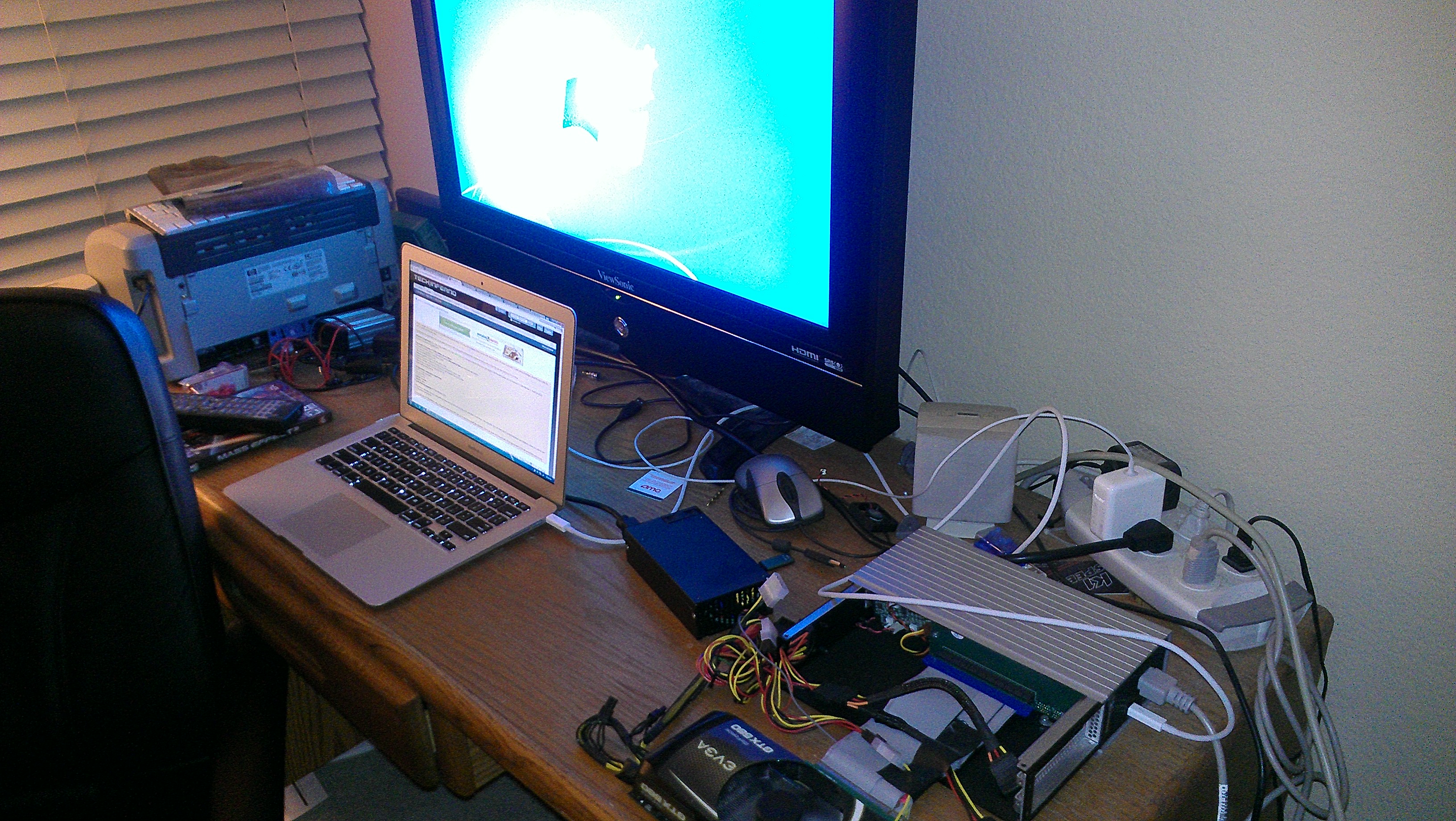

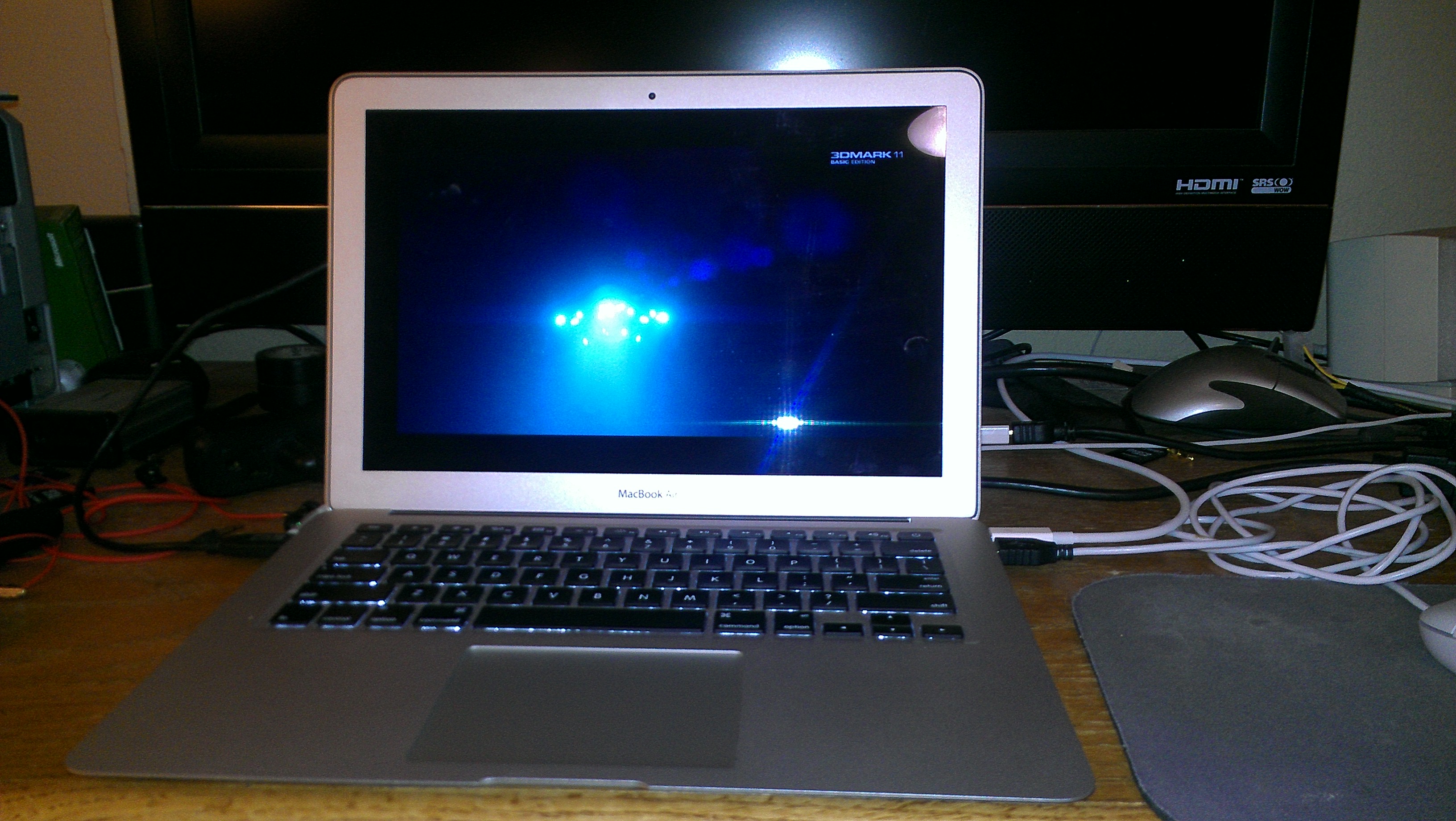

borealiss Posted January 11, 2013 Author Share Posted January 11, 2013 problem was a power delivery issue. new PSU solved the problem. optimus and external monitor both work flawlessly in bootcamped win7. here some pics of both optimus and external monitor. 1 Quote Link to comment Share on other sites More sharing options...

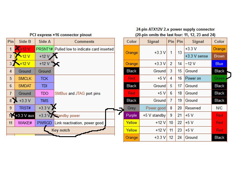

MystPhysX Posted February 15, 2013 Share Posted February 15, 2013 1) Since I'm using a sonnet chassis, I do not have control over pcie powergood pin, like people with the th05. It seems the th05 allows them to delay the assertion of this signal to the pcie card, which effectively tells the egpu when to come out of reset.The way i had to work around this was to use a pcie extender cable and completely isolate all the power rails to an external powersupply. I also hooked up pcie powergood to atx powergood. The i insert the card into the cable, and cable into the chassis.Hey a little help needed. How did you manage this? I'm currently using the OWC Helios with an HD7950, rMBP and a 650w PSU which provides 53A on the 12v rail and I'm pretty sure I have the same problem. When I plug the Helios into to rMBP the fans on the HD7950 spin up but it doesn't show up in Device Manager. The Helios provides about 90w along the PCIe connection and I've confirmed that the HD 7950 is using that power by noticing that the fans on the card still spin after disconnecting the card from my 650w PSU.*edit - Forgot to mention that if I plug in the Helios and GPU before Win 7 boots up it hangs; had the same issue with Win 8. When I plug in the Helios without the GPU an entry in Device Manager shows up under the name "Thunderbolt" and states that there are no drivers installed. Pics on Imgur because T|I isn't letting me upload them for some strange reason. http://imgur.com/SChSVfw,WsPBNsS Quote Link to comment Share on other sites More sharing options...
borealiss Posted February 16, 2013 Author Share Posted February 16, 2013 You're not going to be able to get the eGPU to boot with BIOS emulation using bootcamp if it is plugged in from cold start. You need to do something to delay the assertion of the powergood pin on your card.Check out PCI Express - Wikipedia, the free encyclopediaThe PWRGD pin is the one I hooked up to from my ATX powersupply to the pins on the PCIE board. ATX - Wikipedia, the free encyclopediaIt's the grey pin I believe. Just to double check, you should take a digital multimeter and probe the PWRGD pin on your Helios to make sure it's the same 5V supply as the ATX powergood signal. I didn't do this and plan to. Online references suggest these are the same power rails in a system, but it's never too good to be safe versus blowing up something on your card.You also need to wire up your ATX powersupply so that it can be switched on without being plugged into a motherboard.How do I manually turn on an ATX power supply? | techPowerUpI had to use an interposer/extender cable to tap into all of the powerlines on pcie pins 1-11, sides A and B. So my eGPU is completely power isolated from my sonnet adapter. You will have to do something similar, as well as hook up the powergood pins. Your ATX powersupply should also drive any auxiliary power to the card via molex or pcie power connections (sideband). This way your ATX/external powersupply coordinates the poweron sequence for your eGPU.You will then have to have your Helios connected at cold start, but have your powersupply turned off. Once you hold down OPTION to boot into windows, wait 4-5 seconds then power on your eGPU via powersupply.One thing I do here is install the DIY egpu software so that when the windows boot menu comes up, I can go into the egpu software setup and scan to see if the eGPU got enumerated and is present. If it didn't, just power off your powersupply, wait a few seconds, and turn it on. Then hit F5 to rescan. Once you get the timing down, this can become unnecessary. Once you've verified that it's detected, chainload your MBR and boot into windows.This whole process usually takes me about a minute to do whenever I enable my eGPU.Unfortunately, until a thunderbolt chassis manufacturer provides a way to assert/deassert or delay the assertion of PWRGD on the PCIE interface, this is the only workaround I know of. It also has the detrimental effect of screwing up the form factor of the chassis, but at least with BIOS emulation you get a 100% working optimus solution with nVidia graphics cards. I have taken this setup on the road, and my sonnet/egpu/psu setup fits very nicely in a small tote bag. It is awesome.You might want to give the EFI BIOS installation method a try. Booting via EFI allows you to bypass the power isolation workaround because the EFI BIOS that windows uses properly enumerates the graphics card and you will not get the hanging you see when you boot up with the eGPU plugged in with bootcamp.Good luck. 1 Quote Link to comment Share on other sites More sharing options...
MystPhysX Posted February 16, 2013 Share Posted February 16, 2013 Thanks for the info, I'm going to try it your way. From what I understand though you did as marked in the attachment, but what about the ones marked with an "x"? Where did you connect them on your PSU? Quote Link to comment Share on other sites More sharing options...
borealiss Posted February 19, 2013 Author Share Posted February 19, 2013 I connected the 12V line up to one of the power rails on the ATX power supply. I connected the 3.3V line up to a SATA power connector.Honestly, if you're willing to cannibalize an ATX PSU, you can just hook it all up directly. Look at the ATX pinout and PCIE pins 1-11. The 3.3V lines on the pcie interface can be hooked up directly to the ATX PSU, you just need to do some soldering, or wire wrapping. Same with the 12V lines. If you don't want to sacrifice a PSU, get an ATX PSU extender cable, and splice into that. The wiring loom shouldn't take more than maybe an hour to make.This is the cable I used to splice into everything, so I don't void the warranty of the thunderbolt chassis.Google Image Result for http://image.ecbub.com/productd/937/5379976_1.jpg 1 Quote Link to comment Share on other sites More sharing options...
