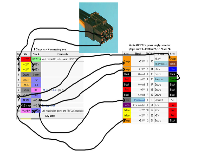

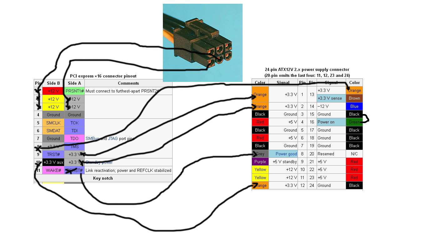

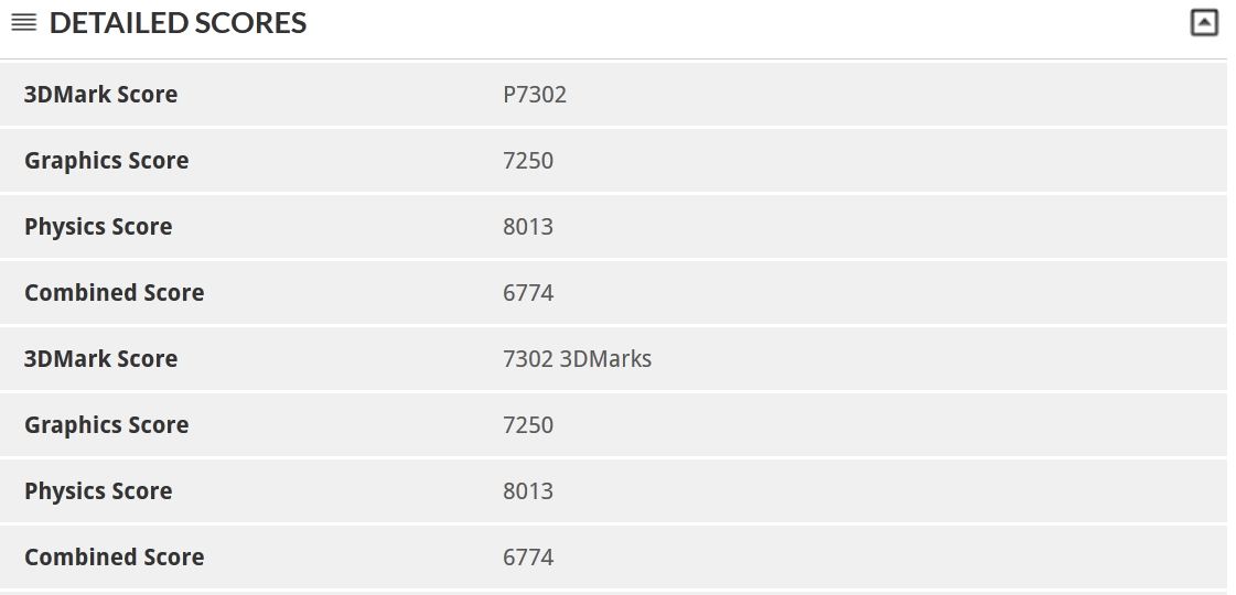

  10. Yo I'm back, I've been running the Helios with my 15" rMBP for about 3 months now. My setup is as follows: - 15" rMBP - HD 7950 - OWC Helios - PCIe riser cable - TX650 PSU - Pendrive with Setup 1.20 Beta 3 (thanks to @Tech Inferno Fan for this) I'm running Win 7 x64. My 3DMark11 results: If you compare results with other HD 7950's you'll see that I'm getting about 73% of expected performance. Not bad right? Anyway this is a rundown on how I've set everything up. See if my way works for you! 1. Install Win 7 x64 (I prefer it to Win 8) and install the drivers for the 650m. Shutdown. 2. Cut up and connect your riser card to the PSU in this config: 3. Connect the GPU to the riser card and the riser card to the Helios. 4. Connect the Helios to the rMBP and put it on but keep the PSU powered down. 5. Plug in your pendrive with Setup 1.20 and boot into Setup 1.20. Put the PSU on when Setup 1.20 tells you it hasn't detected any eGPU and press refresh. 6. Select a couple options (I forget which, but I'll tell you if you decide to go through with this). 7. Chainload to Win 7. 8. Install drivers for HD 7950. 9. Reboot. 10. Enjoy! Pro's: 1. Works with both AMD and Nvidia; I've tested a 560ti, HD7950 and an HD 5850. 2. Sound and everything just works in Win 7. 3. I'll help you every step of the way. Con's: 1. You'll have to boot using Setup 1.20 each time you want to use your eGPU (can be automated). 2. You need a riser cable.
  11. Where did you find out about that? If its the Thunderbolt Echo Express with Win 7 then follow these instructions: First you have to isolate the GPU from the power rails on the Echo Express. Buy a PCIe riser and cut these wires: Connect the wires to your PSU as shown (sorry I just threw that together in paint), you'll have to setup your PSU so you can put it on without a computer. Now keep the Echo connected from when you boot and select win7. Press F8 before the boot splash screen to go to the boot options menu in Win7 and switch on the GPU by putting the PSU on. After about 3 seconds boot into Windows. Your GPU should now be detected.
