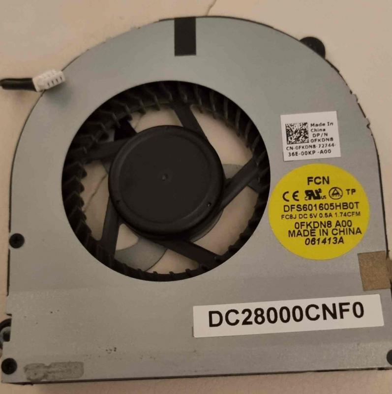

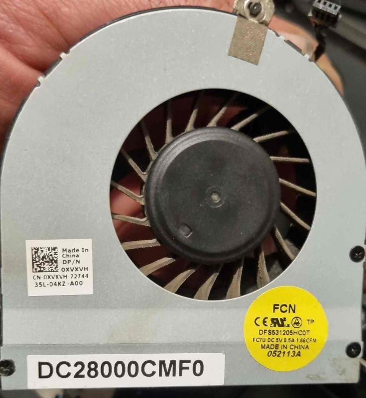

Many of these 17 R1's came with a very low CFM fan though. They were 1.74CFM, or something like that. You are best to find the M14x/M17x fan that is 11.4CFM (roughly).

I'm looking for a better fan, this one just doesn't quite suit me
Can you show me what kind of fans are you talking about? they are like that?

Here is a decent CFM fan, you'll just want to check with the seller that you will get the same one. This looks to be 10.55CFM
https://www.ebay.com/itm/133984615631

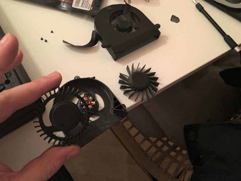

thanks to my friend, I found the part number and at home in Poland I bought it for $ 5 :) and all the cooling from 15r2 for 10$
https://ibb.co/LSphKQ2
https://ibb.co/Tbwy6kF
I would like to move the propellers only like a friend from the forum
