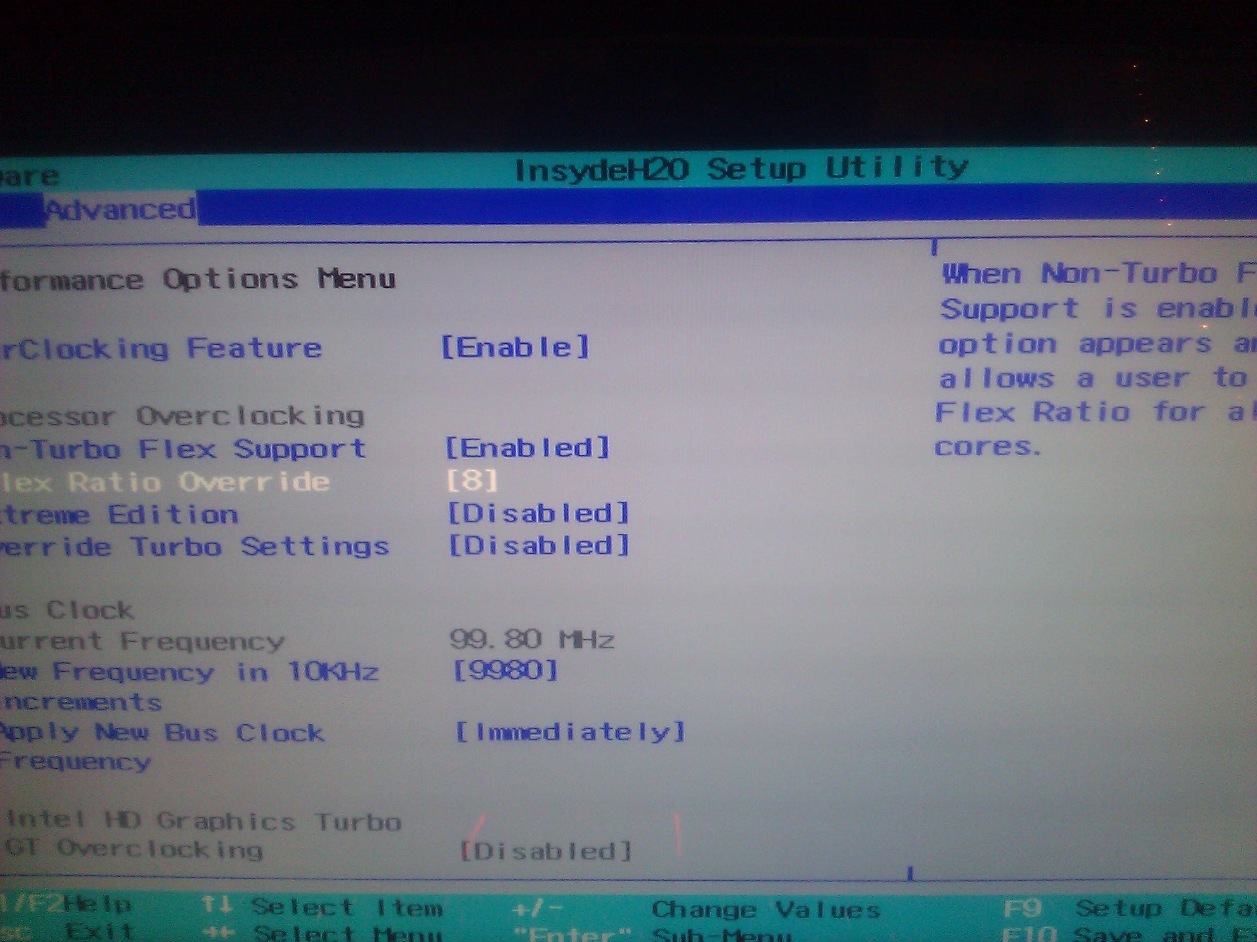

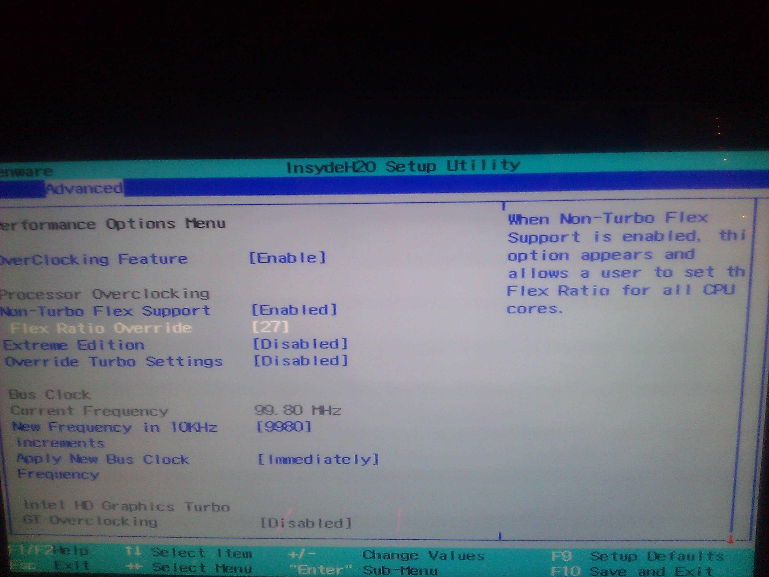

With "non turbo flex support" enabled a new option appears below.
"non turbo flex ratio" appears
For 2920xm you will see 25 by default and it can be set from 25 to 8 which is equivalent to 2920xm's fastest multi of 25x which is its highest non turbo speed of 2.5ghz (sometimes referred to as base speed) and 8 is lowest because thats the lowest multi Sandybridge supports... Ie 800mhz idle
2960xm sees 27 by default and again can be set from 8-27 :)
So examply i enable non turbo flex support and adjust non turbo flex ratio to 12... I enter windows what i will see is when cpu is running at turbo it will be (on a 2960xm) 28x or higher and when turbo is not engaged the max speed ill see set like that is 1.2ghz or 12x multiplier because thats what i had set non flex turbo ratio to in this example. So cpu in non turbo situations then would bounce from 800mhz to 1200mhz and when more process power is needed would jump to turbo ranges.

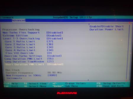

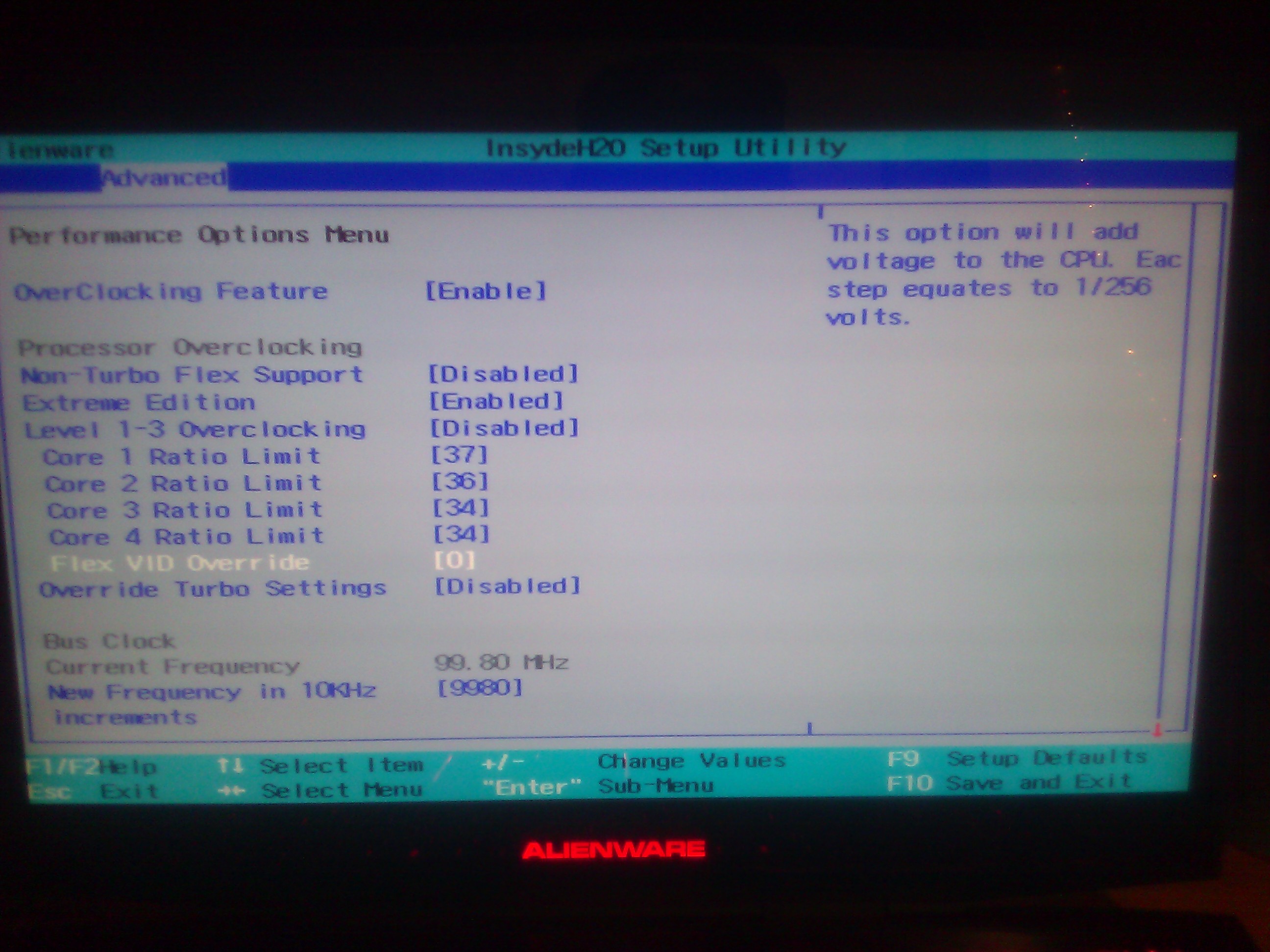

What I am saying is you have to have that option enabled so that you can adjust the Flex VID Override setting in the BIOS. This is what it looks like on the M17x R3:
@usmc362 If you want to run at 4.5Ghz you have to have the VID on 6. For 4.6Ghz you have to have it on 12. It could be different for your CPU. It hasn't caused any havoc for me...

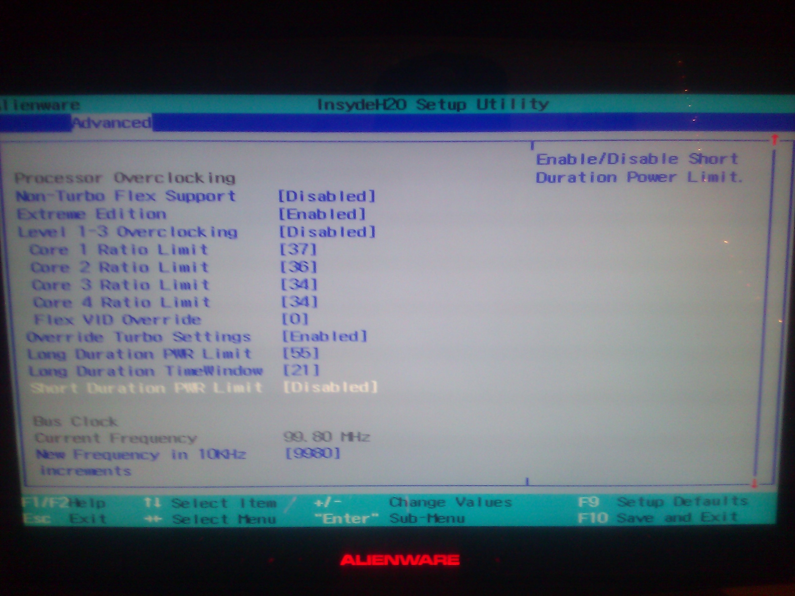

I didn't say that was my photo. I leave the first 3 options enabled and the VID is set at 0 for normal use. It is 6 for benchmarks. I have XMP PnP HyperX so I do not touch the memory settings (first option is disabled, second is default).
Furthermore, we have already told you countless times what we have and what we use AND how to set it (I PMed you)... but for the last time;

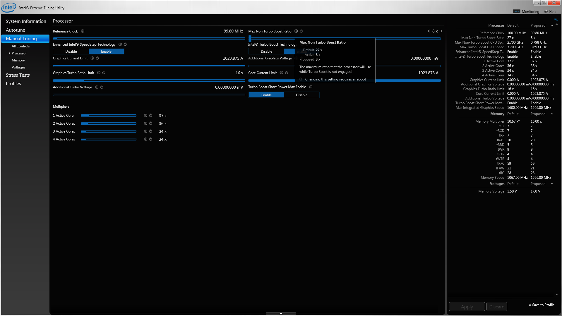

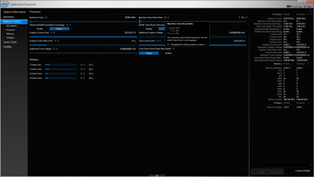

45 across all cores on Intel XTU, restart and in the BIOS set:
6 Flex
1000 PriPlane
100.1 BCLK
99W Long Boost, Short boost disabled, 56 seconds
Now, stop asking silly questions, set the above settings, set fans to max and BENCH. DO NOT post without results. Don't even DARE.

Ok, some photos like I promised earlier;
How to adjust PriPlane:
7th tab -> Advanced CPU Control -> Scroll all the way down.
How to adjust Flex:
5th tab -> Performance Options Menu -> Top

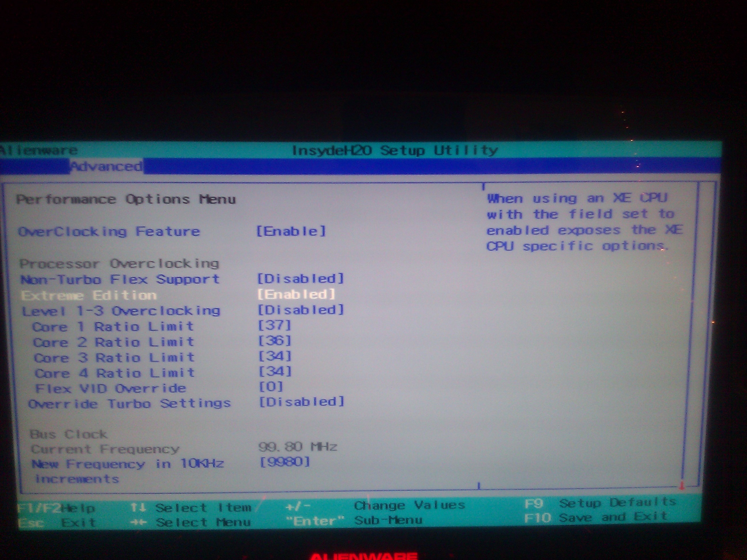

I found out why there's been discrepancies between our advice its differences in our unlocked bioses. The functions are the same but apparently according to that screen shot you dont have function of "non turbo flex support". Your enabling it and its not doing anything because there is actually a new value that shows below that once enabled... So it seems it doesnt work on M17x XM as it should my guess is because there wasnt official XM support anyway... You do not need that option enabled you do need "overclocking feature" enabled and also "Extreme Edition".
Be an hour or so but ill post pics to show you. Basically once you see its true function i think youll agree its an unused feature for your m17x R3's and should be disabled.... And is not required to adjust "turbo flex" which is completely different and seperate. I ask you look at the evidence i post in a bit and i think you can agree. Ill try to get the actual bios description of that feature in a pic so its not my words but the bios themselves and Unclewebb can probably agree Throttle Stop's creator as he enabled a feature that displays the current "non turbo ratio (multiplier)" enabled via "non turbo support"

Yes, I understand perfectly well what you mean. But you're not understanding me!
The "Non-Turbo Flex Support" has to be enabled to see the "Extreme Edition" option. The "Extreme Edition" option has to be enabled to see the "Flex VID Override" option. I should have stated this clearer, it's my fault.
The only thing "Non-Turbo Flex Support" does when enabled is show is the extra options. If it is not enabled, the "Flex VID Override" option will not be visible. It's true function probably does not even work because the rest of the options are missing. It could actually be an error in the unlocked bios itself, e.g. the text entry could be something different. That's the only explanation that I can think of.
I was only referring to the "Non-Turbo Flex Support" option as a way of actually getting to the "Flex VID Override" option, not to its true function.

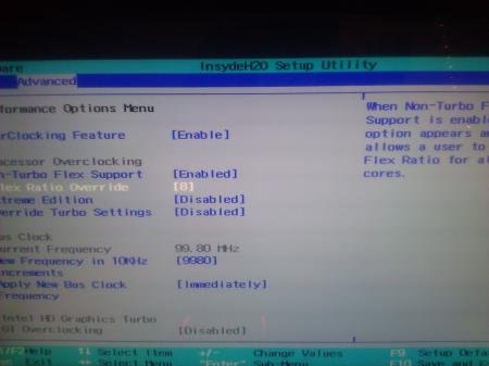

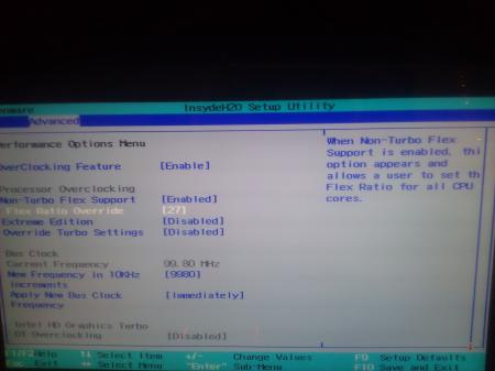

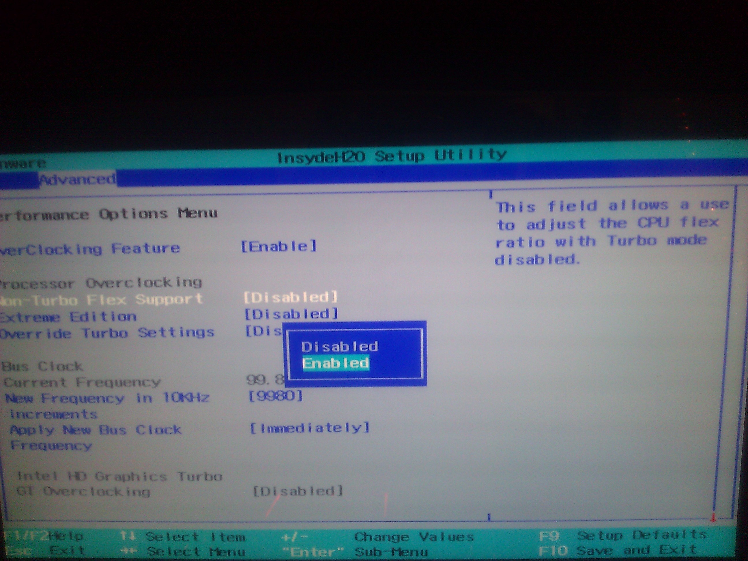

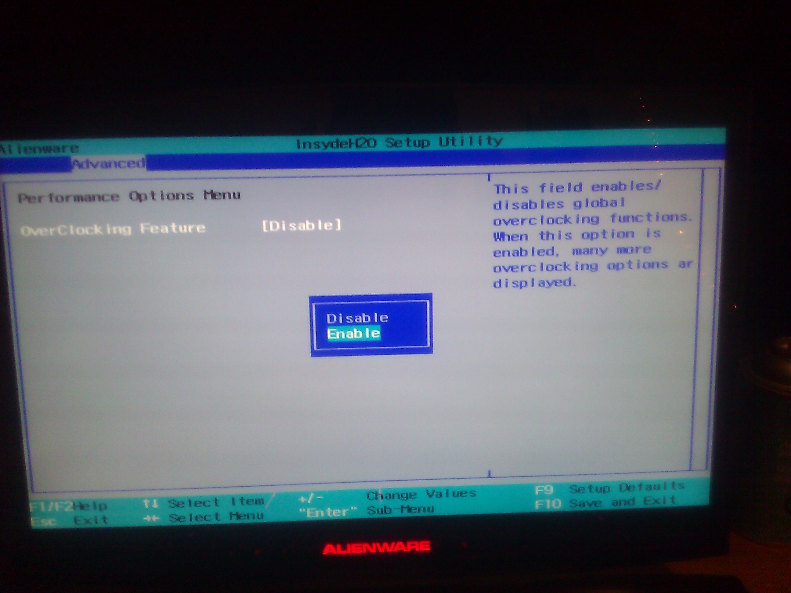

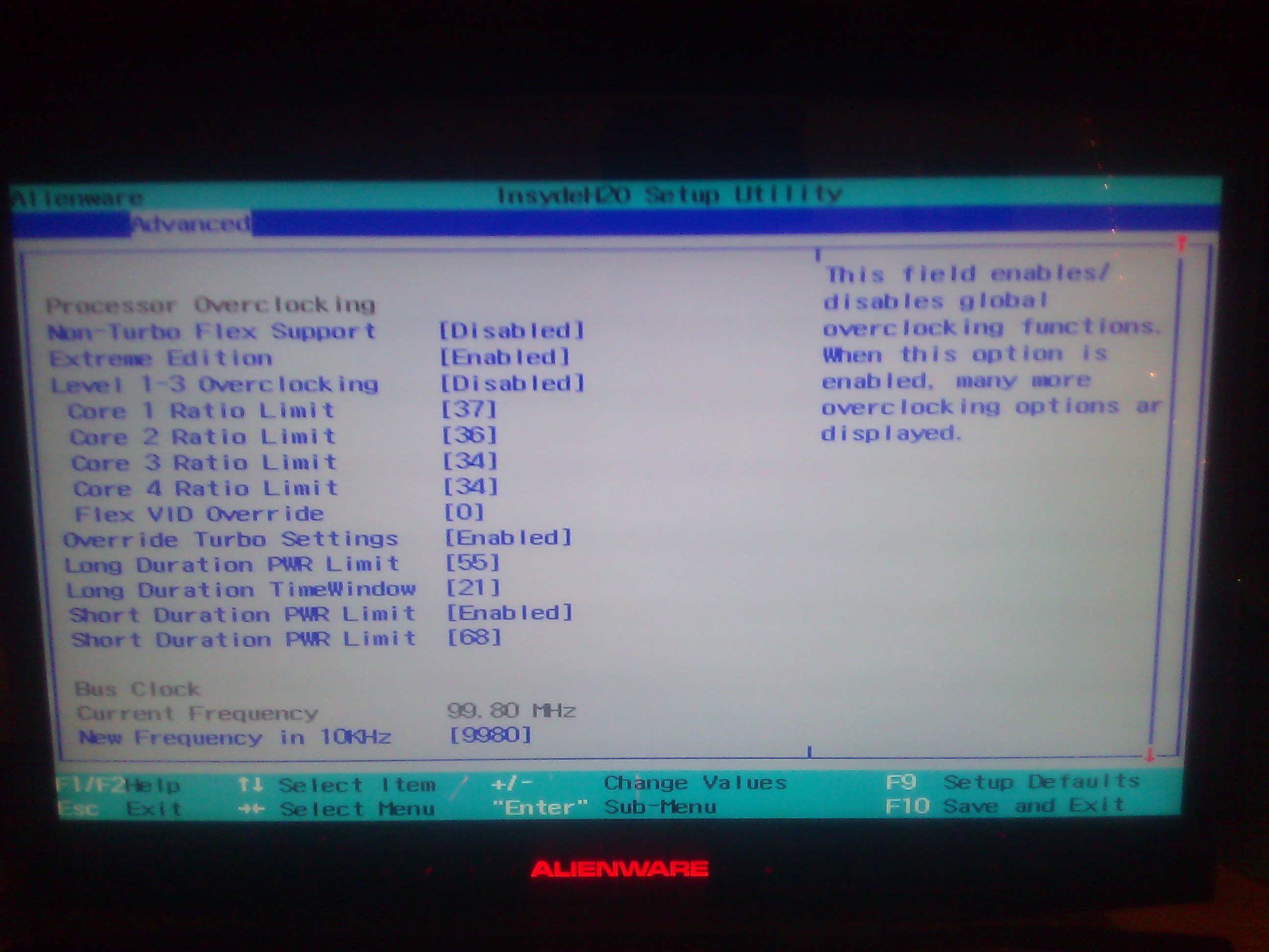

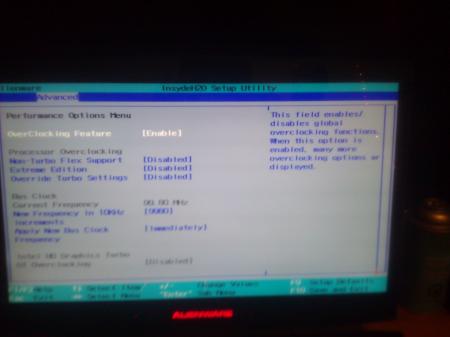

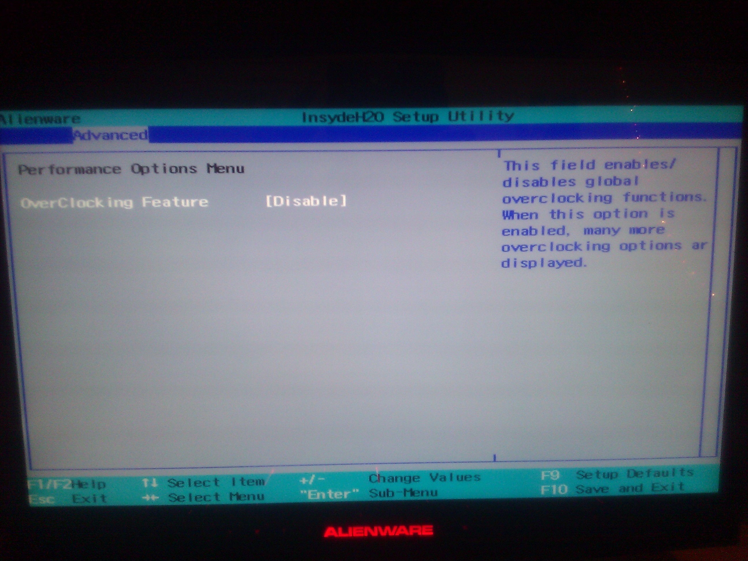

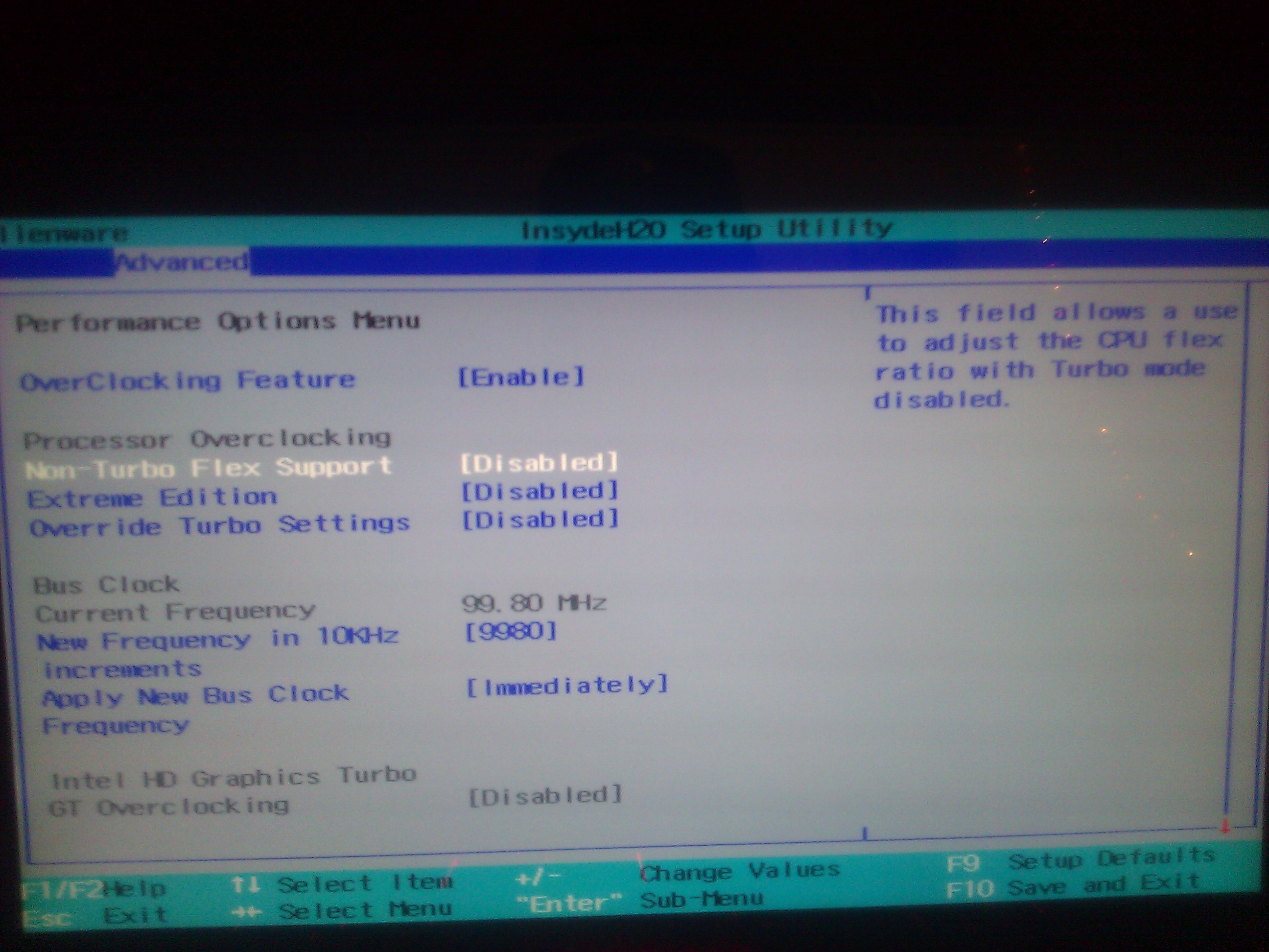

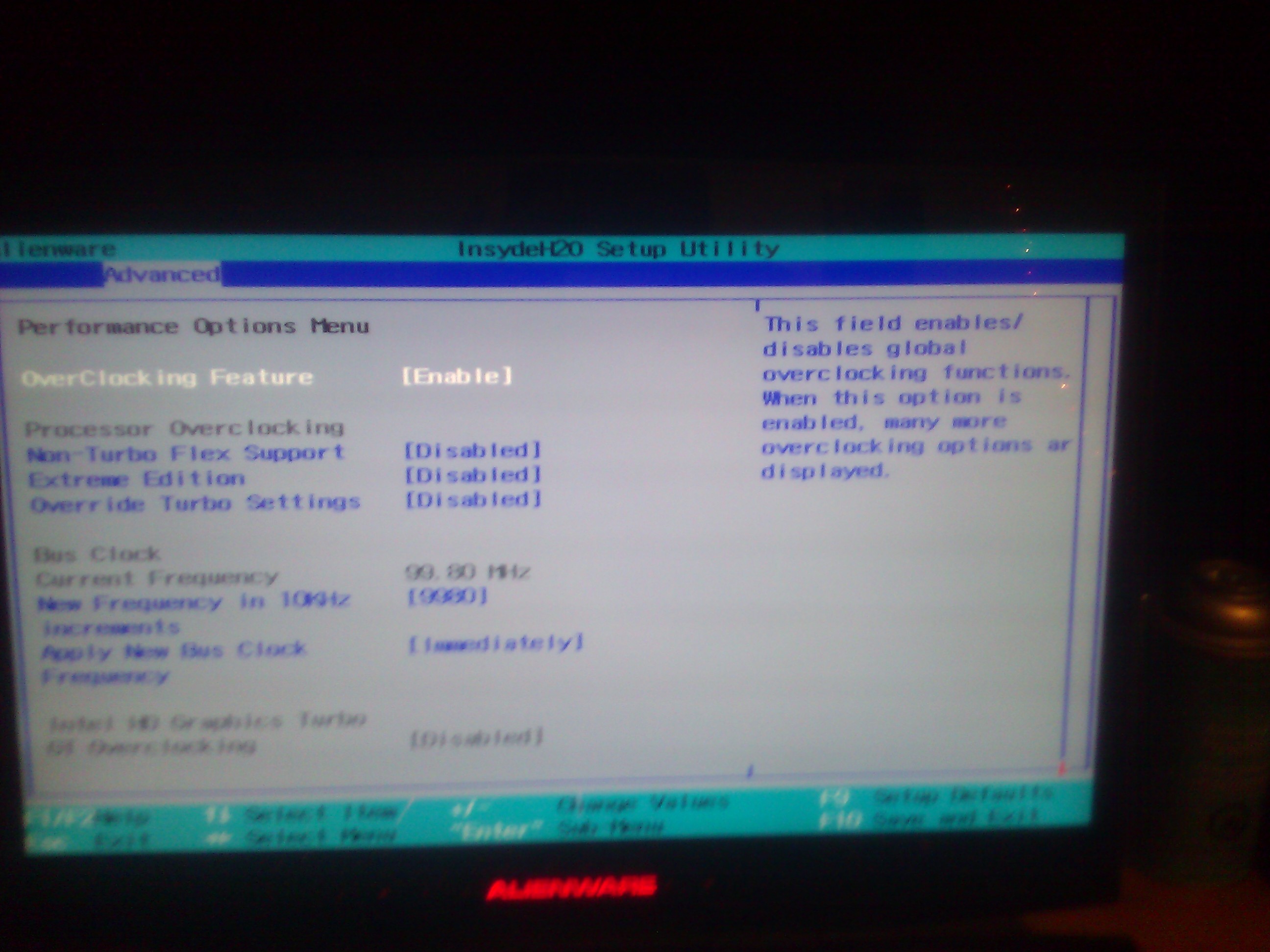

now i understand and I guess i suspected that could have been the case being on m17x... i figured since you had been using it so long that it was probably what you meant. Cool beans. So since i did take those pics anyway here they are and as you said you realize the true function is not even being used but just using it to show turbo voltage adjustment (turbo flex)... so i fully get what you are saying and we are on same page cool :)
i took them in order so you could see effects and descriptions etc and how M18x menus end up working as you know we seem to not need to enable that for same effect just the Overclocking Support and Extreme Edition....
Thanks GeoCake for clarifying this it sucks you cant see this function working on those systems... it seems it could be good for using lower speeds when turbo is unecessary. I think the pics capture how it all works on M18x... i got the bios descriptions shown of "non turbo flex support" and "non turbo flex ratio". I just wasnt getting that you required one to activate the other Geocake... I suspected so but wasnt sure. So now we got M18x and M17x R3 "non turbo support" defined, described and covered even pictured... pretty cool :)

Yes, after enabling it the first time, and after enabling extreme edition... it can then be disabled, But then the Extreme edition option disappears and the Flex VID Override remains. After that, just set the multipliers on Intel XTU again... Having "non turbo flex support" enabled or disabled makes no difference whatsoever cause we are missing the rest!
