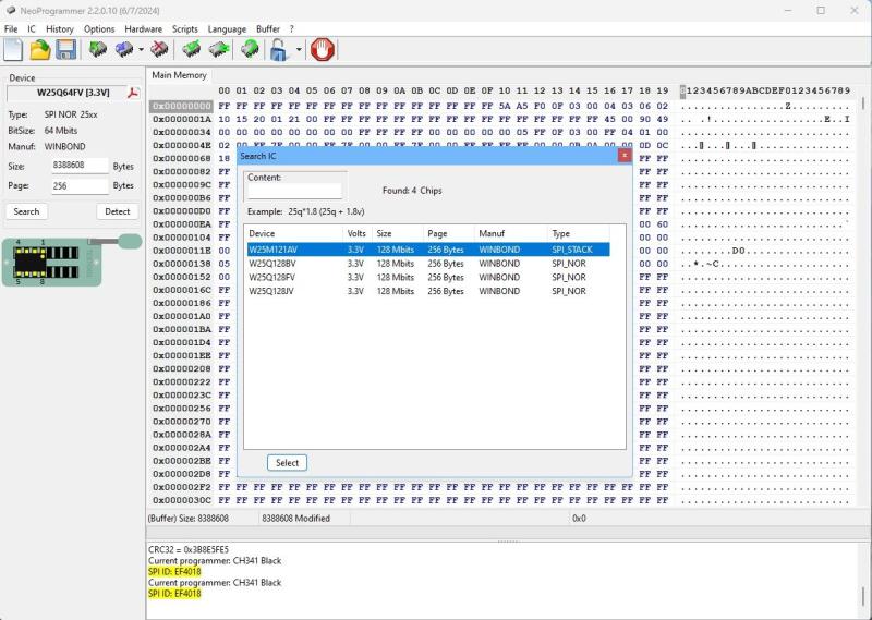

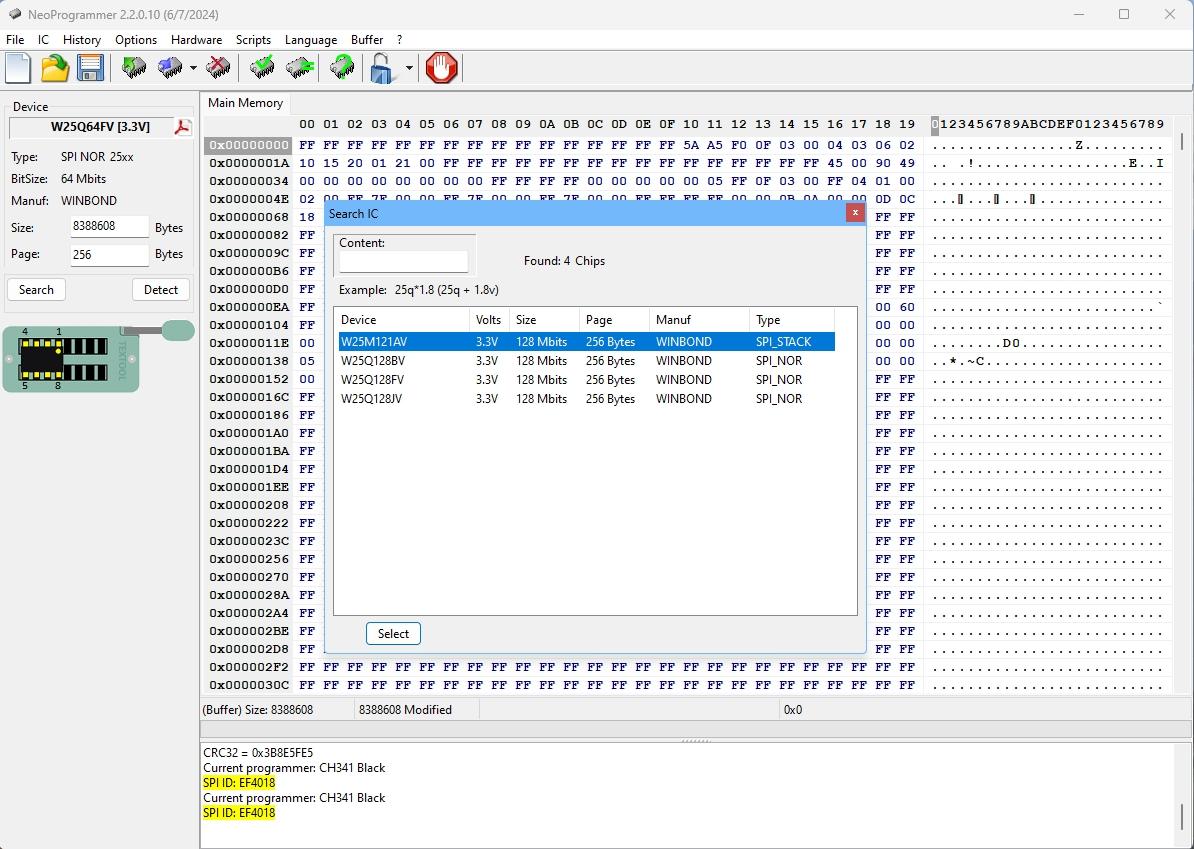

Hi Klem,
Hopefully you're still doing these and thank you in advance, you have been doing them a long time, very patient!
In this post you noted that the "X240 has only one 16MB chip", a 25Q128FVSSIQ recognised as 25Q128BV or 25Q128FV.
When I started NeoProgrammer 2.2.0.10 it showed a W25Q64FV but I do not think that was correct, probably just some sort of startup default?  It is also 8MB vs the 16MB of each of the other four.
However when I click 'Detect' it shows "4 Chips" namely (WINBOND) W25M121AV, W25Q128BV, W25Q128FV and W25Q128JV. I have dumped all 4 bins but for future reference (and to help others who might come along), which one(s) is(are) actually the correct one(s) here? Comparing the 4# 16MB files in Guiffy shows no differences.
Please can you help to remove the Lenovo X240 bios whitelist and get the advanced menu for my X240.
https://www.mediafire.com/file/joebnjvwxqu49vm/Lenovo_X240_BIOS_Dumps_KM.zip/file

  • Bios Modder
This is normal because (WINBOND) W25M121AV, W25Q128BV, W25Q128FV and W25Q128JV are almost the same chips. You can choose any one in the software, but I recommend choosing W25Q128BV or W25Q128FV.
