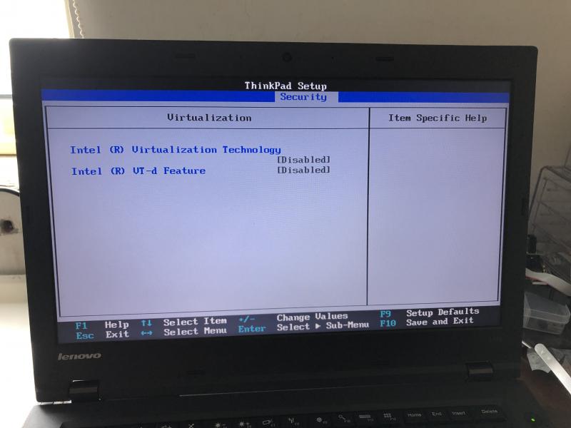

11 hours ago, Klem said:
Hi!
Ok. You want to unlock Wi-Fi whitelist or hidden advanced settings? Or both options?
I want both options
Remove whitelist WiFi card and show advanced settings.
And enable VT options
Thank you very much!
