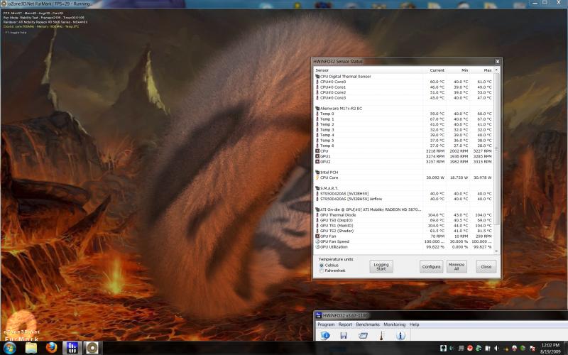

xxmolagbalxx Posted March 13, 2012 Author Share Posted March 13, 2012 i pulled it out today and ran furmark and seems it is running now, before i ran the program and it didnt even spin when it got hotter and my heat rose quite significantly. today its just working so i guess its fine.. for now... though I am having higher temps then I think I should be. The high point after a little bit of furmark for my gpu was, GPU thermal diode 111C, GPU TS0 74C, GPU TS1 111C, GPU TS2 87C. it was a first time for pulling apart this laptop and first time doing a paste job on the gpu and putting pads on the ram. From the numbers shown think I should repaste and or re pad also? Link to comment Share on other sites More sharing options...
mw86 Posted March 13, 2012 Share Posted March 13, 2012 90c is what you should say to be your max... 111c is too much. After replacing pads with a thick paste i used ICD max temp in games for hours on end on an overclock was 76c on my last cards 6970m so id say give a nice repaste and replace... furmark isnt safe but max should be mid 80's if your all set... 5870m are very nice Link to comment Share on other sites More sharing options...
xxmolagbalxx Posted March 13, 2012 Author Share Posted March 13, 2012 (edited) well forgot to say that I was using hwinfo while i was running furmark. That is where I got my numbers. Okay guess ill wait to repaste until I receive my other heatsink for my second card. Stupid dell sent me two heatsinks for the left card sigh. Well looking at those numbers you think that id have to do the ram also? or just the gpu? oh also added a pic in case you wanted to see. Edited March 13, 2012 by xxmolagbalxx Link to comment Share on other sites More sharing options...
mw86 Posted March 13, 2012 Share Posted March 13, 2012 well forgot to say that I was using hwinfo while i was running furmark. That is where I got my numbers. Okay guess ill wait to repaste until I receive my other heatsink for my second card. Stupid dell sent me two heatsinks for the left card sigh. Well looking at those numbers you think that id have to do the ram also? or just the gpu?oh also added a pic in case you wanted to see.yes 91c and 104c are too high even on furmark. So yes i recomend replace the paste on the core of the card as well as smaller than a pea size dab on each vram module. No further tweaks should be needed and you should see dramatic temp differences. For prevention of errors and various fixes that were made to HWiNFO i highly recomend you use the latest version as you are about 50 revisions back. 3.93 i think is latest full version. HWiNFO, HWiNFO32 & HWiNFO64 - Hardware Information and Analysis Toolshttp://forum.techinferno.com/general-notebook-discussions/913-ic-diamond-24-survey-results.htmlcheck this thread for repaste pics lot of AMD cards there temps you see in this thread should closer to what you should be seeing if its all repasted good. Link to comment Share on other sites More sharing options...
xxmolagbalxx Posted March 14, 2012 Author Share Posted March 14, 2012 yes 91c and 104c are too high even on furmark. So yes i recomend replace the paste on the core of the card as well as smaller than a pea size dab on each vram module. No further tweaks should be needed and you should see dramatic temp differences. For prevention of errors and various fixes that were made to HWiNFO i highly recomend you use the latest version as you are about 50 revisions back. 3.93 i think is latest full version. HWiNFO, HWiNFO32 & HWiNFO64 - Hardware Information and Analysis Toolshttp://forum.techinferno.com/general-notebook-discussions/913-ic-diamond-24-survey-results.htmlcheck this thread for repaste pics lot of AMD cards there temps you see in this thread should closer to what you should be seeing if its all repasted good.thanks, I was scared to put too much paste on the gpu and just did a little bit bigger than a pea size... guess that was not enough maybe... and also im using i think 1mm pads on the ram... I have some mx4 and some other paste I bought.. think I should just put paste on the ram instead? Link to comment Share on other sites More sharing options...
mw86 Posted March 14, 2012 Share Posted March 14, 2012 thanks, I was scared to put too much paste on the gpu and just did a little bit bigger than a pea size... guess that was not enough maybe... and also im using i think 1mm pads on the ram... I have some mx4 and some other paste I bought.. think I should just put paste on the ram instead? yeah thats what i was getting at and you can see pictures of it in that thread. mx4 is fine... but you can reference the pictures i linked to that thread in above post so you see what is a good amount. I would use StamatisX's picture to judge how much to use but yes to clarify do not use the video memory pads at all and use paste on each of those black squares and the core of the gpu. When putting it on you can see how big the pads are and how they are squeezed... put enough paste on each sqaure that will not go over edges but will cover as much of them as possible and fully contact the heatsink. Save the pads though Link to comment Share on other sites More sharing options...
