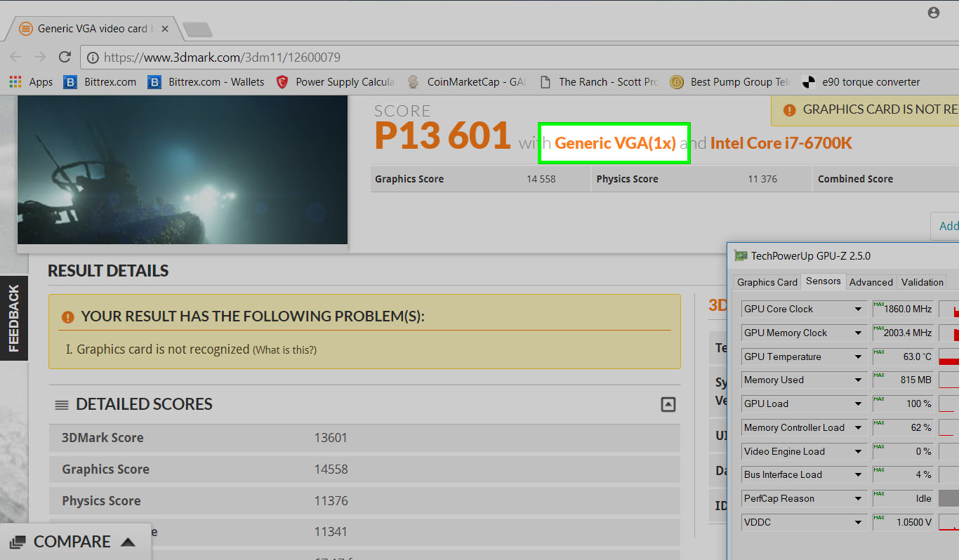

It worked, you're awesome! I would love to know exactly what you did to get it to work right.
My 3DMk11 graphic score went up 13% from:
12335 with an overclocked 980m to
14558 with this stock 1060.
The only thing that's weird is that 3DMark11 shows "generic VGA" for the graphics card. As long as it's working properly, it's not a huge deal, but it's a curiosity. Any idea why it's like this?
Thank you again!
Thank you again!
Duuno exactly why this happens, happened to me aswell when I had the alienware mx17 r4 and up from the gtx 675 to gtx 780
And btw, for future driver updates, for the moded inf to work, you need to replace 7504 (from your hardware id) with 7502 (or any other string that points out to a 1060), but you need to replace all values of 7504 (or whatever) with 7502 (not only the bottom bit), the command in notebook beeing CTRL+H (replace all values with)
Hopped it hellped.
